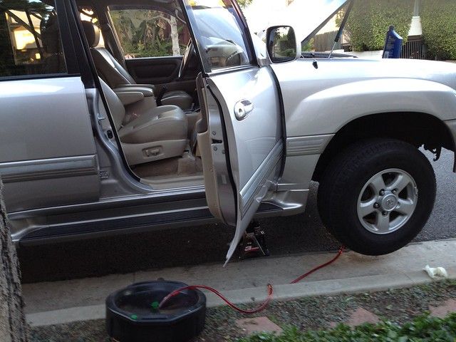

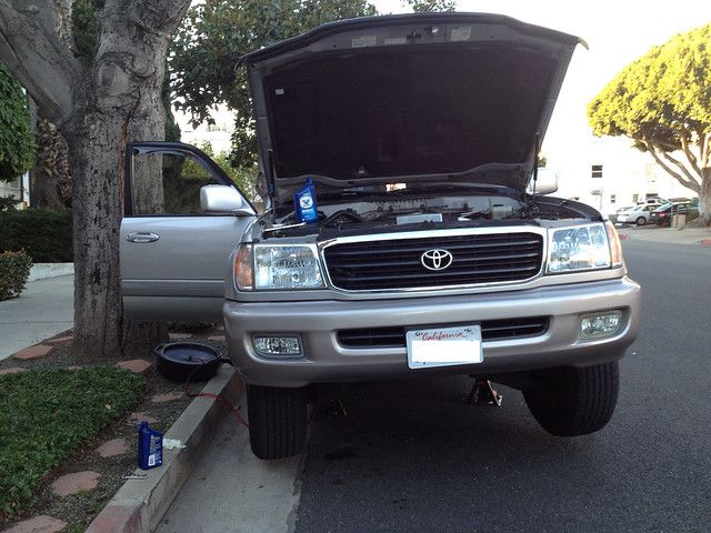

Some pictures of the solo procedure
I did this by myself last night. Thanks for the awesome write up.
I ran the tube through the fender and outside the front passenger door.
A full turn from right to left lock uses about half of the reservoir. So I'd turn it from lock to lock then fill up the reservoir to the top. Never letting it get below half full. I seemed to avoid getting any air in the lines this way.
By standing on the driver-side running-board/slider you can turn the wheel while watching the reservoir through the space between the hood and bottom of the windshield while also keeping an eye on the color of the fluid going into the bucket.

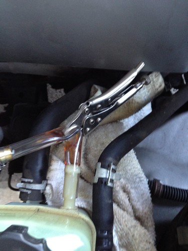

Before removing the stopped hose, I squeezed most of the fluid out by pinching with my fingers, then kinked the hose and clamped it with a mini vise grip wrench. I lost very little fluid while quickly switching the lines. A towel caught and spills.

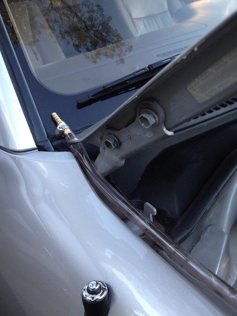

I stuck the drain hose between the hood and windshield while reattaching the lines.
I ended up using about 2.5qts of Valvoline DEX VI Synthetic ATF. I could have used less.I think I drained almost a qt of fresh fluid.
FYI -- Total work less than $35 dollars for ATF, tubes and misc items. A big savings over what they would charge you at the dealership or your favorite shop... times 2. I did my wife's toyota as well.
1 3/4 quarts for the truck and 1 1/4 quarts for the car.
