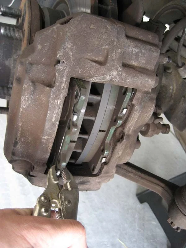

"Looking at the rotor, the brake caliper is on the left. Get a good light and examine the back side (left) of the brake caliper. You will see a thin little bent wire clip holding 2 guide pins (each pin approximately 4" long) that hold the pads in. Do not pull the clip out of the guide pins just yet. Using a pair of needle nose pliers, I pushed the middle of the bent clip out of the hole at the center rear of the caliper gently. You will have to flex the clip a little-just be gentle! Once it is out of the hole, use the needle nose plyers to pull the clip out of each pin, again gently (I had read that if this breaks, you need to replace before driving - after looking at it, I would think that 2 cotter pins (1 per guide pin) would also work."
This is fairly simple, the little wire clip is easy to recognize. Be careful, its a fragile part!

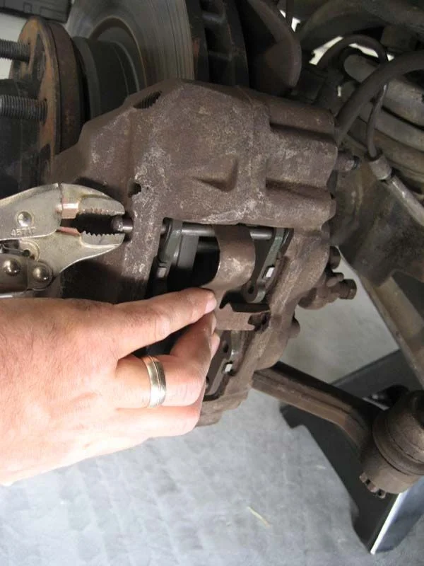

Next picture is of removing the first holding pin, while keeping the spring clip from shooting across the garage:
"With the bent wire clip out and placed in a safe place, put your hand on the flat metal spring clip that holds onto both the upper and lower guide pin shafts. Slowly pull the upper guide pin out and catch the flat metal spring clip (it will pop out if you do not have your hand on it."

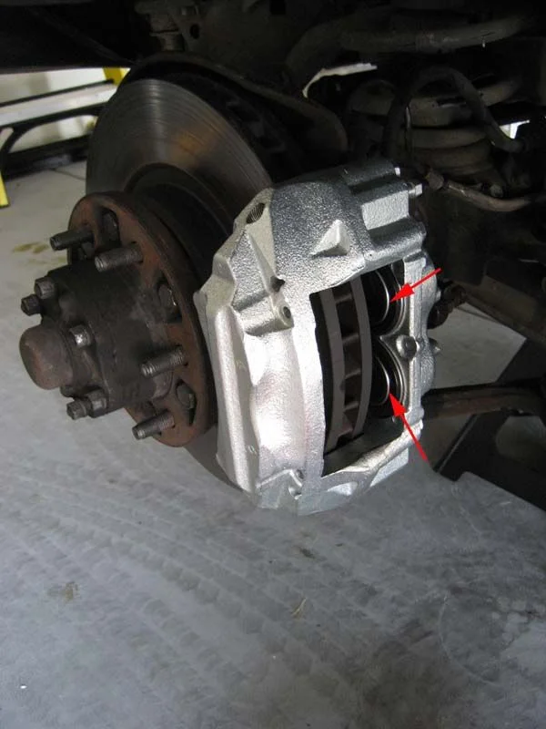

I had to pry the pistons in the new caliper back out a bit, using the wooden handle of a hammer to get the new brake pads and shims back in. After that, replace the pins and spring in the reverse order that they were removed. Attached Images
I bled the brakes using a 'pump the brake pedal assistant'. I took the opportunity to replace all my fluid as well at this time. It was about the color and consistency of maple syrup, and pumped it until it came clean and clear. Because I replaced the calipers, and they had a lot of air in them, my bleeding sequence was a little different, but worked well. I bled the front two lines first, until very little air was coming through the lines, then moved to the typical sequence, and finished by bleeding the fronts again, and the LSPV last to clear all the air.
Fired the truck up and everything's working great, no spongy brakes, and no dragging pistons on the rotors.

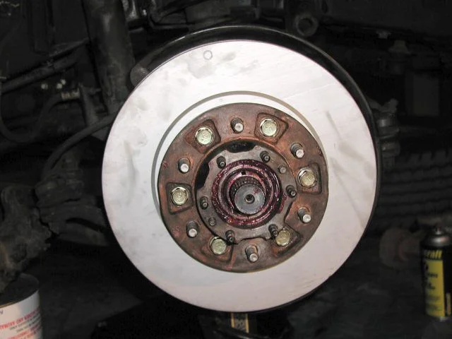

Remove the Hub and Rotor Disk together as one piece with the outer bearing. OK to leave outer bearing in Hub for now. It will all be cleaned up later.

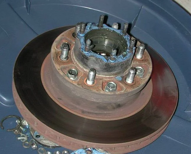

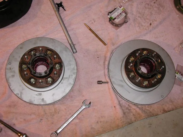

Brake Job Another thing you can do here is swap your rotors. All you have to do is remove the bolts that connect the hub to the rotor and install the hub on a new rotor.
You can see why its a great time to do it now since doing it later would require you to repeat what you had done up to the knuckle. Your inner and outer bearings would need to be cleaned and repacked again.
Note: The blue stuff in the picture is probably some kind of sealant that has not been cleaned off. This was not on my hub, but I picture of someone else's. I did not use it in my axle job.

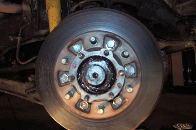

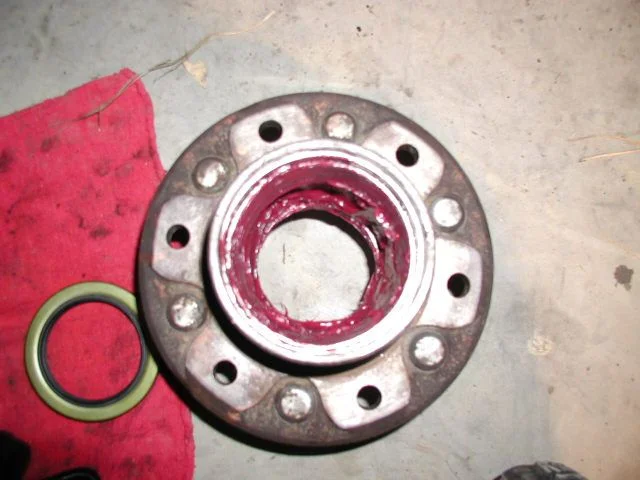

Pack the inside of the axle hub with grease (Should have been cleaned prior to this).
Pack the inner and outer bearings with Grease per the instructions used for the Trunnion bearings. These bearings are typically re-used unless after they are clean you notice damage.
Install the inner bearing into the hub and then install a new oil seal onto the hub. Coat the oil seal with grease Attached Images
Place the axle hub with the disc side towards the spindle (Hub side out)
Install the outer bearing
Intsall the thrust washer

Set pre-load. This step has a difference of opinion. Some folks use a fish scale and some do it by feel. Most agree that the way they do it is the right one.
I'll repeat the steps from the FSM. Install the adjusting nut.
You adjust the pre-load using the 54mm socket. Torque the adjusting nut to 43 ft-lbs
turn the hub right two or three times. Torque the adjusting nut to 43 ft-lbs again.
Loosen the nut until the hub can be turned by hand.
Torque nut to 48 in lbf (Yes thats inch pounds) and make sure there is no play.
Using a spring tension gage (Fish scale) measure the pre-load. s/b between 6.4-12.6lbf. Adjust as required. You do this by hooking one end of the scale to the hub and seeing how much it takes to move the hub.
Here are two other methods:
Robbies
"This was how we did big trucks in the 80's. We would do the bearing preload rotate then tighten again, rotate. Then we would back off to the point that the nut was loose. Hand tighten, then check to see how much the washer would move back and forth with a screw driver. IF no movement then loosen, if real easy movement not tight enough. this was a trail and error until you got good at it. when it was just right you put the lock washer on then the lock nut and tighten to what ever the man spec's were. then check to see if you could move the washer with some force, not two handed force but some more force then it took with just the jam nut. Sound hazzy but works real well. I have been using this method for over 20 years (yea I am old, but big enough to wipp most) and it is what I use in the shop today. It takes a feel and it may take a couple of times doing it but will serve well. The way you would tell if it is too loose(before driving the truck) is with the tire and wheel on, with every thing on the ground and you shake the tire(from the top) back and forth and you have looseness, the bearing preload is not enough, do it over or you will have problems.
Junk you may want to put this in the FAQ section. later robbie"
Gumby/Landtank:
Quote:
Originally Posted by Gumby
I think Landtank's method was the same as mine.
Tighten the inner nut to 45 lbs/ft, rotate, back off and repeat, then just until you feel resistance. Install the lock washer, then torque the outer nut to 45 lbs/ft.
I use a torque wrench for Cruisers because you need to use the socket. It's easy to get carried away with a 1/2 ratchet.
With cars and trailers I use a pair of channel locks. I've found that I get better feel for the pre-load torque.
The rear bearings do require the special alien landing ship tool.
These are discussed in this thread
Install Lock washer and lock nut. Torque the lock nut to 47 ft-lbs.
Check that the axle hub turns smoothly and the bearing has no play.
FSM says to check pre-load again with scale.
Secure the lock nut by bending one of the lock washer teeth inward and the other tooth outward.
Place a new gasket in position over the axle hub.
Apply molygrese to the inner flange splines.
Install the flange on the axle hub.
Install the 6 cone washers, plate washers and nuts.
Torque the nuts to 26 ft-lbs
Install a bolt in the axle shaft and pull it out to hold it while you install the snap ring.
Using a snap ring expander, install a new snap ring and remove the bolt.
After the drive flange is fitted and the cone washer nuts are torqued, the circlip can be fitted. Screw an 8 x 1.25 pitch bolt into the axle to pull it out and expose the circlip groove.
Install the drive plate (part cap goes into)
Quote:
Originally Posted by IdahoDoug
Go super easy on tightening the tiny nuts on the drive plate and cone washers. The torque is in INCH pounds, so easy to break right off.
Quote:
Originally Posted by sleeoffroad
when installing new drive plates (Most re-use old ones), paint them before installing them. They are not coated when new.
Coat the inside of the cap with MP grease and tap it on using a rubber hammer or a drift and hammer.
Re-install the brake caliper. Torque bolts to 90 lb-ft
during the re-installation of the caliper is a great time to replace the brake pads if required. 100 series pads last longer on the front
Re-install the tires. Make sure you torque the rims to the following specs depending on which rim you have:
Steel wheel and alloy wheel with conical seat lug nuts, 109 lb-ft.
Late alloy wheel with shank nuts, 76 lb-ft. Attached Images
