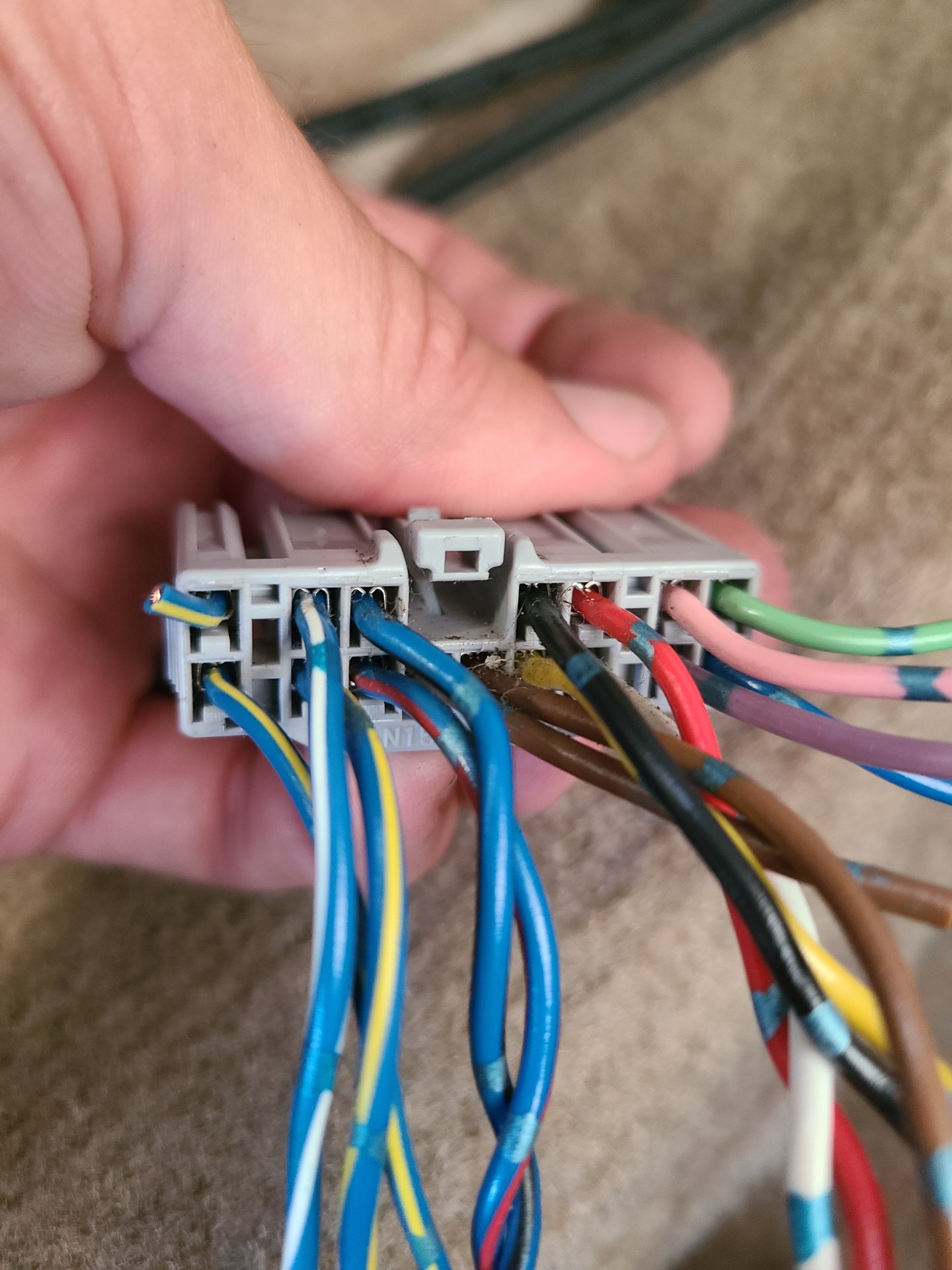

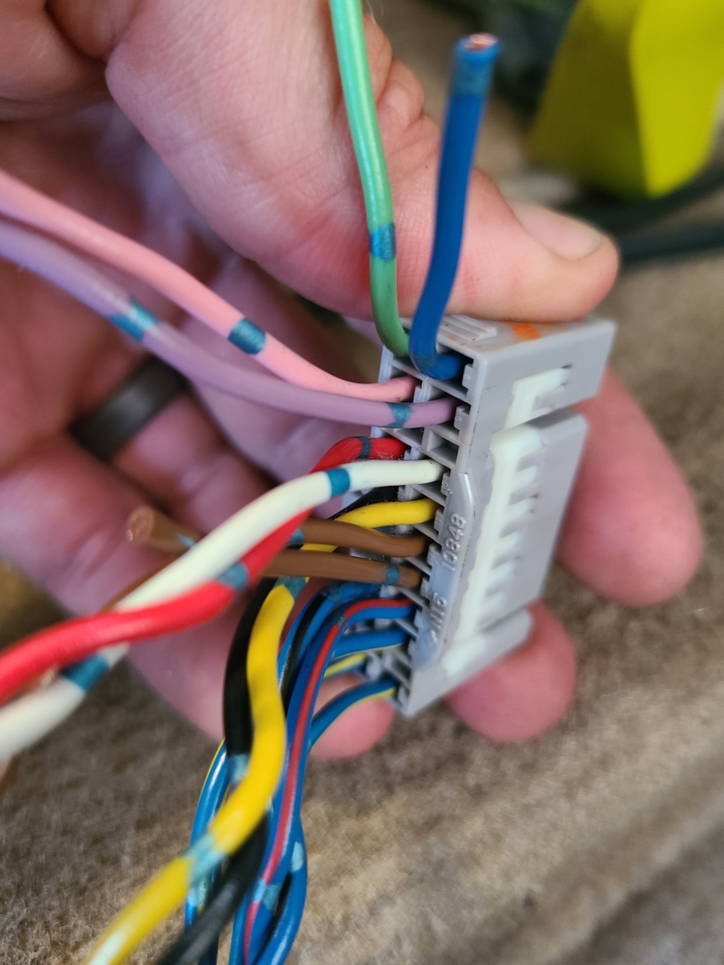

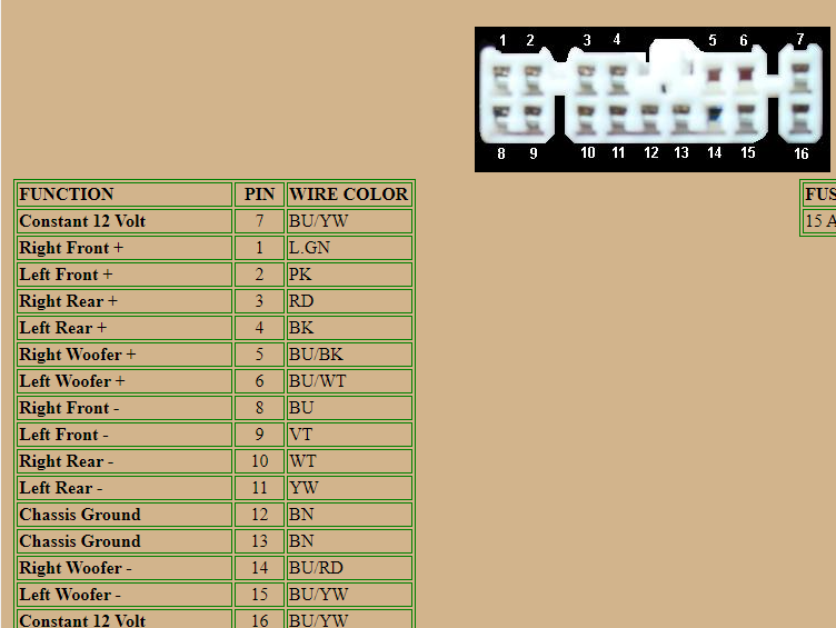

Here's the link to the forum with instructions on how to convert from factory amp to aftermarket:
Pics of factory amp wiring below should save you some heartaches (I believe these are applicable to '98 - '00? only):
*Be careful - the rear driver side door speaker wires change color somewhere in the car, so just make sure you ready the diagram below correctly.

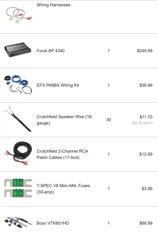

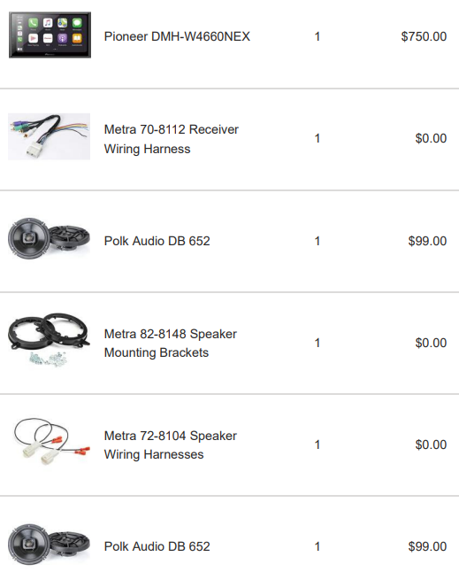

and here's my crutchfield cart:

I'm super happy with how everything turned out. Sounds great. I did call Crutchfield with a couple questions twice and they were great and super helpful. This was my first time doing "wiring" this in-depth. Would do it myself again.
