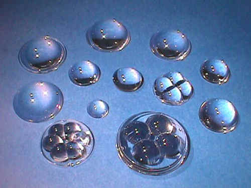

I wonder if some glued-on plastic lenses could divert some of the light off to the sides? My neighbor gave me a box of six of these KC lights.
