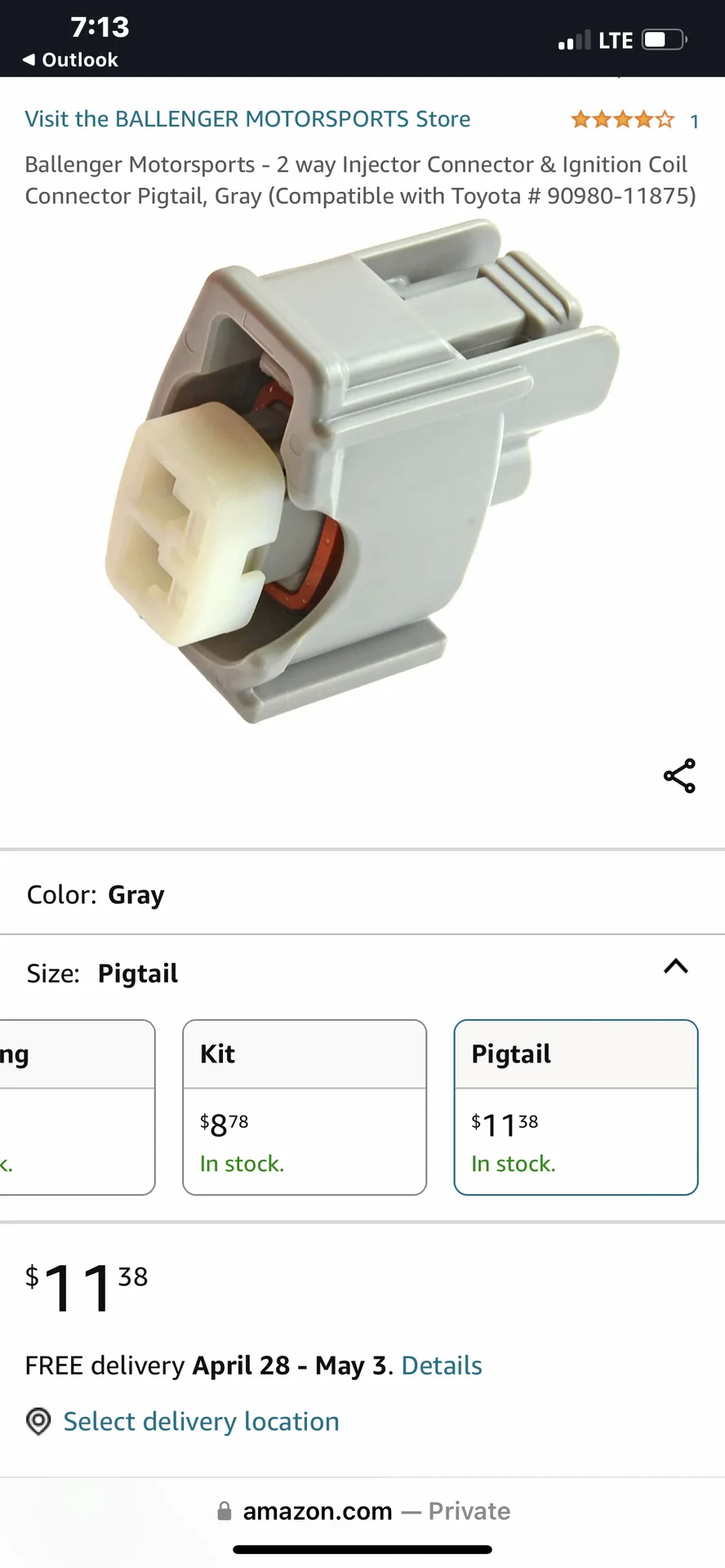

I know I've read on here somewhere about procuring new plastic plugs for the injectors as the old ones are brittle and usually break. Can someone assist me with part numbers or source for these plugs?

Great to do, don't recall part numbers.
These are Japanese connectors OEM quality for a great price. They are pigtails that you splice in. Toyota says not to solder and to crimp them. I have put these on 3 different rigs and had zero issues. I tried buying OEM connectors and using a pin tool to depin them and replace without splicing and the juice is not worth the squeeze.
I suggest replacing the section of wire at the injector plug as well since most I've seen have cracked / brittle wire insulation at the connector. And give yourself a little extra length.
