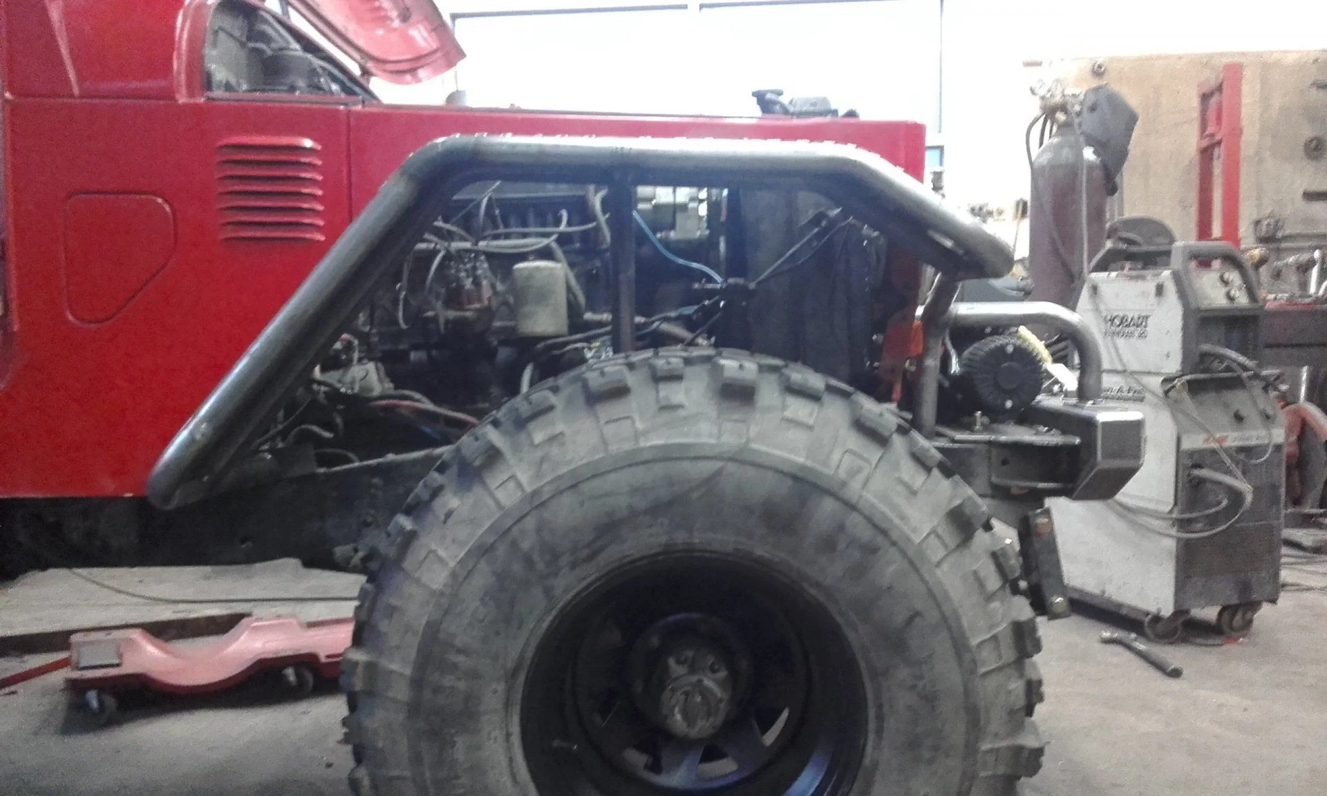

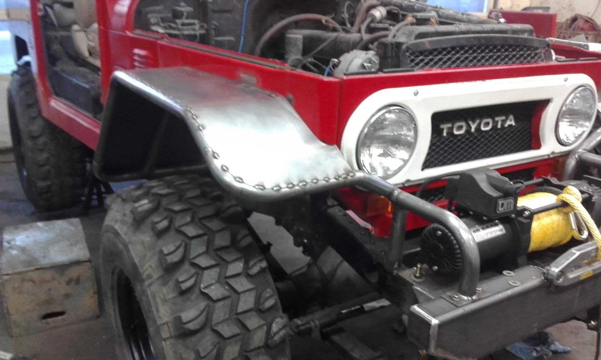

You bend up all that tube?
Not a kit? Looks really good! You're making me want to spend money!
Yes sir. All done in house. .090" wall 1 1/2" HREW mounted to four points on the frame, with 18ga sheet on top. Not cheap though as it takes a couple days to make them, not including paint. But if you have money burning a hole in your pocket, bring your truck up, I'd be happy to make you a pair ;)

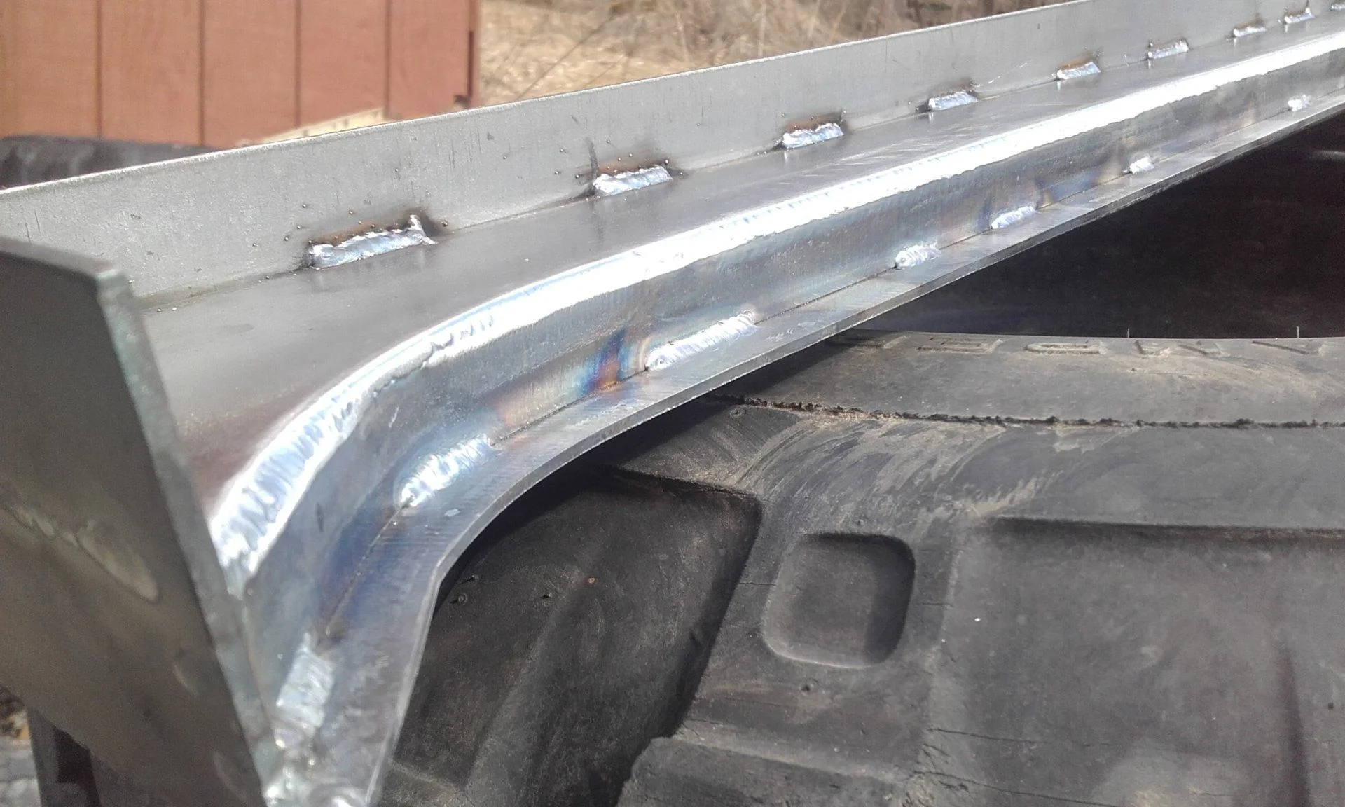

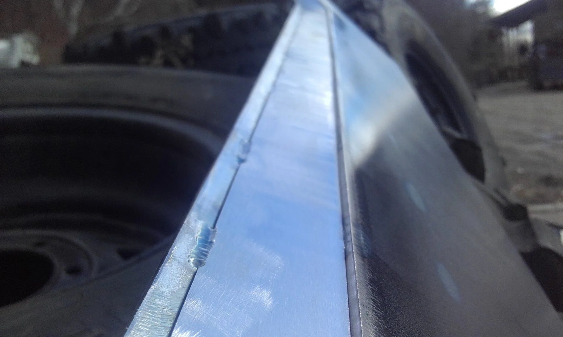

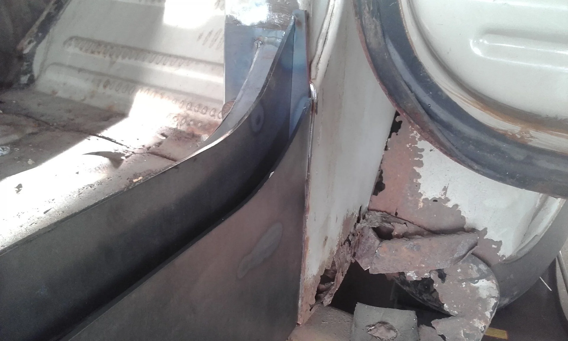

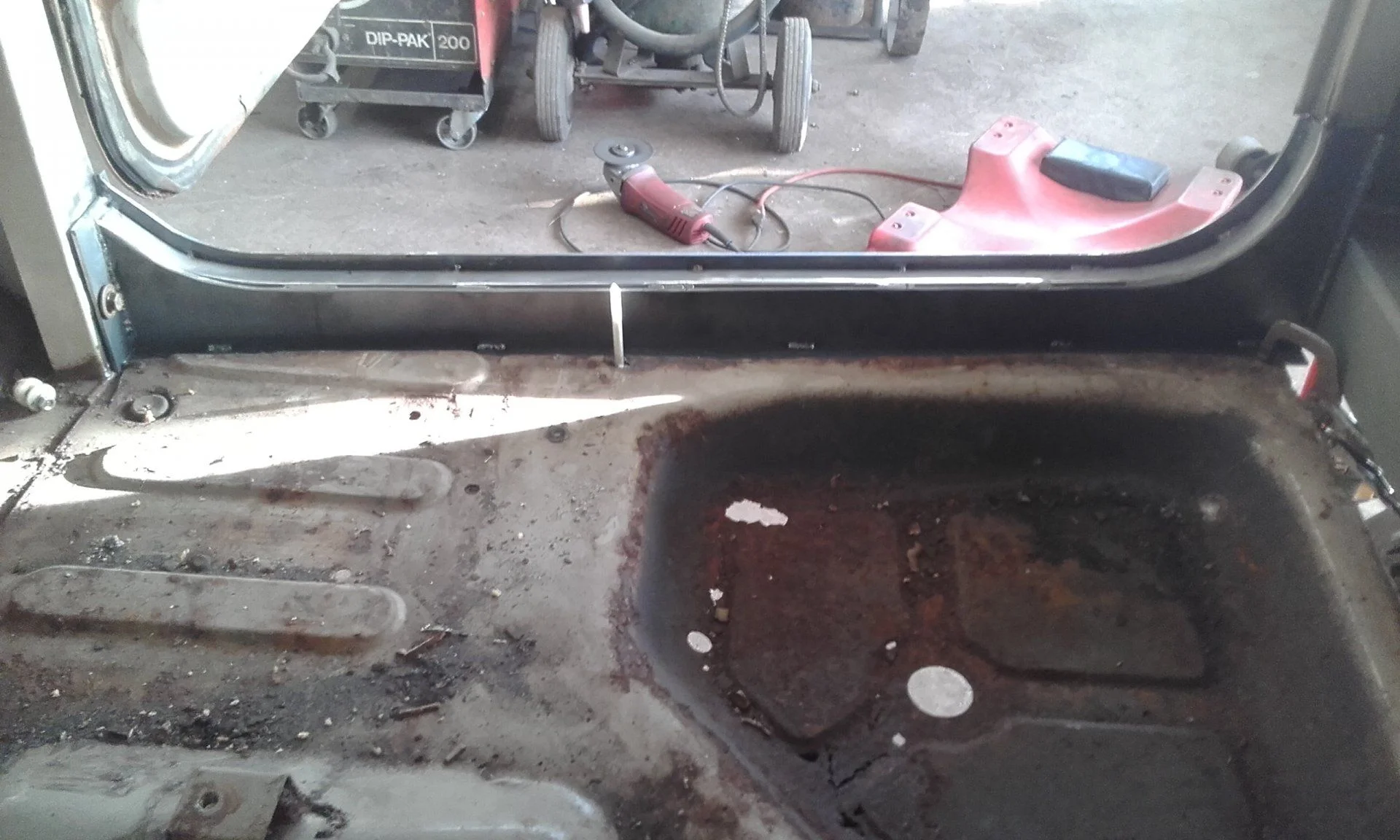

Finally had some time to assemble a set of the laser cut panels and check fitment on our test truck. While they're not perfect yet, they are dialed in quite nicely.

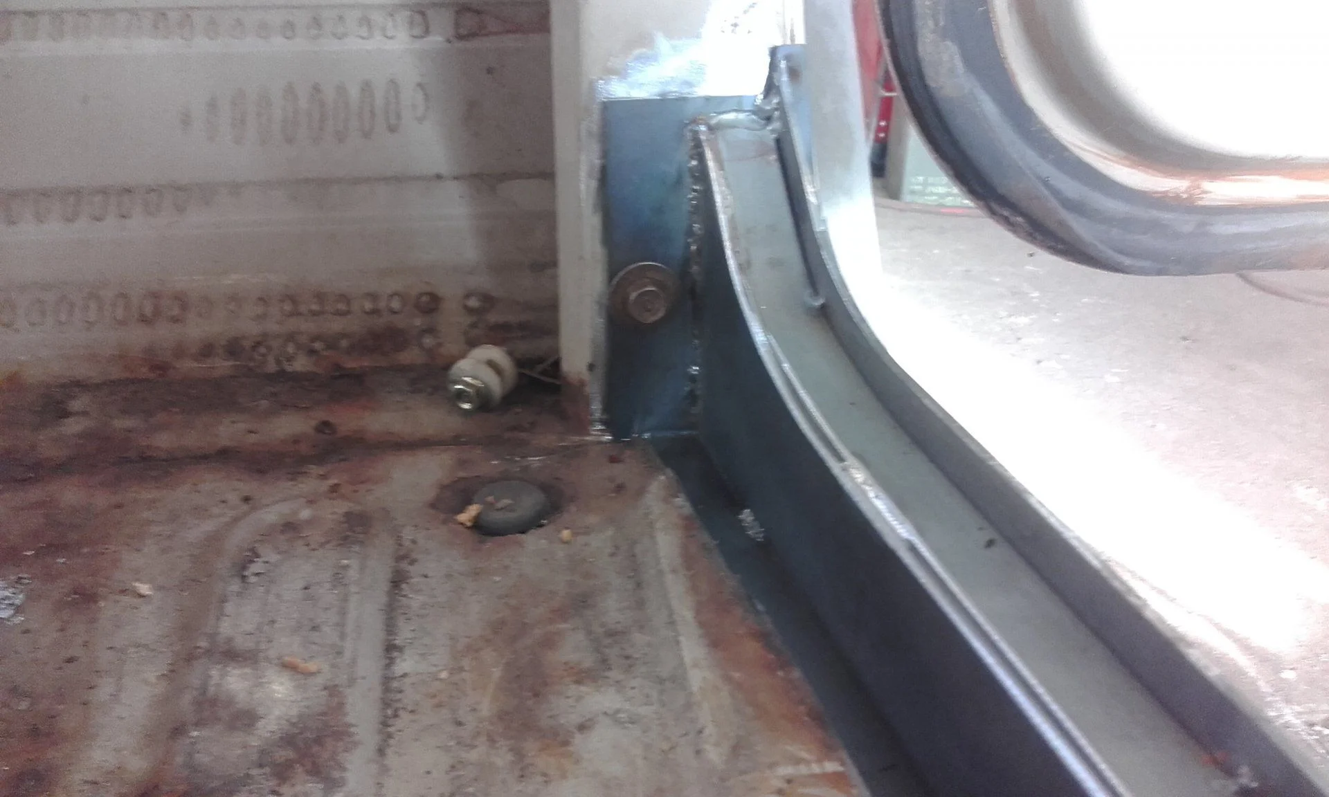

The floor elevation is spot on
Match up to the A pillar and bolt alignment is good

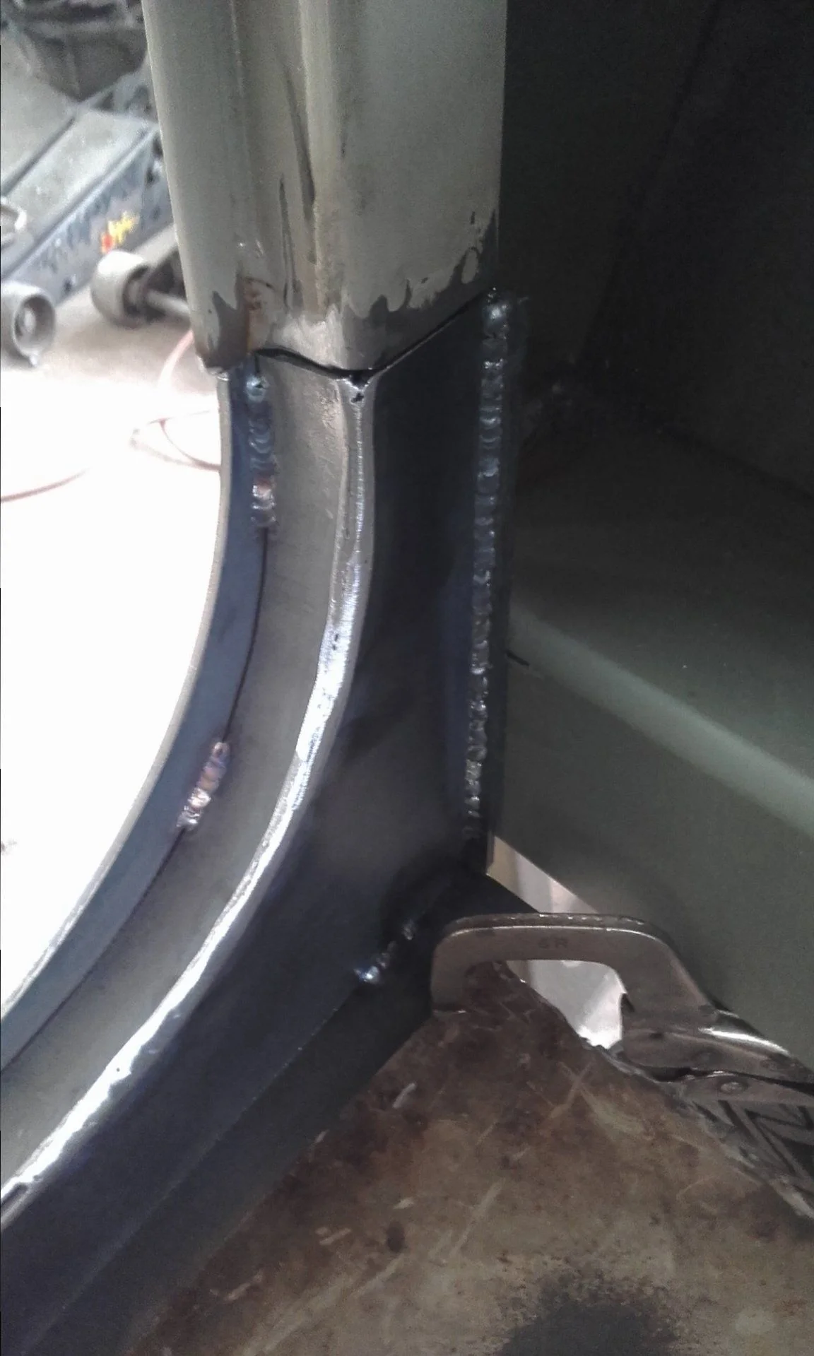

Thickness problems I've had with the B pillar are cured

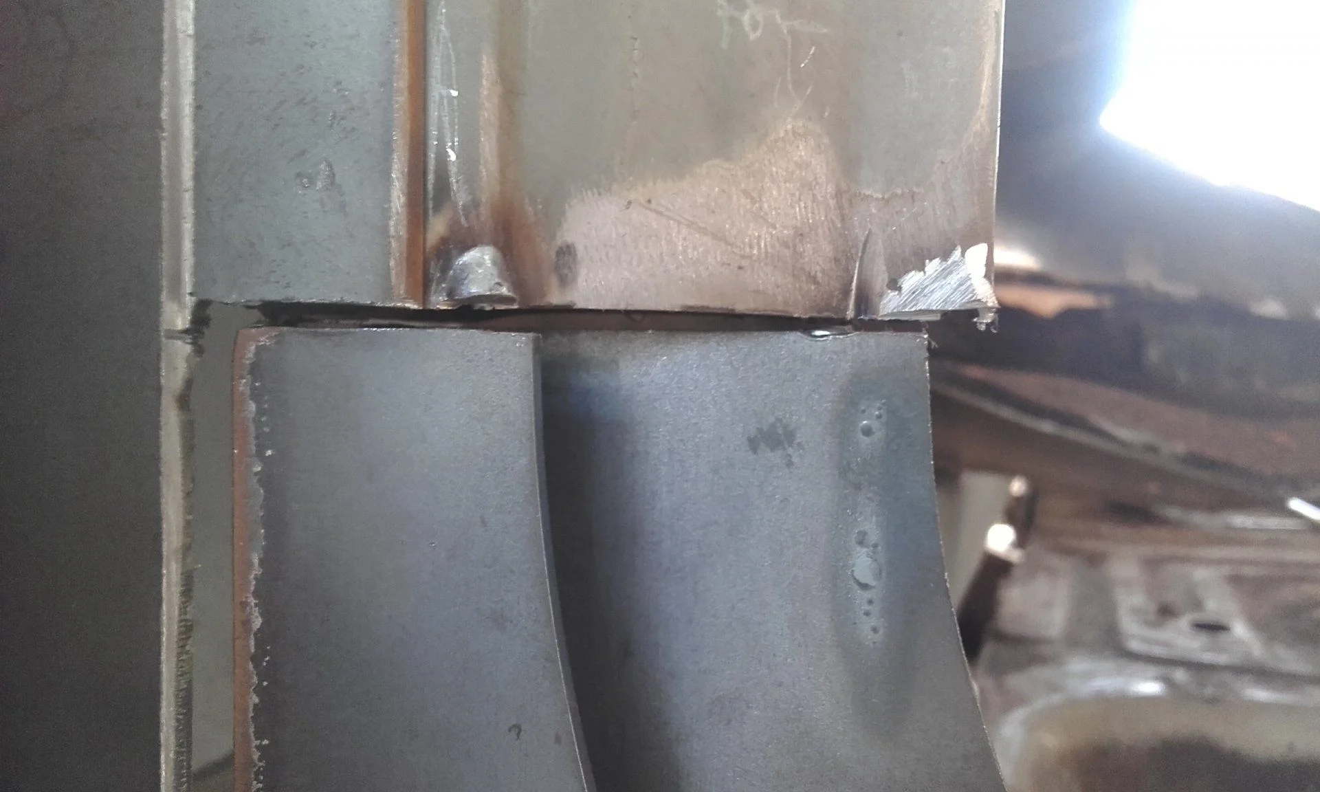

Though I do need to adjust where the outer and center panel meet the factory lines. Overall length is great
And the outer face is nice and flush
The last piece to sus out is the gasket mating surface. This is proving to be a challenge, cutting a flat piece that needs to be formed into a compound curve, and is pushing the limits of my CAD program. I've had a piece digitally scanned and will be sending it out for cutting today, hopefully they can use it and get something back to me soon. So close now!
I'd still really like to get someone to install a set of these, and get some feedback if possible. I don't care if it's a stocker or a wheeling rig, or what kind of shape it's in. If a wheeling rig I'll send a stripped version of them with a full skirt that can be cut to match yours. A free set of stronger than stock rockers people, help a brother out!

Finally have the door gasket piece figured out, quick grind and it drops right in. Assembly is getting faster and my TIG welding is improving. Just waiting to get another truck in so I can check overall fitment.
Any thoughts, feedback or criticism welcome.

Any more photos of them installed? Are all seams fully welded?
Hello arnott1t,
All seams are NOT fully welded, heat distortion would be too great to overcome. All rockers have three vertical pieces stitch welded inside and out creating a double box design, from 11ga steel, that makes them far stronger than original. I will post some pics when I get to the shop.
