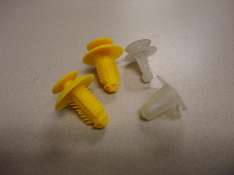

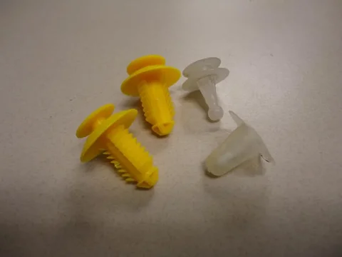

I had my tailgate carpet rebound onto a sheet of thick plastic patterned off the tattered OEM board. The plastic had come off a roll and had a definate curve that I couldn't remove even with heat. It kept the Christmas tree fasteners from engaging and the carpet wouldn't stay on the tailgate. The parts guy at my local Toyota is awesome and he went digging into their stock of new style panel fasteneners. The yellow trees he came back with are longer and stick like crazy. I highly recommend them for the tailgate. They might be TOO good for the side panels as I don't think you could get them loose without damaging the more delicate panels. I don't have a part number but here is a picture. They are one piece instead of the original two piece.

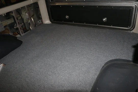

I was thinking of going this route as well...but now I'm leaning towards buying marine grade carpet and using my original as a template. I'm thinking for the trans hump might have to do two separate pieces and sew together (access to an industrial machine)

Did you decide to go this route? If so I'd like to see some pics please.
I'll get some shots this weekend...I just got around starting it...have the cargo area done....middle shouldn't be tough...the front still has me nervous. The closed cell foam / MLV part of the process has gone well.
Here's the shot I have of the back section...only part I have done. Probably not going to keep it the original wheel well covers..but just put it on for now. (driver's side one was just dropped on top of the carpet...makes the cut look off, but it came out exceptionally well. The material is very easy to cut. Its a HUGE upgrade over the old stock carpet (would be even when the OEM carpet was brand new). hopefully the passenger sections will go as well.
