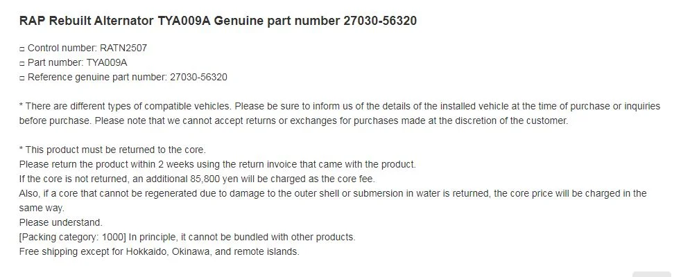

Not cheap but here is an option based off the p/n you provided (using a proxy service like buyee or something like that). Not sure how the core part can be handled.....that part I never done.
RAPリビルトオルタネーター TYA009A 純正品番27030-56320 :RATN2507:NET 部品館 - 通販 - Yahoo!ショッピング - https://store.shopping.yahoo.co.jp/net-buhinkan/ratn2507.html
I did some searching in Japan with the JAUCE service but nothing came up.
Proxy people in Japan say the Core Return prevents me from using that as an option.
The fine print says if the core is not returned they will add $800 to the cost. Too expensive for a rebuild.

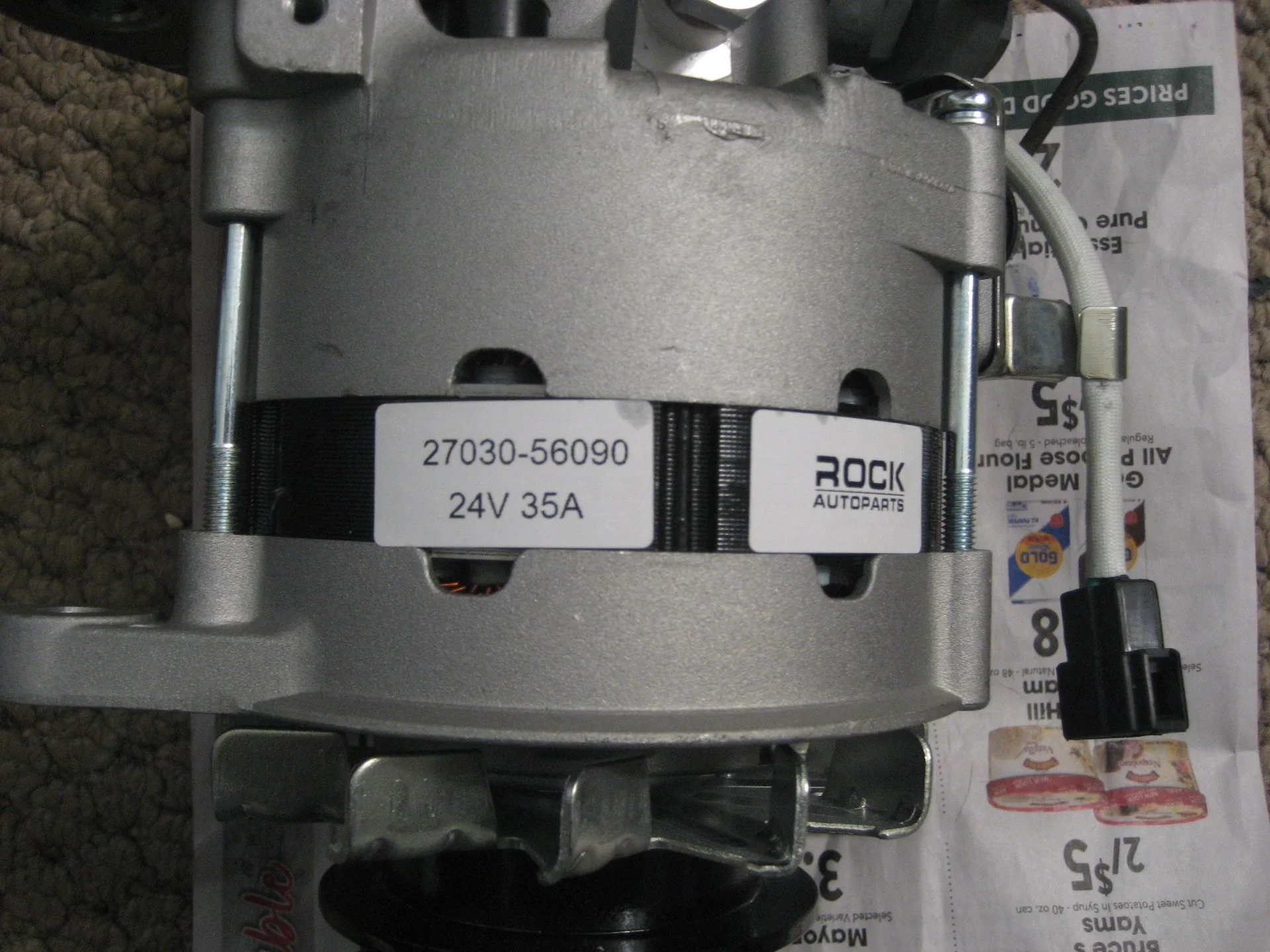

I now have a Chinese alternator in hand.
OEM vacuum pump seems to fit just fine.
Need to make sure oil lines will hook up to OEM.
Still hoping I will find a shop to rebuild OEM alternator.

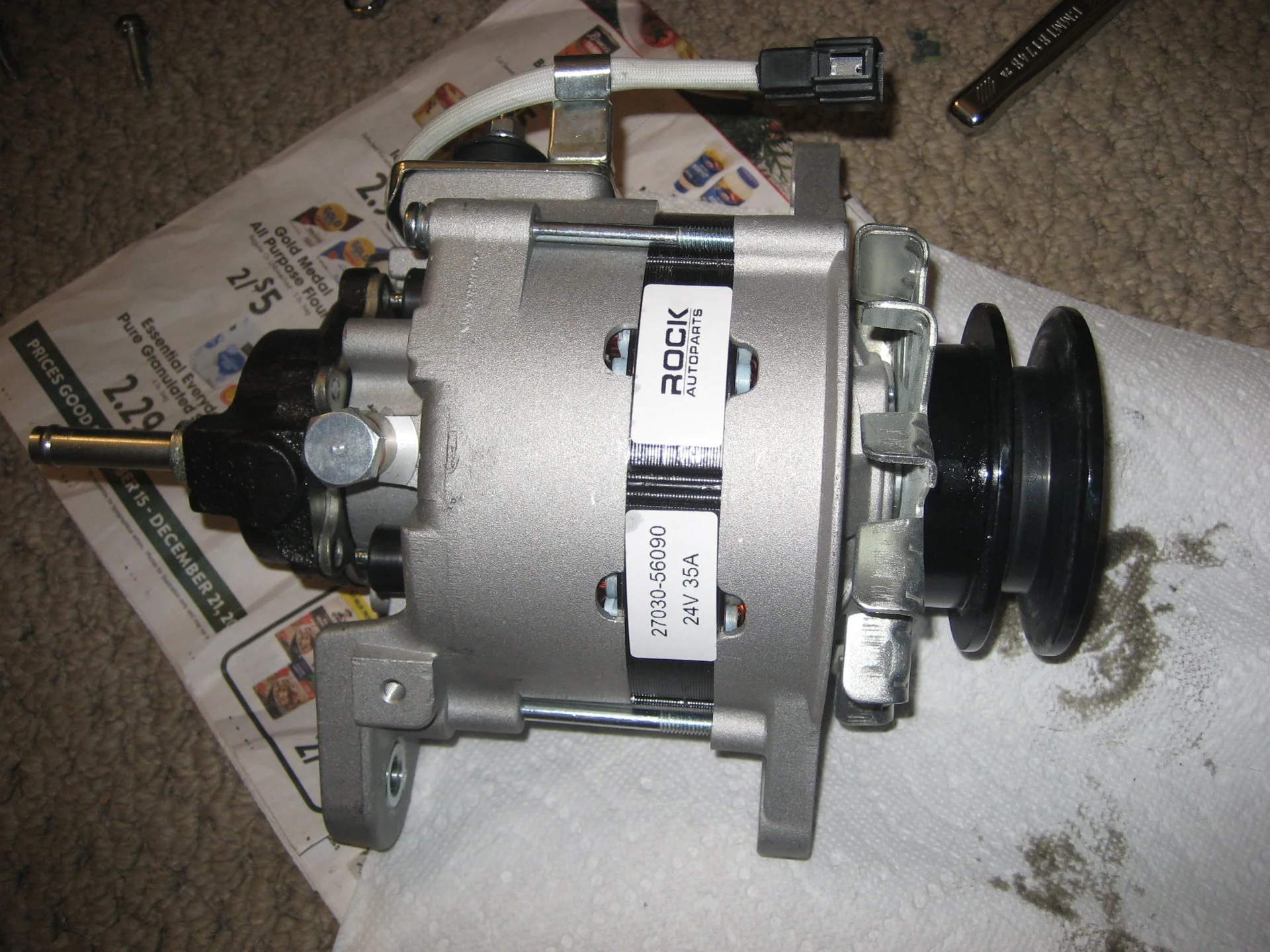

Closer inspection revealed a marred surface where the copper sealing washer for the oil feed will lie.
Took the whole thing to a machine shop to get that surface re-dressed.
Here is the link for alternator I bought from China. China alternator
Cost with shipping to USA = $256.
Local machine shop re-machined the damaged sealing surface for $20: machinist thinks the damage was done on purpose to discourage rebuilding.
This makes sense because this unit is exactly like my OEM Denso alternator.
Maybe in China someone is digging through the junk pile and rebuilding discarded alts.

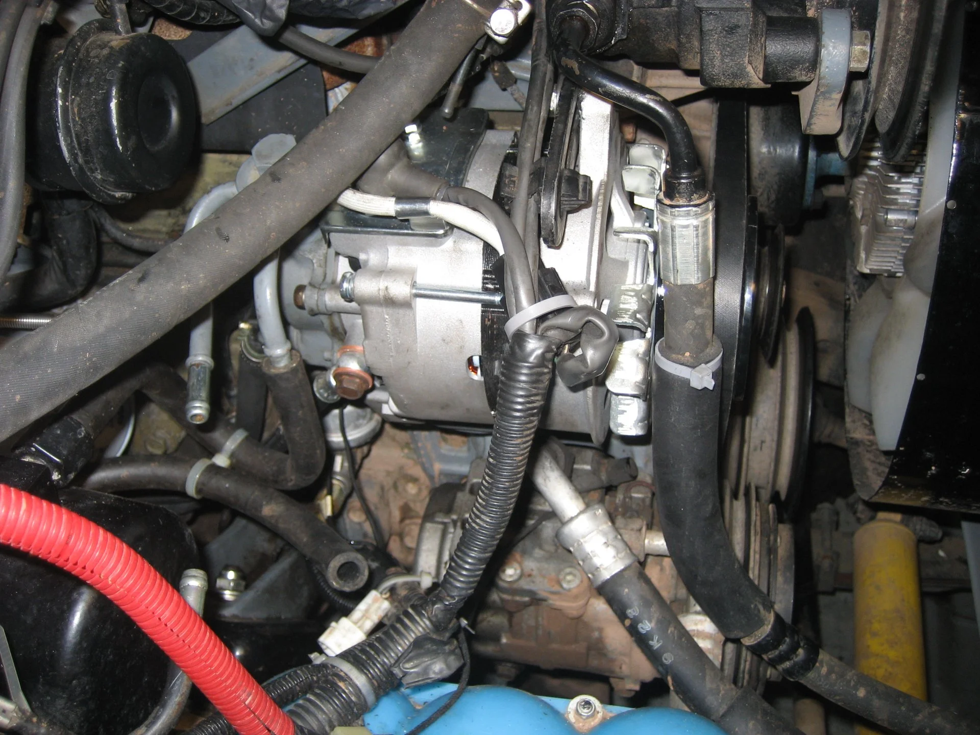

Installed.

did this alternator work out for you? Was it actually 35A? I could use an upgrade. Thanks!
After I got the damaged spot professionally milled flat, yes the alternator worked.
I am 90% sure it was from an 12H-T engine since the mounting "ears" were clocked differently than my original.
I don't know how many amps it puts out. My dash gauge shows something like 28V.
A brand new external regulator meant for a 13B-T BJ74 worked properly with the alt right out of the box.
