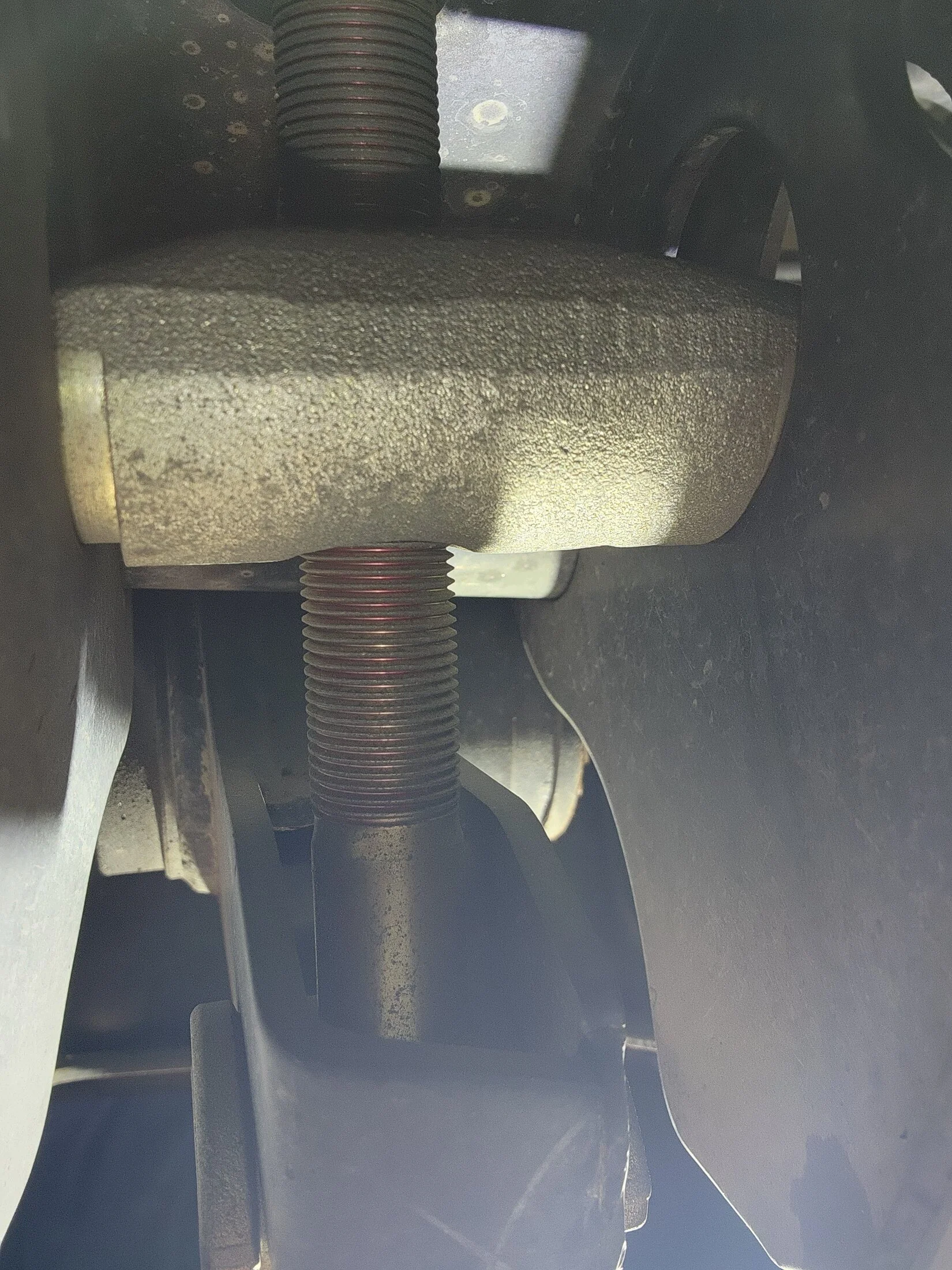

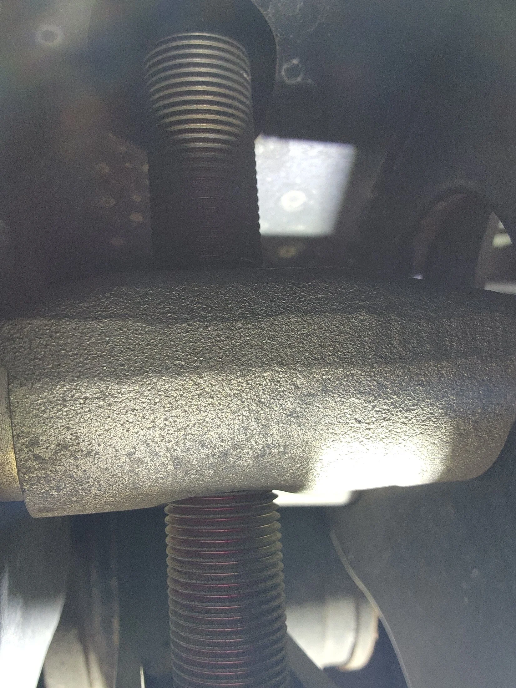

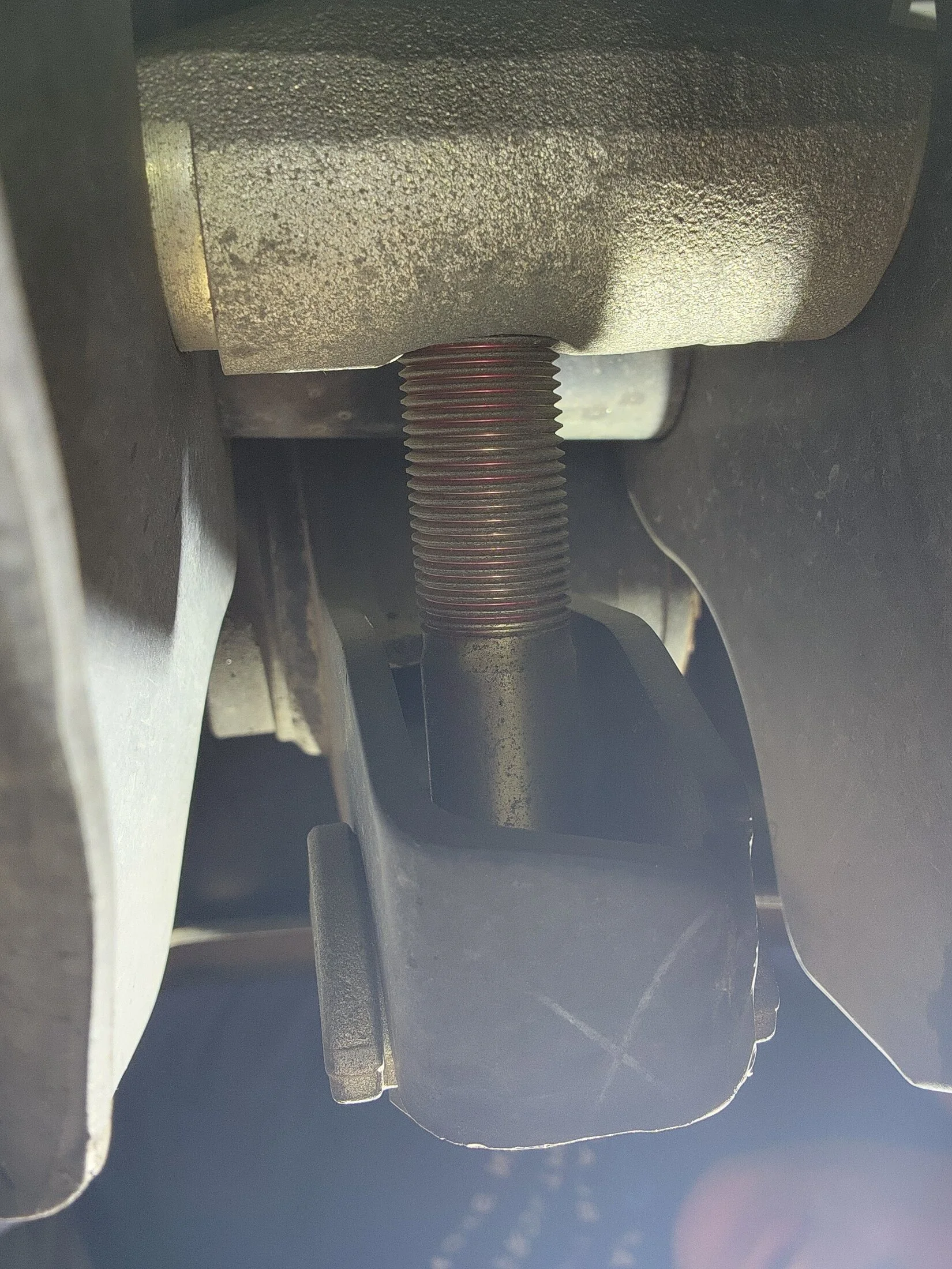

Looks like mine are at about 1/2 adjustment on both sides.
