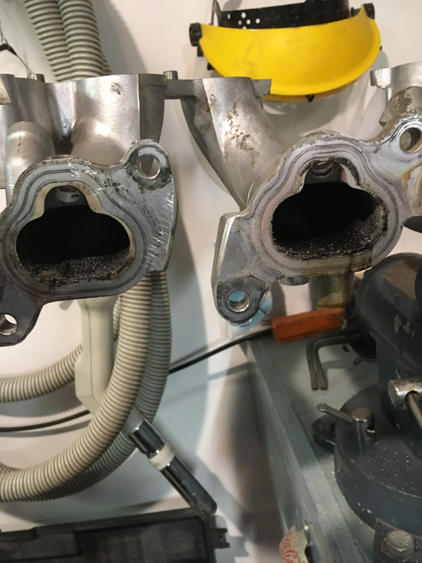

Here’s mine, I did it with the lower intake still attached to the head. I loosened it and put a plate of SS behind to protect the head while I used a pneumatic body saw to cut it."...I did myself a big favor & cut the casting that the entire wiring loom runs thru & smoothed both runner tubes..."
