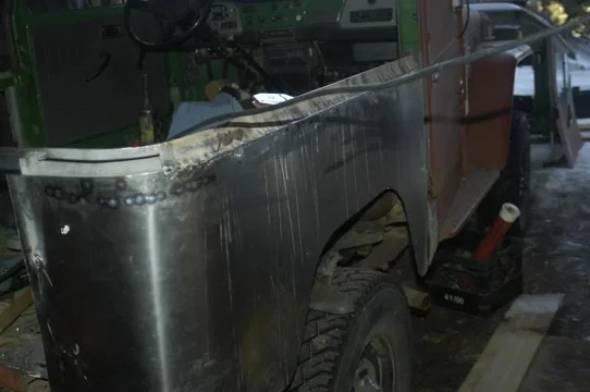

    Both mine are gone. Not because I cut them out, rather that they rusted out. However, that being said I just fabbed a new 1/4 panel out of 18GA sheet. It bent great, but I wish I had rebuilt the support to the point just before it started to bend because without that straight part, your corner doesn't form right. If your panels are bought preformed then no problem. I hand to build something in to make mine work, which it did, in the end. Are you just patching? or putting in new panels?
