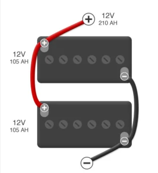

In my mind, the real KISS to dual batts underhood, is setting them up as a single bank. This removes the complexity of handling multiple banks and charging issues. Wired this way, they truly give "dual batt" performance in reserve and ampacity support - giving even FLAs a chance of supporting high power inverters for example. It'll charge faster too, as fast as the alternator can charge (no need for DC-DC charger complexity or bottlenecks). While it doesn't answer the separation of concerns, the reality is that true dual battery reserves makes it that much harder to drain. Adding a low voltage cutoff protects the battery system further. And a portable lithium jumper is the ultimate backup as it's a truly separate device that isn't subject to potential cascading failure modes.
