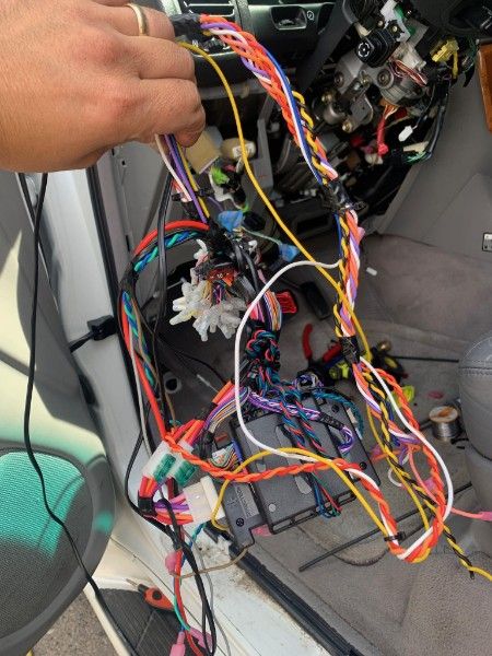

It has started reliably to date for me (~4 months and probably hundreds of starts). I've put in a photo from under the dash on the DS. It doesn't appear to be horribly installed for what it is.
How unreliable do you feel this system being in place is? Would you have it removed for reliability? Would you consider it reliable even after removed? Who would you trust to do that and restore it correctly? Uh, not a good start to the day.

That picture basically looks like a Rorschach test to me, so I'm going to be no help other than a bump.

That looks like a whole heap of crimp connectors in a very tight spot. I actually don't see how that was done without removing that wire loom from the truck, wiring in things on the bench, then snaking/shoving everything back into place and reconnecting the connectors. I've done my share of wiring on cars and complex lasers, and I wouldn't touch that without the full wiring diagrams of the alarm system and EWD for your rig.

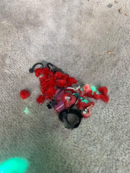

View attachment 2337785View attachment 2337786
By the way, if you're in SLC and need some good electrical work both @cruiseroutfit and StateAutomotive recommended Legend4x4. I would give them a call if you need anything, highly recommended. They have a focus on Land Cruisers and wiring. Expert stuff and really great to work with. Hard not to just hang out at the shop and talk about Cruisers.
That is absolutely unprofessional, a hideous mess.
Wire taps are just not suitable for this type of installation , and I doubt even the products wiring instructions advocate the use of it. You would absolutely need soldered connections.
For stuff like switches and lights yeah (but sometimes not even that). I have had obvious issues with stuff like dash illumination wire tapping being finicky with how the tap is positioned (moving it around) to whether the light comes on. Wow, I'd argue this was not even done by a shop.
Unfortunately, this is all too common in the US. My truck accessories shop, that is owned by friends and I worked at for a short period a number of years ago, uses wiretaps like this on a regular basis. And did so on mine, hence why I was saying I need to go back through mine and redo it.
ARB here installed most of the bullbar / spots lights / fog lights . All wire taps . Only thing I have left to fix in my rig is the IPF HID spot lights.
WHICH, are currently not working bcos of the fact that I need to pop the hood and move the old wire taps a bit and to check that they are working first before they function lol. Thank god they created piggy backs for those these days. I'll be getting LED spots at some point in the future, then they gone
Yeah if used properly wire taps can be good. But lots of times they use the wrong size and then they just easily spin on the wire. This is part of my problem, which then causes shorting issues.
I'm glad it's out after seeing how poorly it was installed. That thing was just waiting to fail. Even if it does fail now because of hack job taps I can logically track down issues with an EWD. Legend 4x4 made good solders and heat shrunk everything he could.
