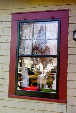

No good pics but here's a crappy one. I actually fixed it, someone had cut a huge chunk out of the molding. Now you can't tell any damage has been done.
We have a Pella wood window in one of the rear bedrooms, it's actually one of their more expensive ones and looks pretty decent. Looks nothing like the original windows, but since it's part of the addition not much to do about it anyway.

We owned a house in the historical district in downtown Mobile years ago. It was built in 1912 and had that exact same moulding around the windows and doors. IIRC those windows had a single pane sash on the bottom and a divided light top sash.
