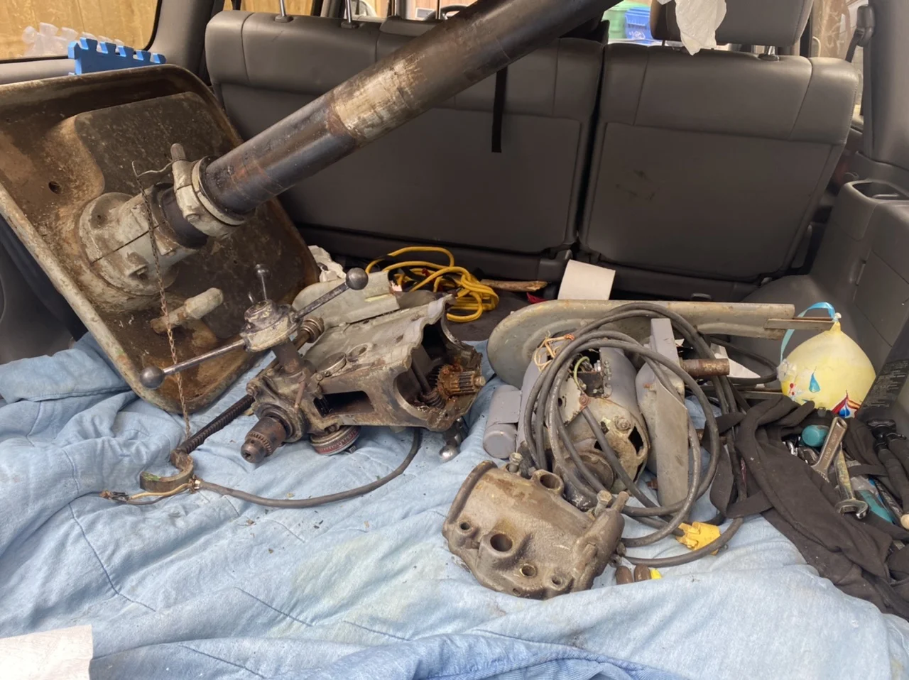

Been on the look out for a good drill press for a long time and found a good deal on one, i think. Paid $50 for it. Missing a couple small things (like a shaft safety collar) but its mostly there. Its a 1940s Delta DP600 drill press.
Guy I bought it from said it didn't drill super straight. Guessing new bearings for the spindle? Anyone into vintage tools that might have advise on where to find bearings for a drill press this old?

Not drilling straight can be wear in the quill or head casting where the quill comes down, but it can also be spindle bearings. Get the bearing numbers, then buy new ones off ebay.

As for the bearings, I get them out and see if I can find a number. Glad they can be sourced online. I was worried they would be impossible to find.

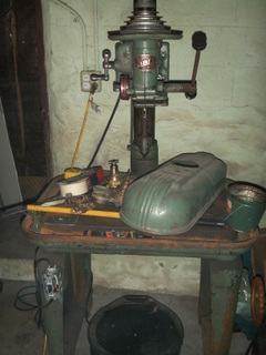

Here are some photos and a video of my drill press. I plan to start the restoration of it this spring:
https://goo.gl/photos/xeZw7rAxpsyidvVMA
Thanks! Yeah yours looks a little different than mine but lots of similarities too.

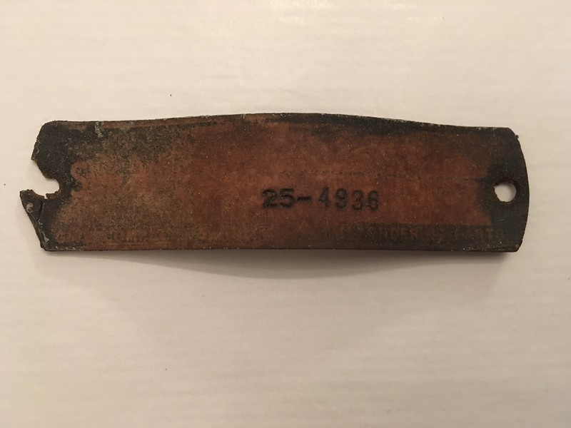

He gave me this:
He called it the "oil board" Its made of leather with I think the serial number stamped on it. He said its leather because aluminum was hard to come by during the war. Not sure if that is true in this case with the tag but its a neat little tag. Too bad its so faded.
Excited to learn about these old things and get this back to working condition. :cheers:
Oh just found this, not leather:
"Style 2C plates were made of "oilboard" (dense coated cardboard) and measured 3/4" x 3" with rivet holes spaced the same as the first style plates. They were used between early 1942 to sometime in 1944. They are fairly common but are somewhat fragile and are often missing or in poor condition."
