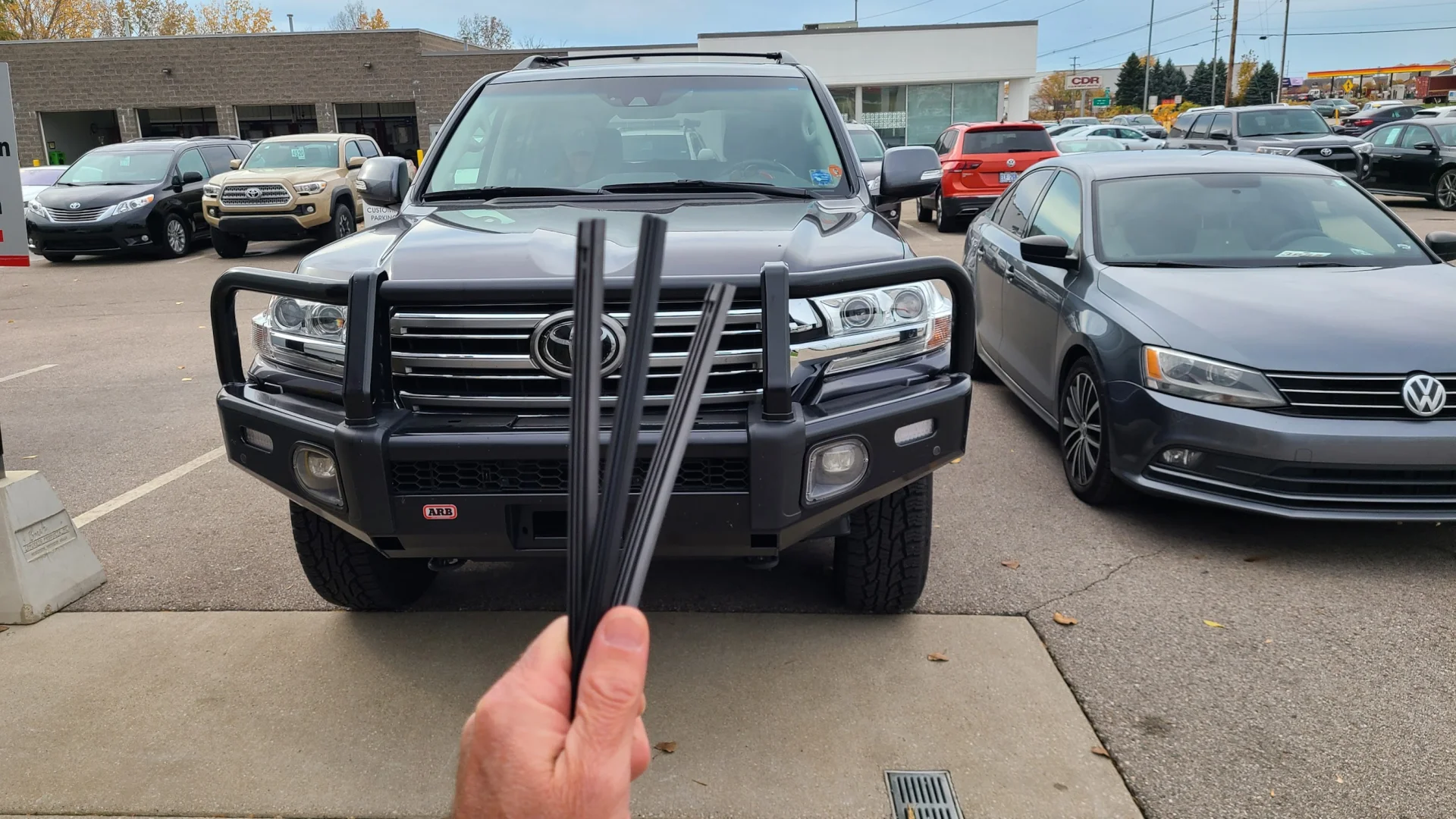

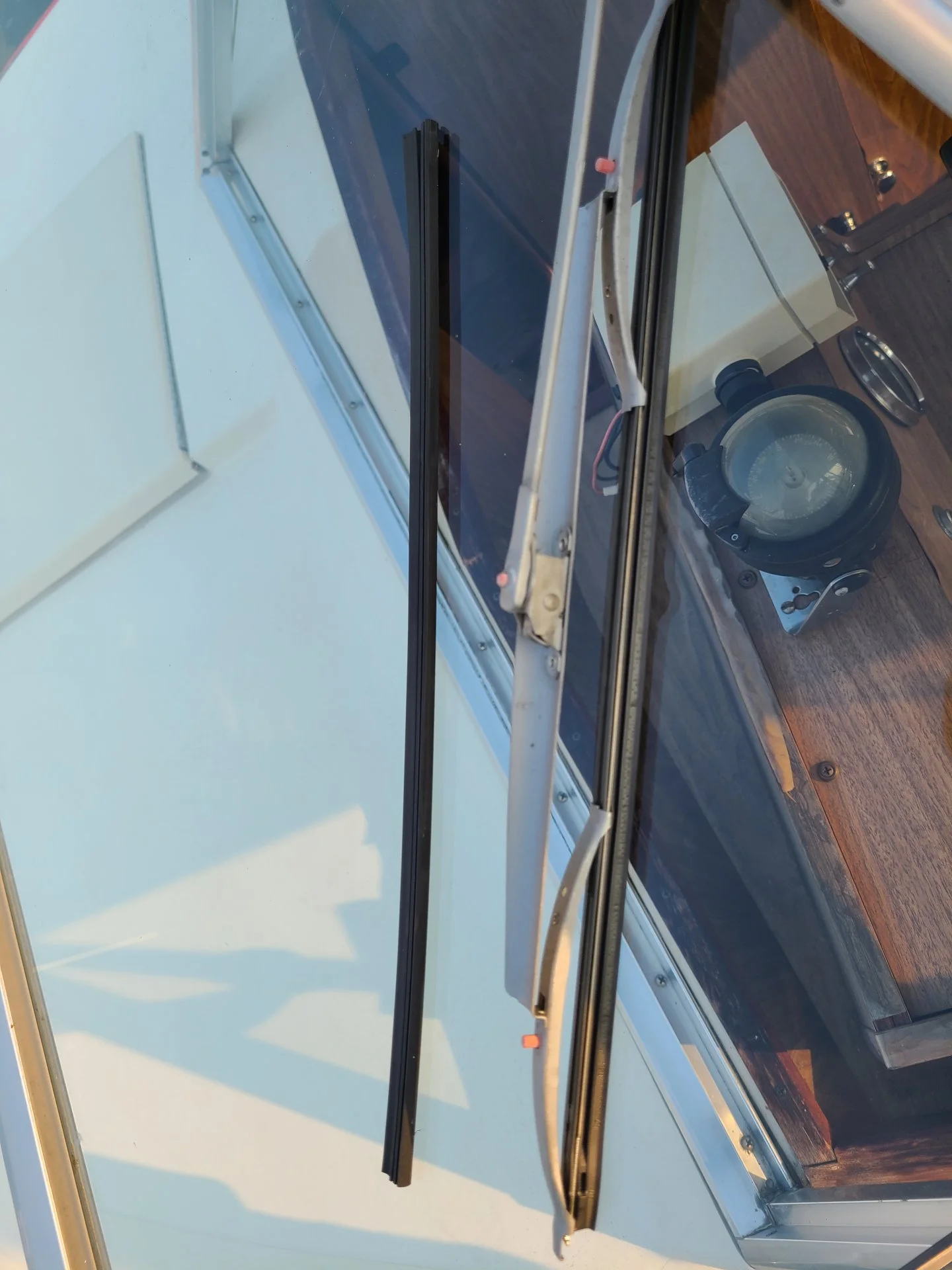

Rubber refill is available online, Toyota part numbers, but I can't find which part number for a '21 200. Passenger side rubber has ripped at 40k. I prefer not to replace the whole blade assemblies. I've ordered and used Toyota rubber refills on my boat windshield wipers, works great.
I used these on my ‘17, which will be same for a ‘21. I get them from a dealer to avoid counterfeits.
Right 85214-0T040
Left 85214-06140
Rear 85214-42040
Thanks, the parts lady was impressed those were the right numbers. Probably should be under warranty, I'll bug them about that later.$50 for three bits of rubber

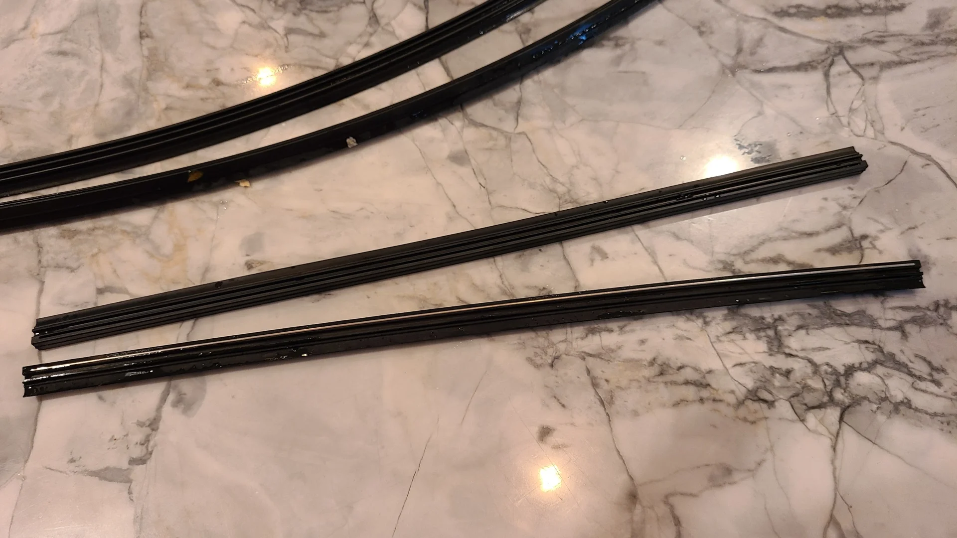

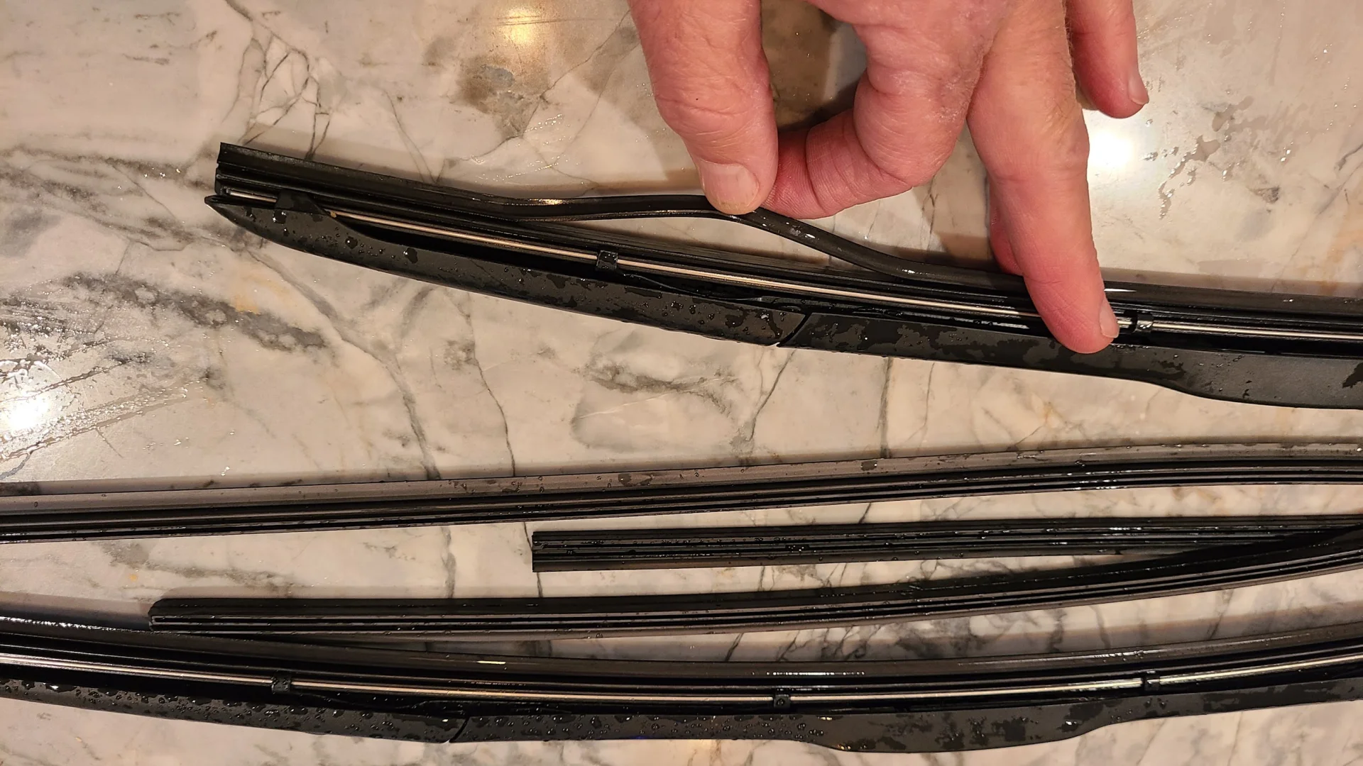

Simple task, but much easier if you take the blades off and do it on a table. I didn't see a way to take the rear blade or arm off easily, so I pulled the rubber out in-place.
Blades come off easily, lift the tab and slide the metal blade along the arm toward the pivot point.
Less than two years old, late summer in Michigan, I've never had a wiper fail like this.

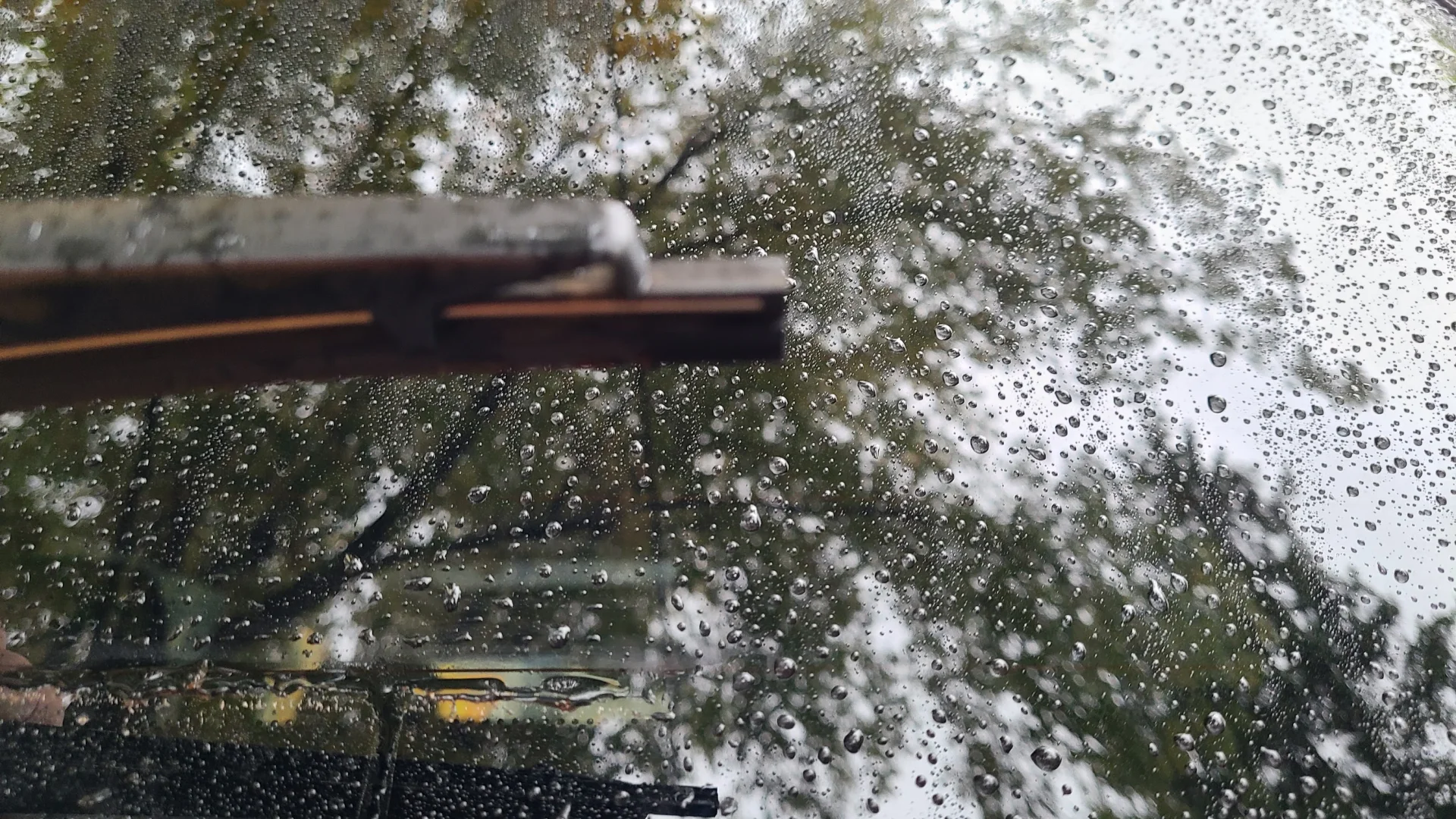

Rear wiper rubber, just bent it enough to clear the stop at the end of the wiper blade.
Not much to swapping the rubber, just slide it out. One end of each windshield wiper rubber has a formed notch to hold it in place. Lay the blade down, slide rubber out, lay it next to the new rubber with the notch at the same end. Swap the spring steel exactly as in the original rubber, they have specific curve and notches that need to go the right way. The rear wipers seem to have no notches or curve to the spring, I guess they go together any way.

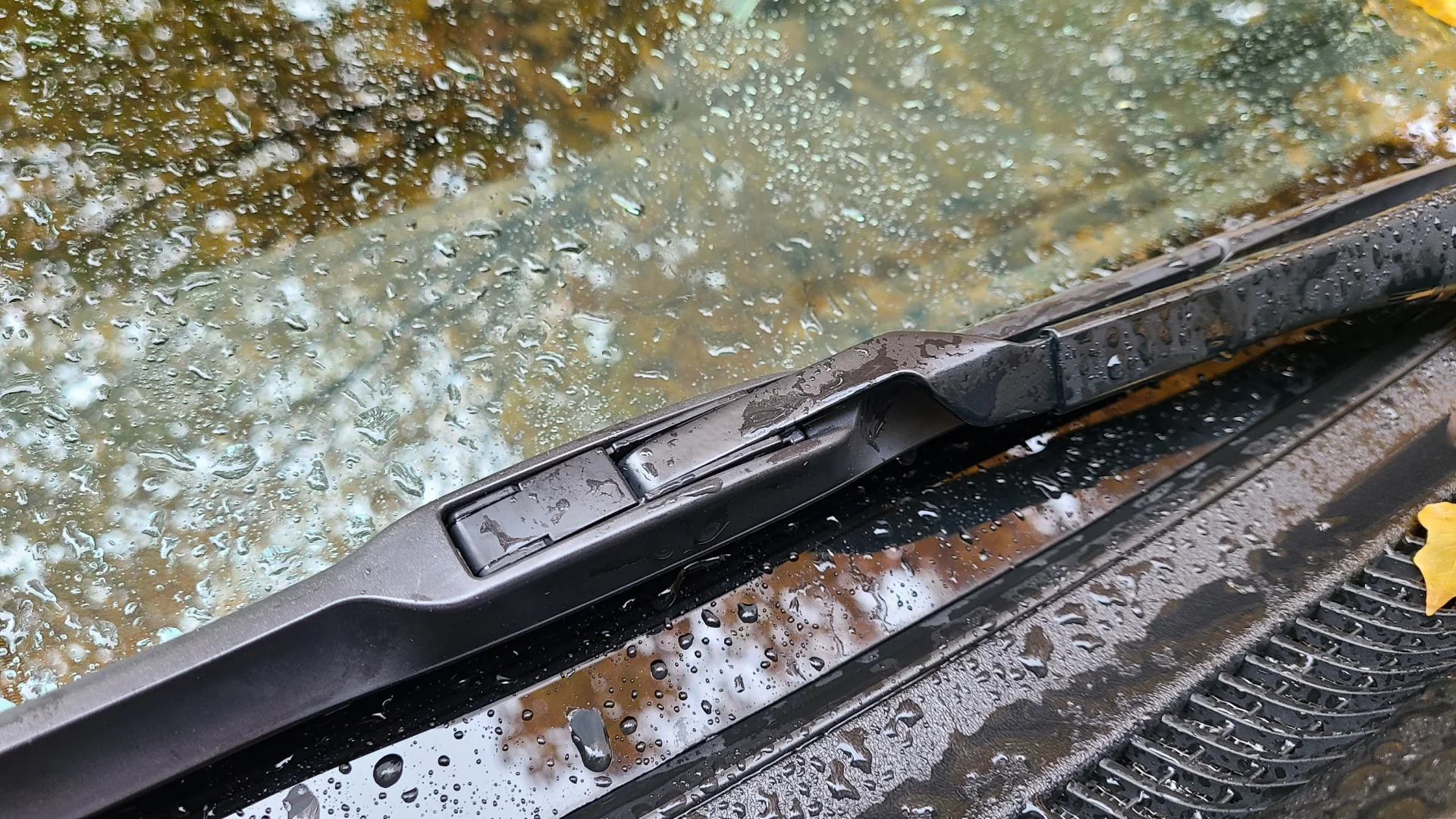

Out of curiosity, what is the advantage in using OEM inserts? Other than keeping it OEM? I've found the leaf-type blade holders create hot spots on the windshield under the contact points and wear faster. Beam-type blades don't have this problem and are super quick to R&R.

The stock 200 blades are more like a hybrid between frame and beam. The metal spring beams that have to be removed from the rubber and put in the new, are curved like modern beam blades. I've not encountered that before. The frame holds that beam with equal force along the length, helping the beam conform as the blade sweeps over a varying curve, something single-point beams lack.
I've tried the top-tier beam blades from each maker, they do well, but it isn't possible for them to conform equally to the different curves of windshields. They are more minimalist, and aerodynamic, and don't get ice in their hinges. But the 200 blade is low with chunky hinges that haven't frozen or stuck so far, pretty impressive for the driving I do around the bottom of Lake Michigan all winter.
