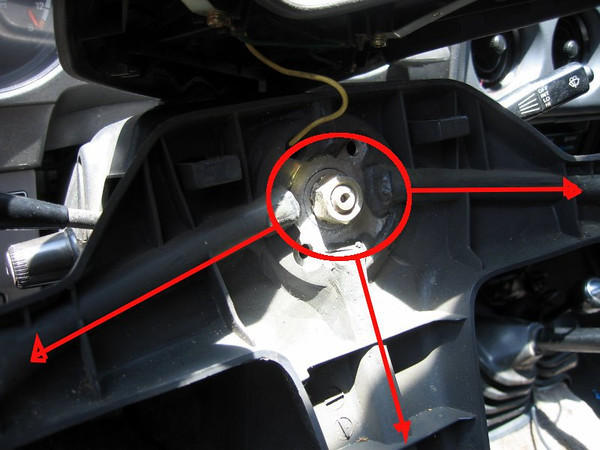

Got home and got to it. First step: remove the three screws on the back side of the steering wheel (vaguely in the areas the arrows point to below), lift up the steering wheel trim on the front, and remove the 19mm nut in the middle (circled). As other threads here have warned, don't take the nut all the way off, just loosen it and then yank the wheel straight back. Do it with the nut off and you'll end up with a face-full of steering wheel. Once the wheel is loose, remove the nut and steering wheel.

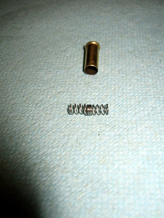

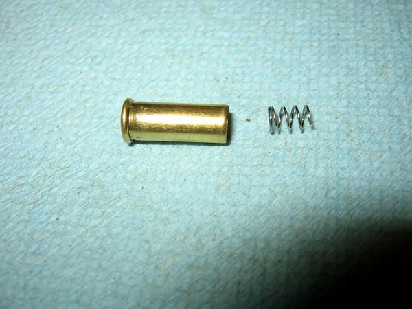

You'll need a .22 casing and the spring from a pen. The spring goes inside the casing, which will fit over the horn pin.
I trimmed the spring to fit. The spring was almost as long as the casing, which seemed too much. I wasn't sure how much spring I'd need, so I cut down about 1/3 of it so I'd have a larger piece left over if I needed it. (I didn't.)

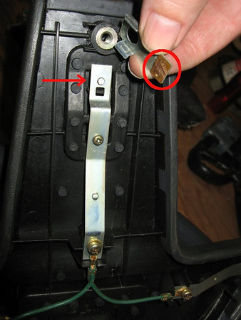

While I had the steering wheel off, I cleaned up the contacts under each horn button with some fine sandpaper. I cleaned the underside of the "receiver" part of the contact (circled) and also cleaned the button contact point the arrow is pointing to underneath that strip of silver metal. I don't know that it was necessary, but it was kind of gunked up and I figured it couldn't hurt. There's one of these at each point the screws comes through from the back end.

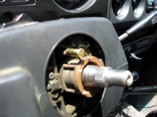

...and the finished product. (A lot out of focus. Oops.) Steering wheel back on, nut back on, screws back in, and you're good to go.
