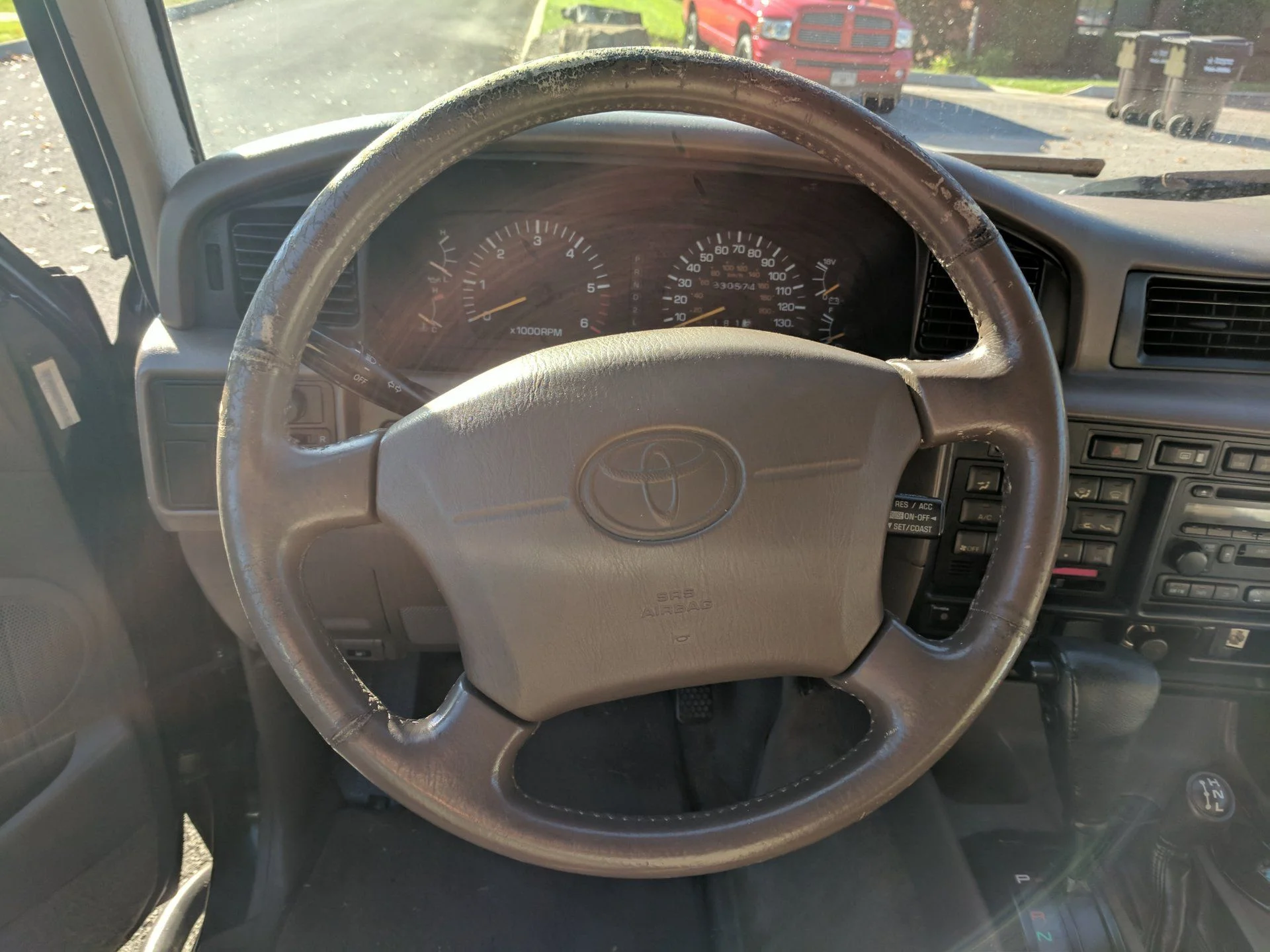

I completed the install of a Redline Goods (RedlineGoods shift boots) steering wheel cover this weekend and wanted to share with the class. If you're not familiar, this is a sew-on replacement for your OE steering wheel leather.
Like most of you 80 series owners, my wheel had seen better days. In fact, my wheel was worn out for so long that the cheap leather slip-on cover the PO installed was also worn out.

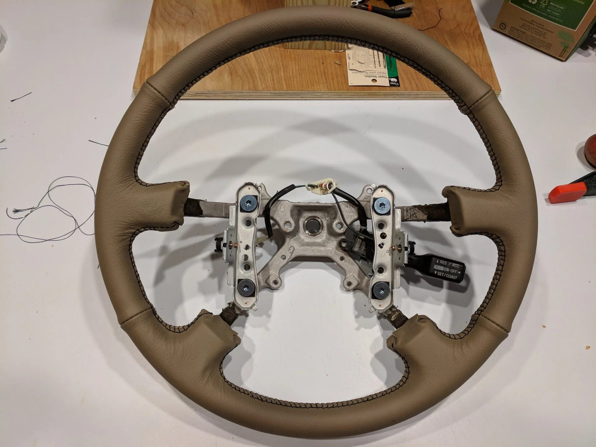

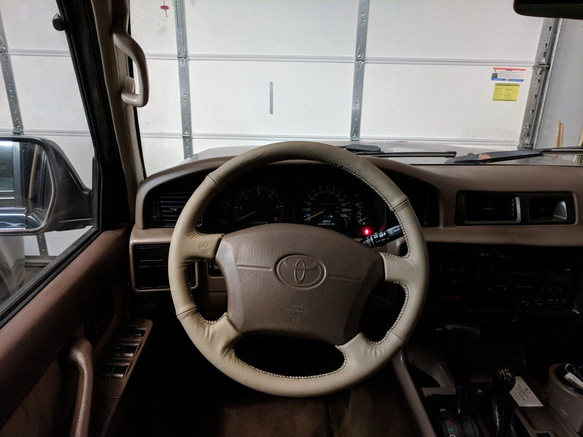

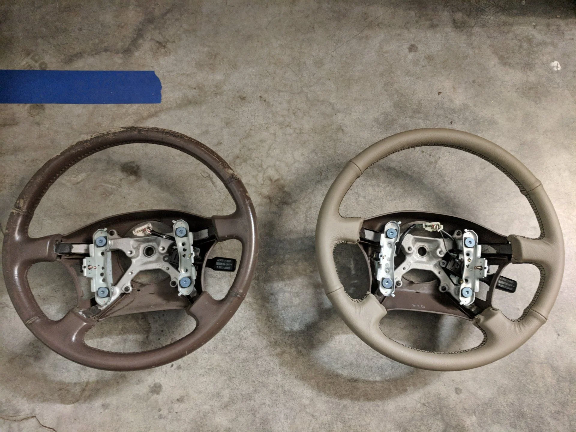

Here is what it looks like now:

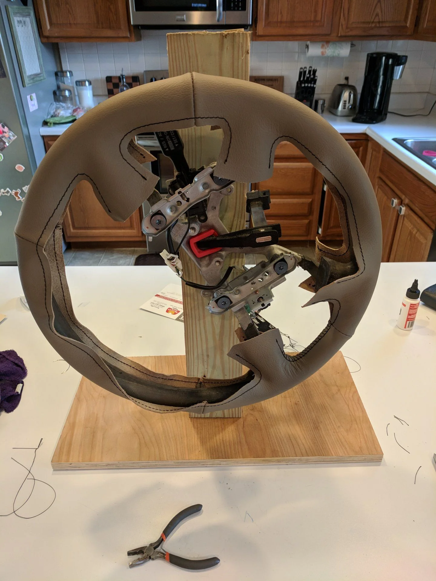

2. Take the time to set up a solid work station. Don't try sewing this thing in your lap. You are in for 6-8 hours of sewing unless you're already an experienced sewer. Get a clean workspace with a solid mount where you can maneuver the wheel into position.

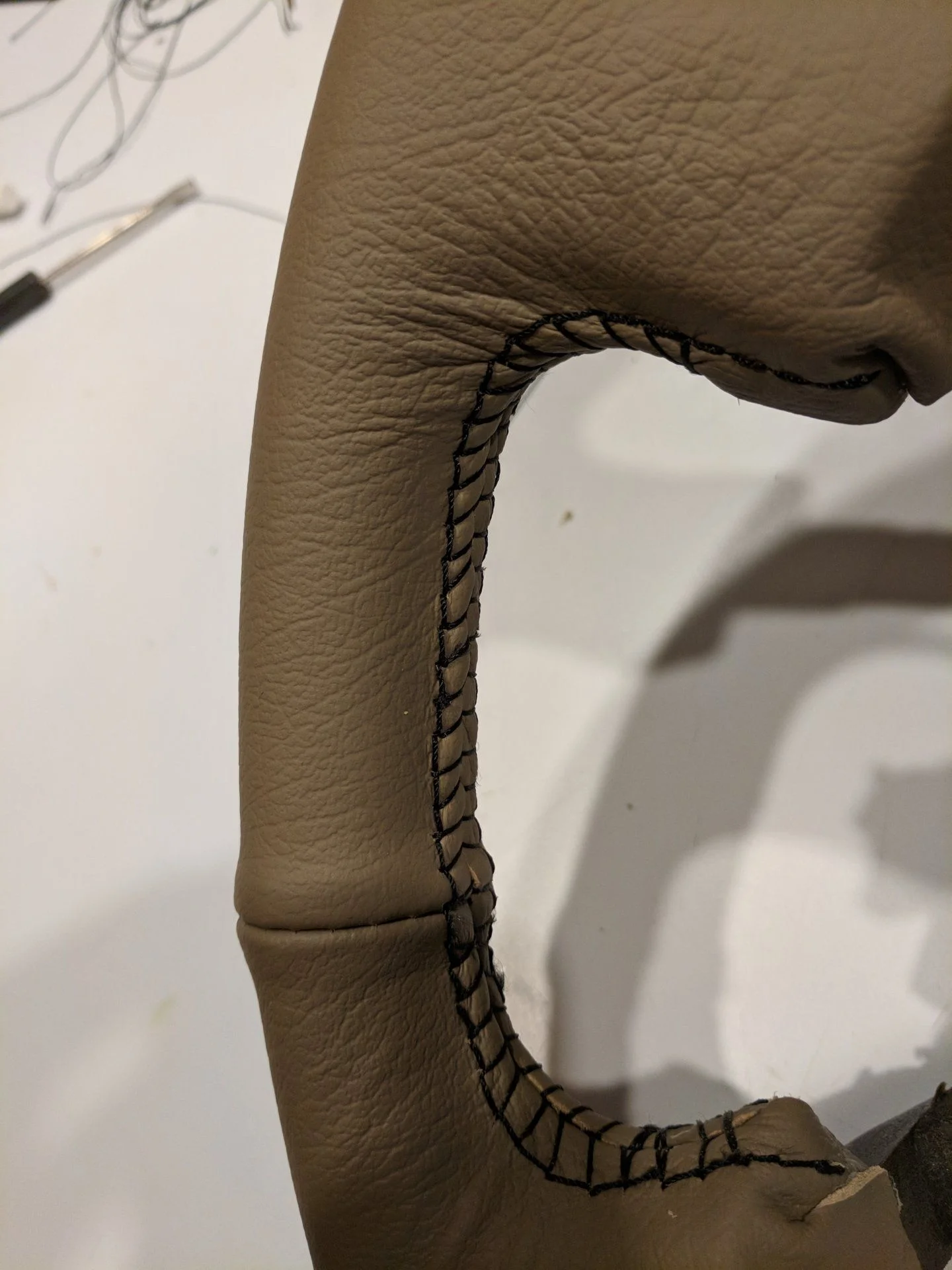

4. Take your time on the fit and finish. Make sure you sew all the way to the ends of the spokes and massage wrinkles out. Mine isn't perfect. As with most DIY projects, I feel like I could do a better job on the second one haha.

6. Watch the ChrisFix steering wheel video on YouTube. His stitching pattern is super simple and way more efficient than some others I've seen. ()

OEM wheel for reference:

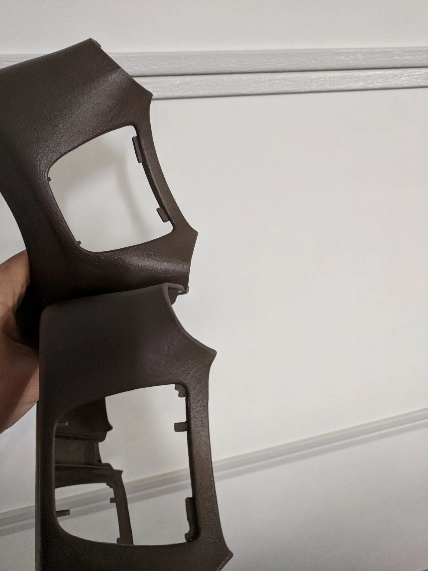

Notice how far the leather goes up the spokes. I stopped some of mine a little short and the plastic trim doesn't quite cover it.

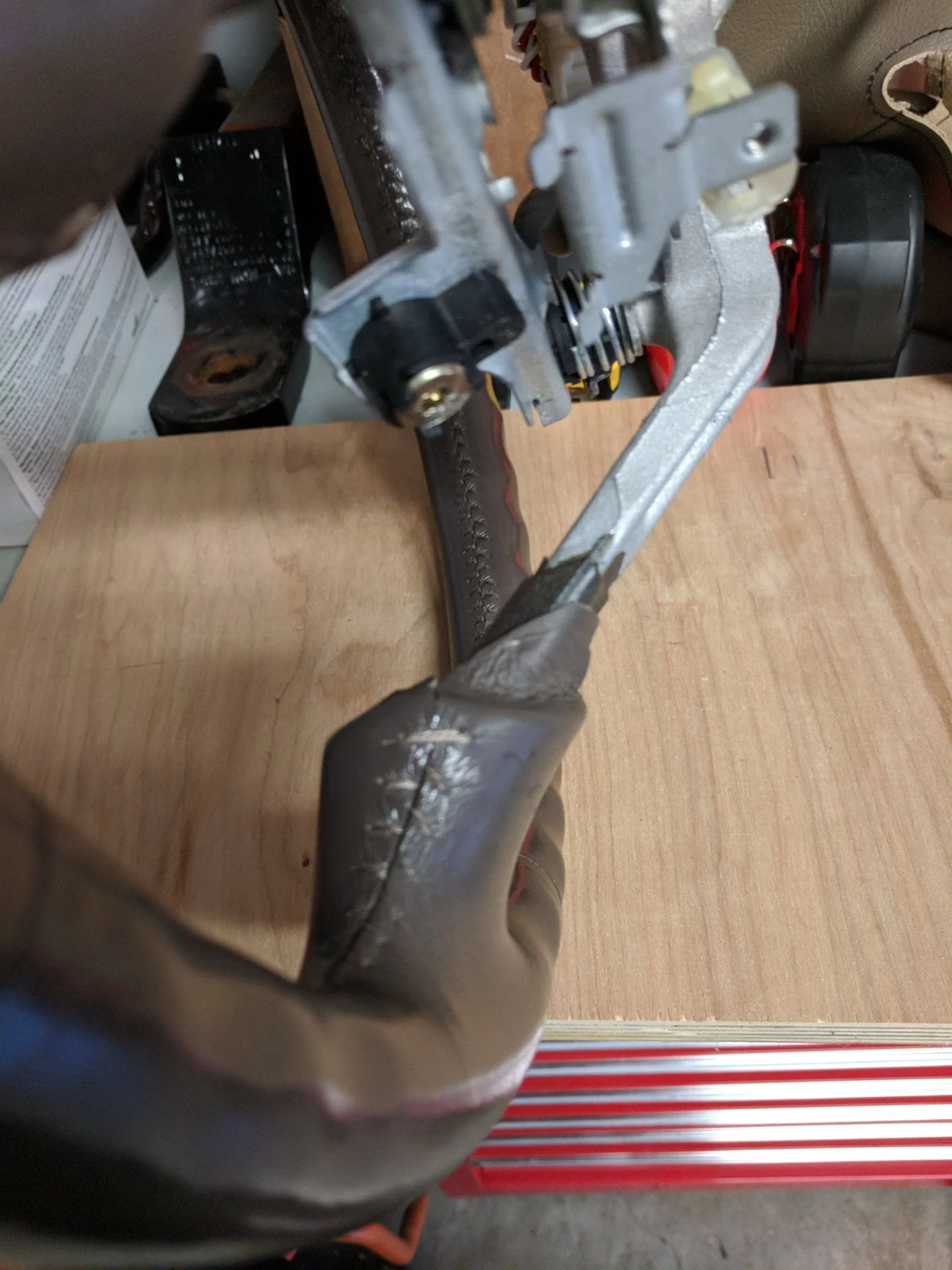

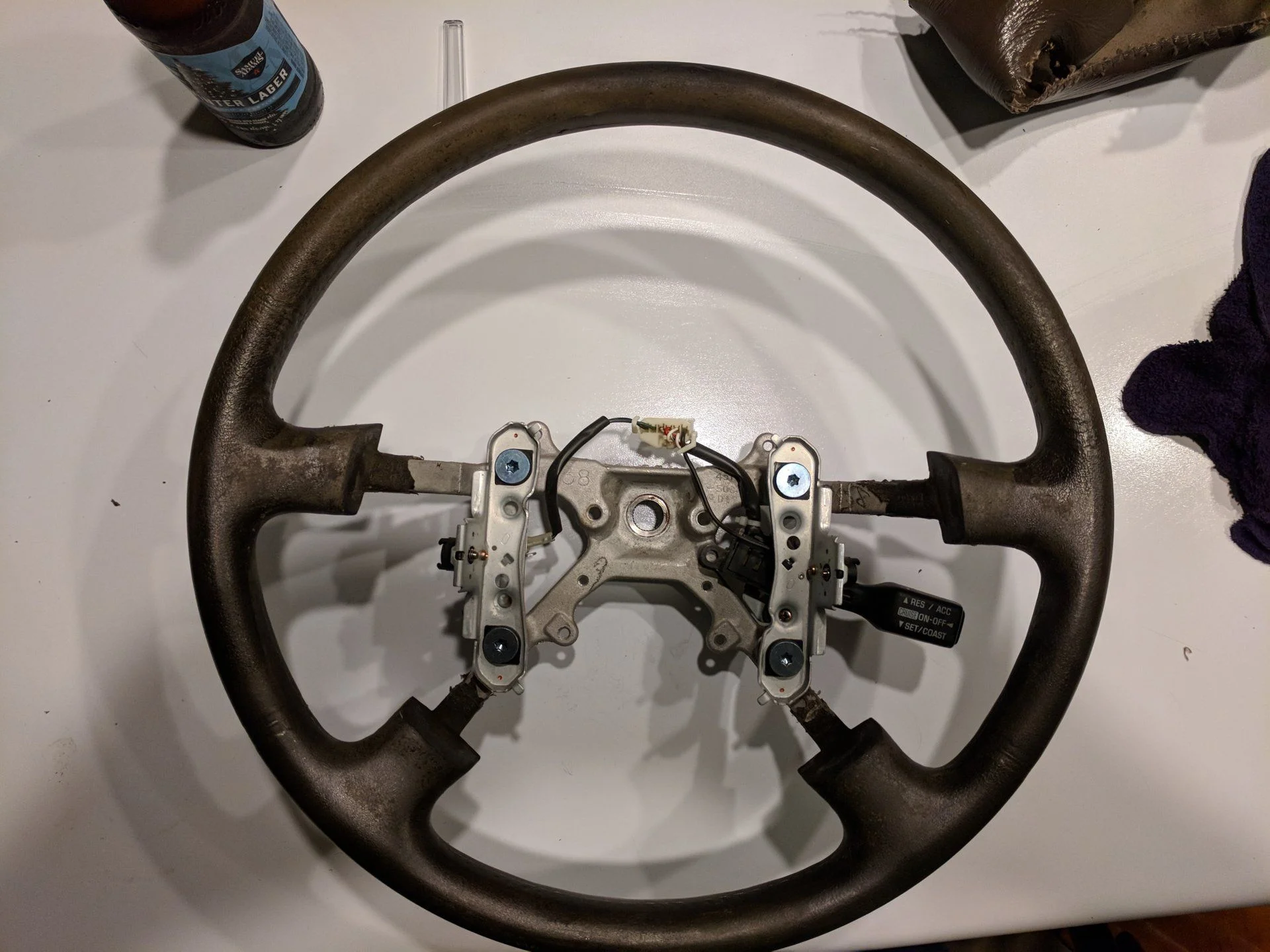

Now, cut your old seams, remove old leather, and use a damp cloth to wipe the base wheel nice and clean
Stretch the new cover onto the wheel and mount your wheel on your new stand that you made from your lumber scrap
