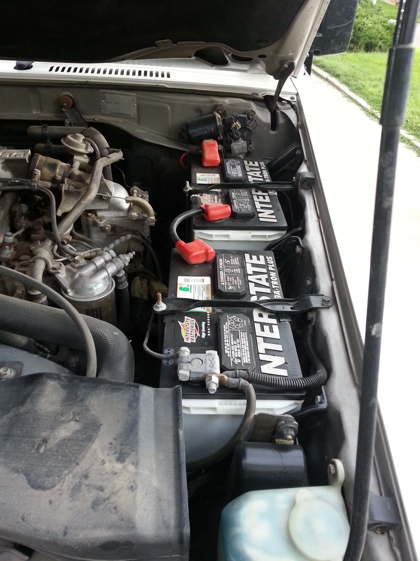

Here is a photo of my engine bay. Negative terminal faces forward per @Juan’s recommendation. The interstate battery above (27F) looks to replicate the Exide batteries I am replacing.
Did my truck have the wrong batteries in? From what I see here, the Interatate batteries down at the parts store are going to work just fine.
Please correct me if I am wrong.
Update: I looked around online at photos of BJ75 engine bays and saw that most of them had batteries laid out similarly to mine (above), with positive terminals back and negative terminals forward. So, I went down and picked up the 27F batteries that I ordered, installed them, and they fit great. The truck turns over startlingly quickly.
Technically your application should use a 27F on the right side and a 27 on the left side. The posts on both batteries shoud be on the side of the battery closest to the engine. So, you are batting .500.
This is the correct orientation for a RHD truck, 2 group 27s. Don't let the two red covers on the bridging cable fool you. If you short either of those posts it will arc.
