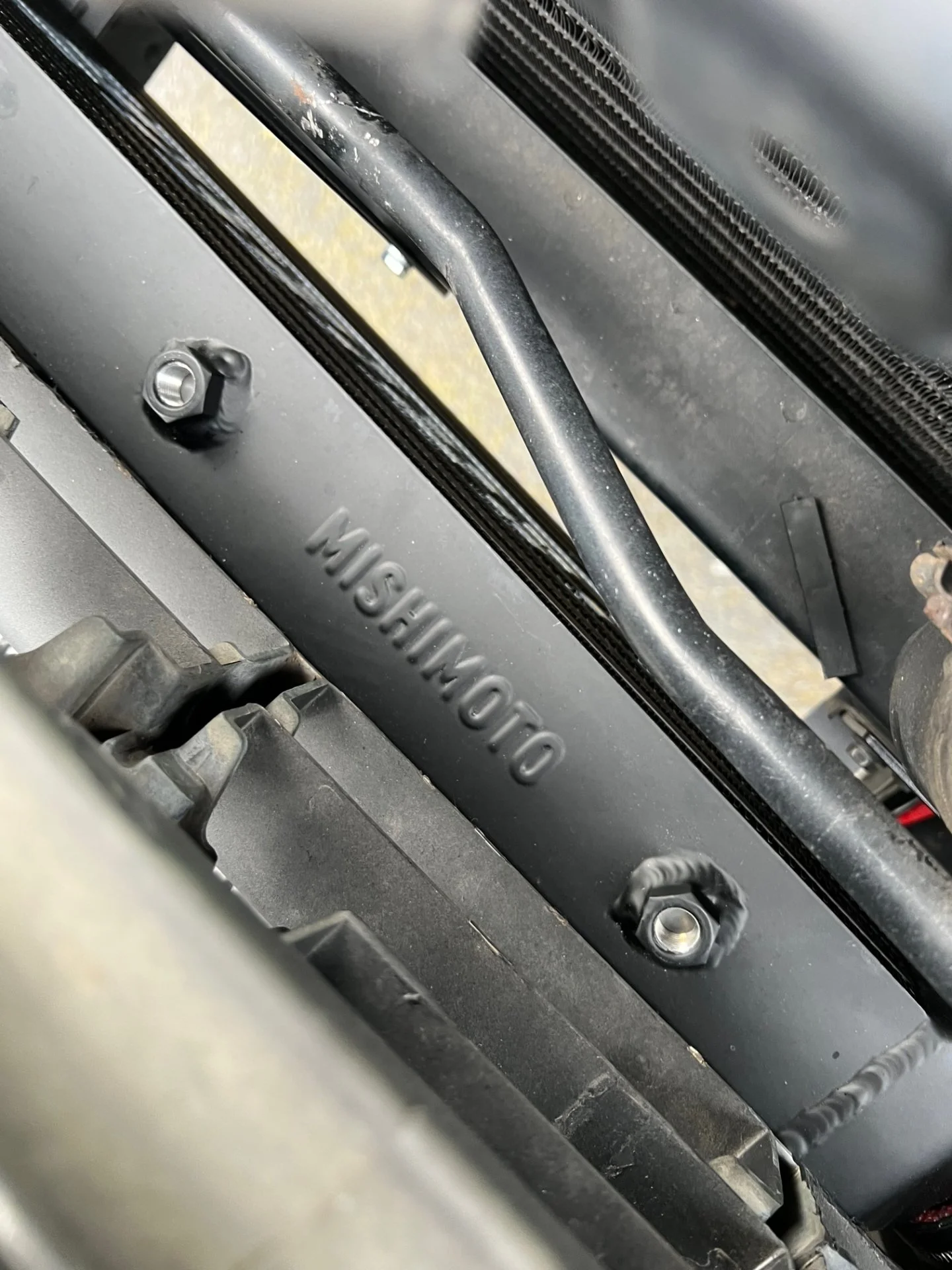

1. Mishimoto Z-Line front mount intercooler w/ 2" intercooler piping

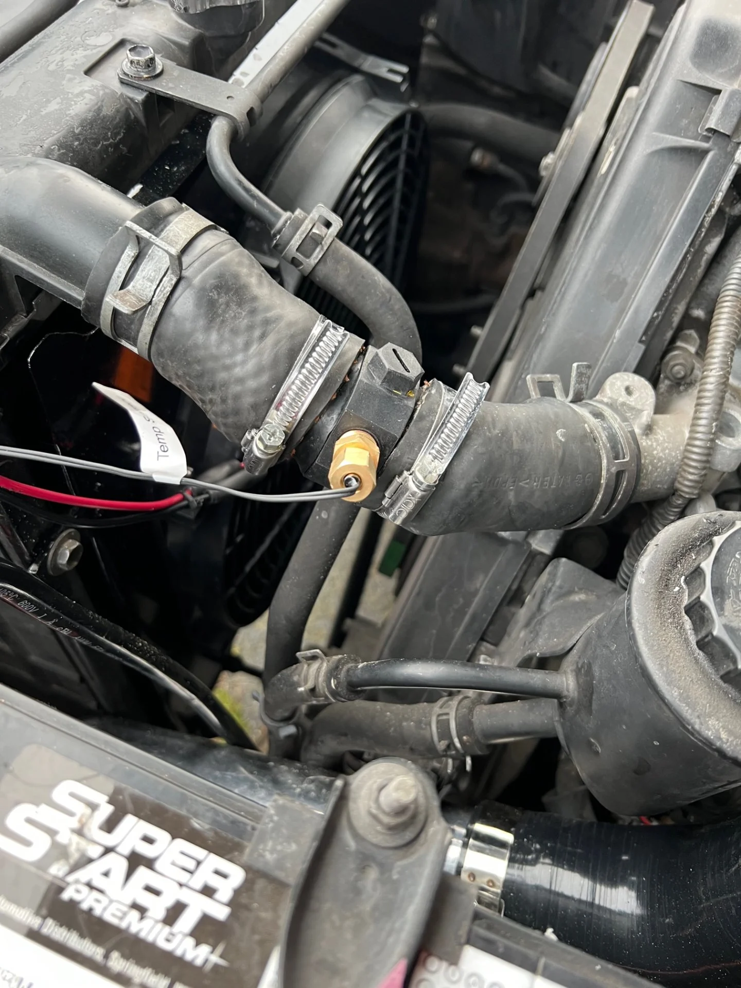

4. Davis digital thermatic fan switch (allows me to set fan temp)
5. Davis inline thermal sensor adapter
5. Tridon High Flow 77C Thermostat

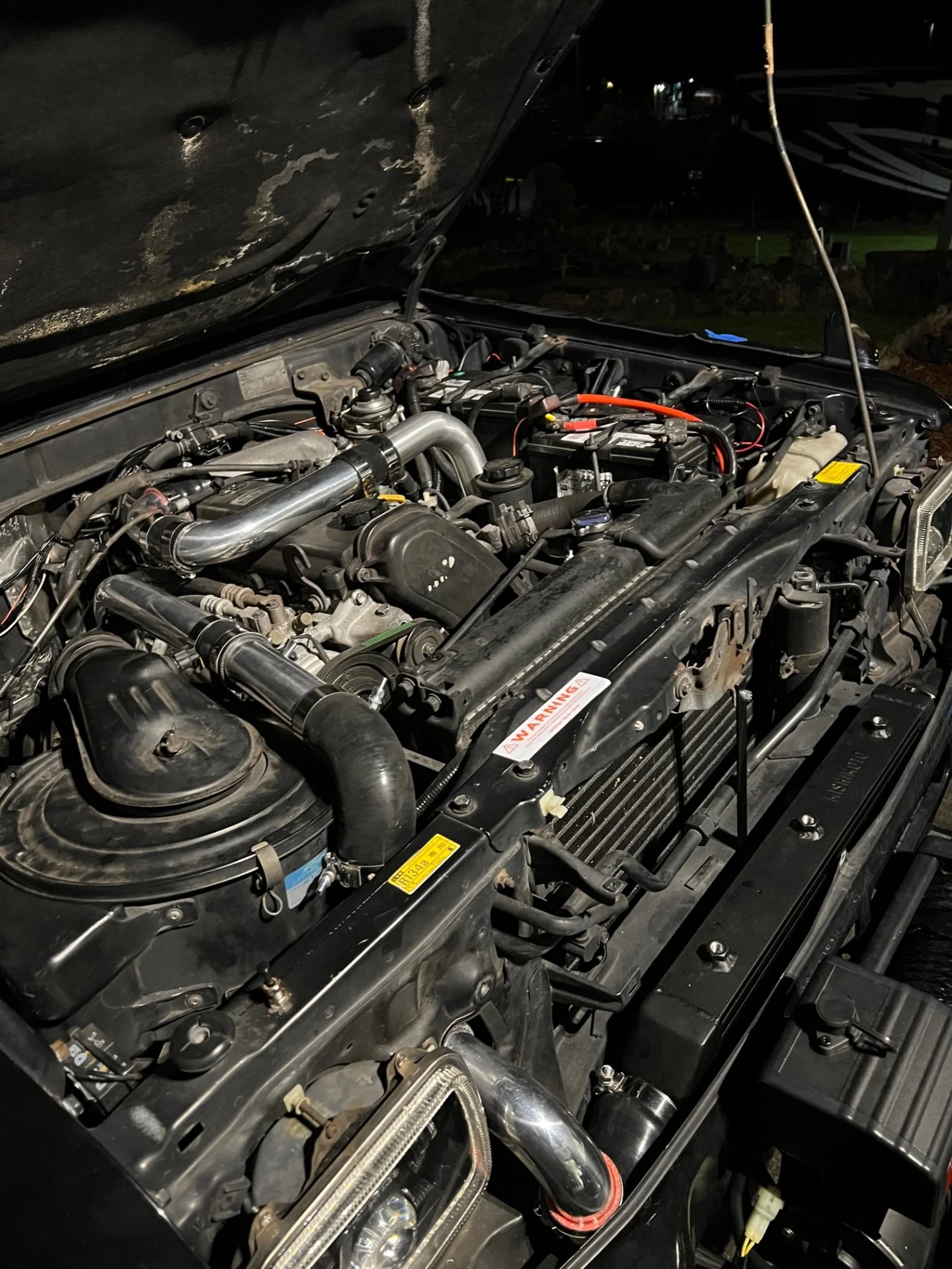

- She has a little more pep in her step now. I used to take forever to get up to speed with traffic, but it feels like now I can drive at speed with traffic much easier. Given, I still watch my EGTs religiously as I accelerate. I still hit 900 from a red light to cruising speed, but it does so faster.
- I mention this later but EGT temp is at 850-875 @ 65mph flat ground.
- The lowboy fan is barely noticeable from a sound aspect over the engine. I couldnt tell it was on from inside the cabin.
- The hood closes normally, so all the intercooler pipes clear. There is a bit of rubbing on one pipe from the shroud on the hood, but I wouldnt consider it excessive (as of yet).
- For the crossover pipe I used a normal pipe clamp instead of the round ones since it's a little bit of a rectangular shape. The normal pipe clamps are more flexible and conform to the shape better.
- It helped to get a little bit of WD40 silicone lubricant to get some of the intercooler pipes on the silicone hoses.

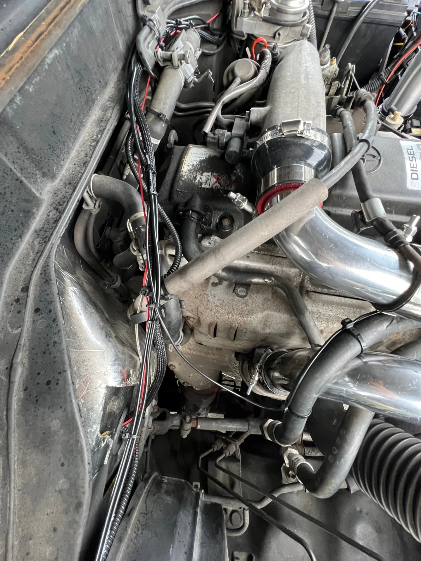

I'm noticing some oil spraying out of what I think is the oil hose or somewhere near it at the top of the block. I never noticed any on the ground but I do notice some build up as I was digging into my engine, and most recently saw some fresh oil on my intercooler pipes. Is there any part numbers to fix this or any links anyone can recommend for this particular issue?

sorry can't be more helpful but you are just going to have to clean and hunt, clean and hunt. If the leaks were not there before, more than likely you created the leak.

I put an aussie engine guard for temp monitor recently , just bolts directly to the head and powers from my aux battery. Much easier than tapping the coolant. I can read the temp of my engine accurately from the house kitchen, love it.
I wouldnt have called the electric fan an upgrade. x2 for the Engine Guard or the Engine Watchdog
