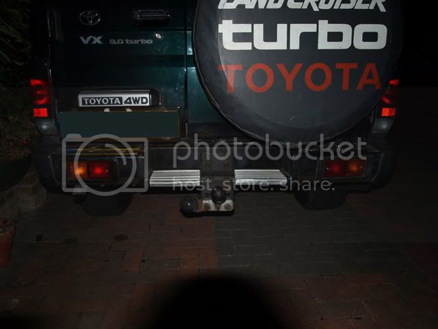

I have a KZJ70 and Im looking for a bolt on receiver hitch that bolts to the rear cross member. Anyone know if they are made and where I can get one?
I have looked here in the UK and there seems to be none, I used to live in NY so I have friends over there who could mail it to me if there is anywhere stateside that does them?
At the minute I have this crappy drop plate but its more of a plough/anchor than a hitch! :rolleyes:

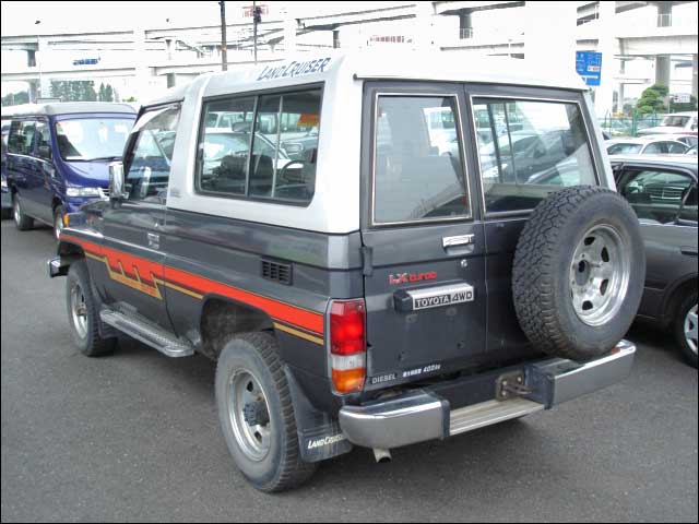

I've seen that same tow ring on quite a few JDM 73s and 74s, and I suspect it's OEM. Perhaps the 73/4 frames didn't have welded nuts at that point.
No evidence that any were ever there since it would be difficult if not impossible to grind them off since there's not enough room.

That looks quite good too. How far does it hang down though? Im trying to make sure I dont have anything to spoil my departure angle.
