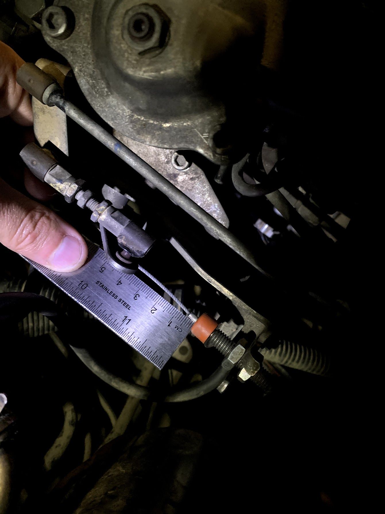

My hydro A442F (1991 HDJ81) was rebuilt last year.
Last weekend, I pulled the ACSD from the injection pump. No problems, everything good. However, now the transmission appears to be flaring between 2nd and 3rd.
You can see a short video here:

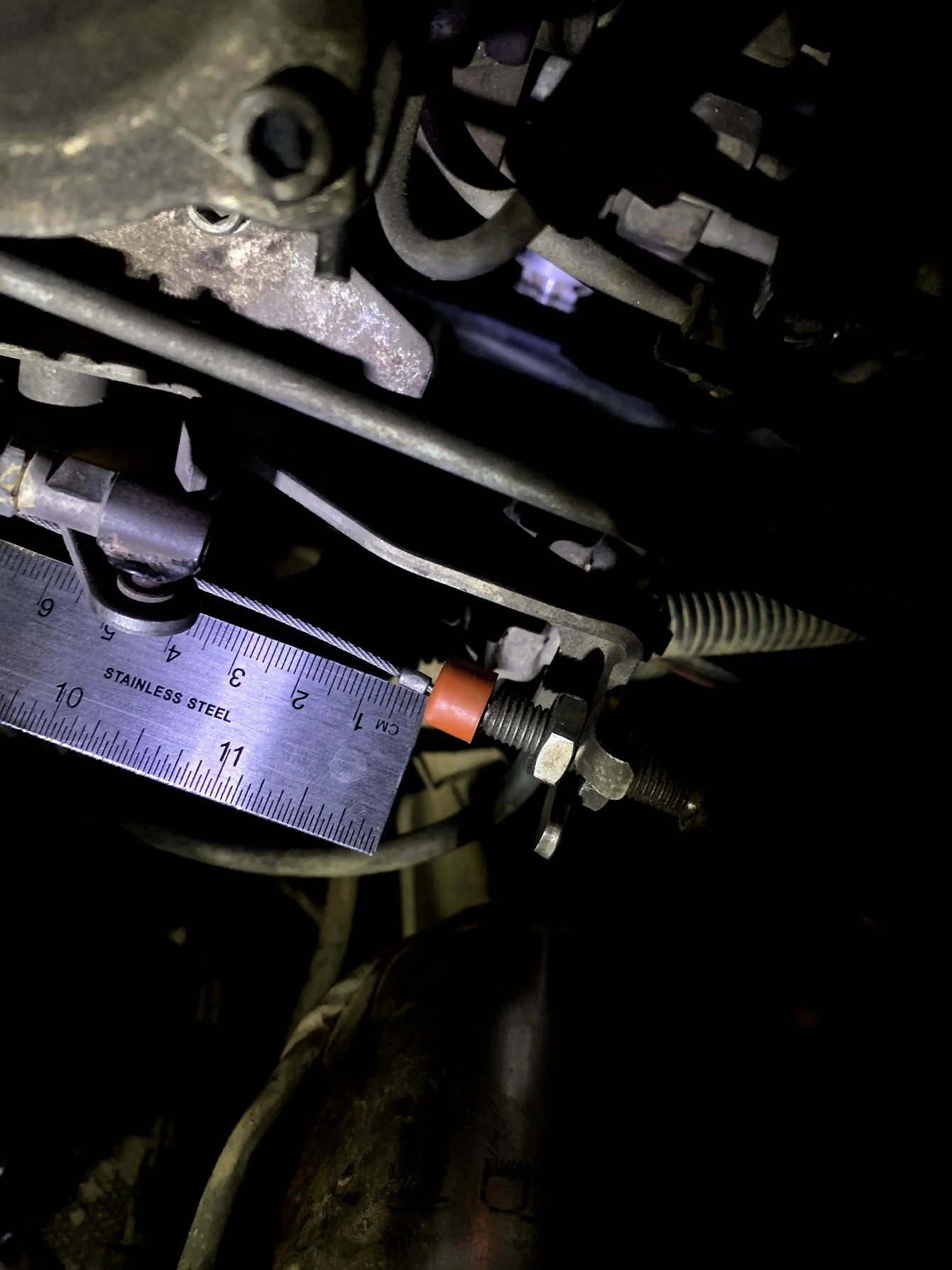

I tightened up the cable tonight and will test in the morning. I realize the FSM states the red cap should be within 1mm of the end of the stopper, but that gives the cable far too much slack. Perhaps I should just get a new cable?
Before
After
What else should I be considering?
Tighten the cable more.
Dont be afraid 1mm isnt enough.
Go 10 or more mm
If it shift to hard you can always go back. I have mine fully clamped of with vice grips to give full line pressure
I also used to have aflare between 2-3 upshift thightening the cable fixed it and has been like this for over 150k km

Thanks! Yep, was just a kickdown cable adjustment. My 1mm adjustment was all it needed. Simple as can be.
