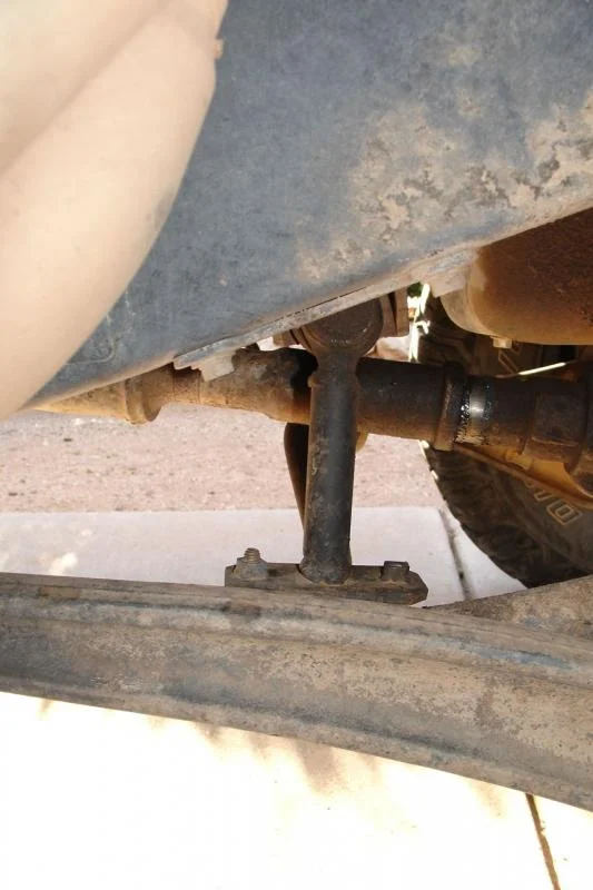

You don't have to buy blocks or brackets. I extended my links using 1/2 x 6 black pipe nipples from a plumbing store. Cut off the threaded ends, cut to the length you need then cut the links in half. Weld the extensions in place. You may have to grind out the seam inside the nipple to get it to slip over the link.
Costs couple dollars and about an hour or so.

Do you have any pics you can post? Thanks!
Here ya go. Front and rear respectively

As Mr Baggins said they are easy to extend, my pix of the later type;
