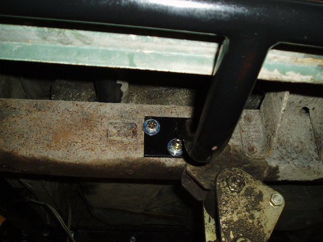

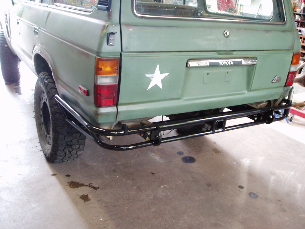

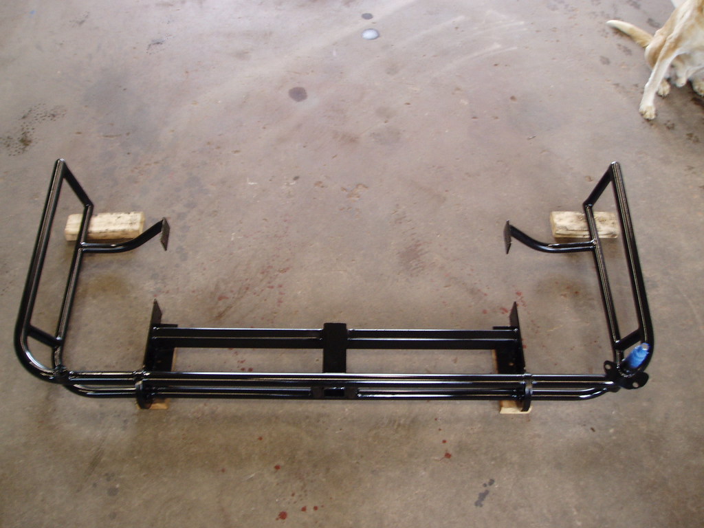

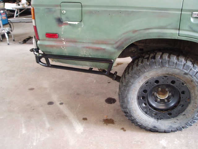

I was able to finish up all but the fuel can rack and the latch cam on the new tube bumper for the 60 series yesterday and got it installed this morning. The bumper can be built with or without a swing out. This swing out will have a removable 2 can rack and provisions for mounting a Hi-Lift jack as well.
The OEM rear cross member must be removed and is replaced with a 1.5” X 2.5” .188” wall rectangular tube in it’s place as part of the bumper. The bumper itself is far stronger than the OEM cross member but the rectangular tube also acts as the rear mounting point for the 2” receiver. There are also provisions for mounting recovery shackles that are .75” thick and mounted directly to the frame ends. The bumper mounts with 8- 1/2 ” grade 8 bolts and 12- grade 8 3/8” bolts. 8 of the 3/8” bolts replace the rivets that are drilled out of the rear most body mounts.

Thanks for the comliments. Although I did not weigh the bumper prior to installing I would guess it is around 75-80 lbs without the swingout. I'll weigh it next time it comes off.
I have not priced the bumper yet, PM me on that.
I will be putting a 2 can rack on mine that will be removeable. I can build whatever you want to be mounted on the swing out.
The bumper can be built with the spindle attached and no swing out. Adding the swing out later would require some fab work on your end if installed at a later date.

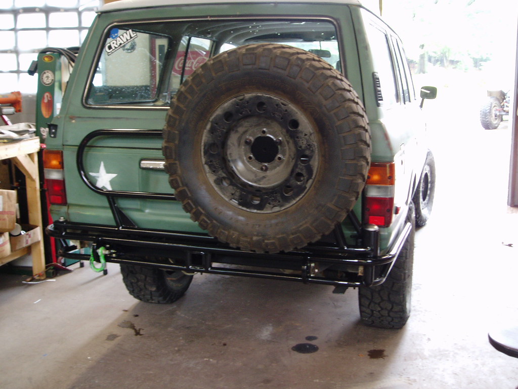

Looks great, what did you use for the hinge?
The hings is a 3,500 llb spindle with 2 bearings.
nice work.
How big of tire will it hold?
:hmm:
That is a 33" on it in the photo, It can handle a larger tire but would have to be moved toward the center to clear the tail light. Not a problem.
