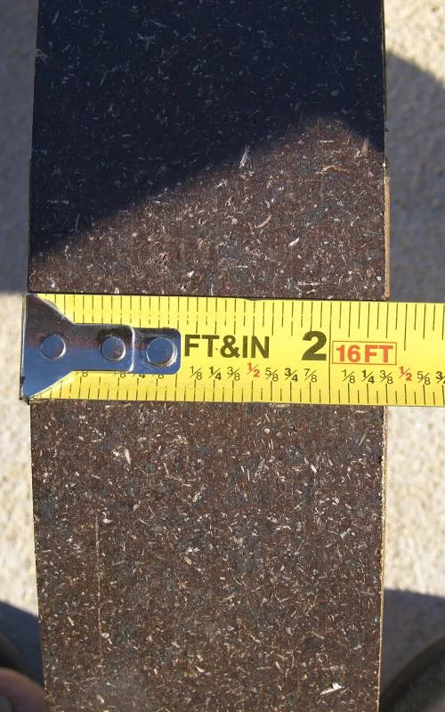

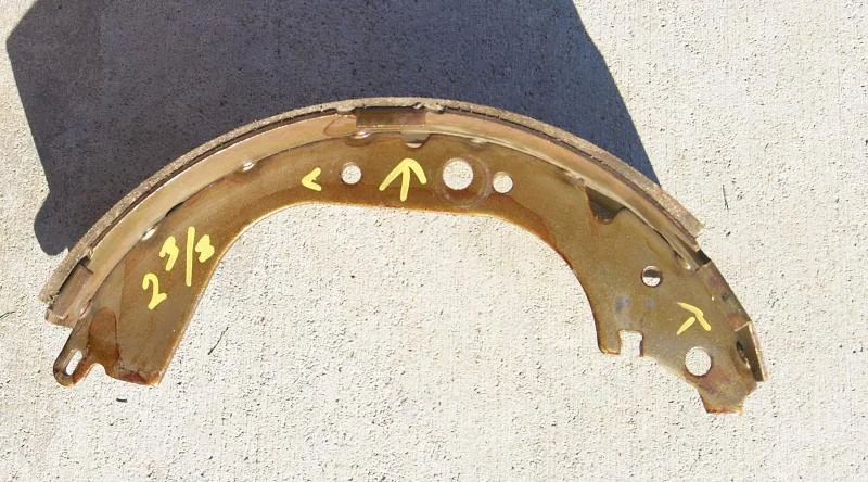

Anyone have a good US part number for some rear brake shoes for a 1982 FJ45 non US model full float.
Shoes are 2" 3/8 (60.325mm) wide x 11" (285.75mm) diameter. Keep finding PN 's with #549 or #346 but no sizing info. I sure I will find them with time just nice to cut to the buy instead of the search.

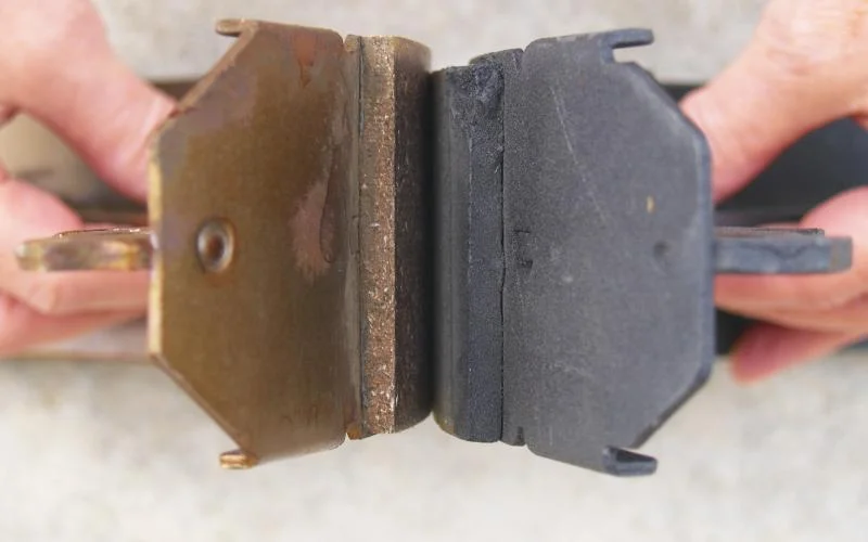

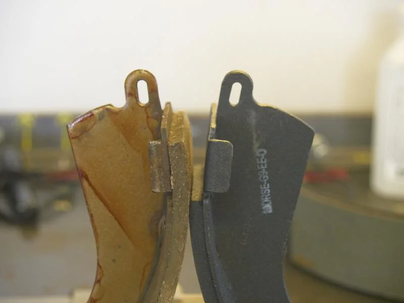

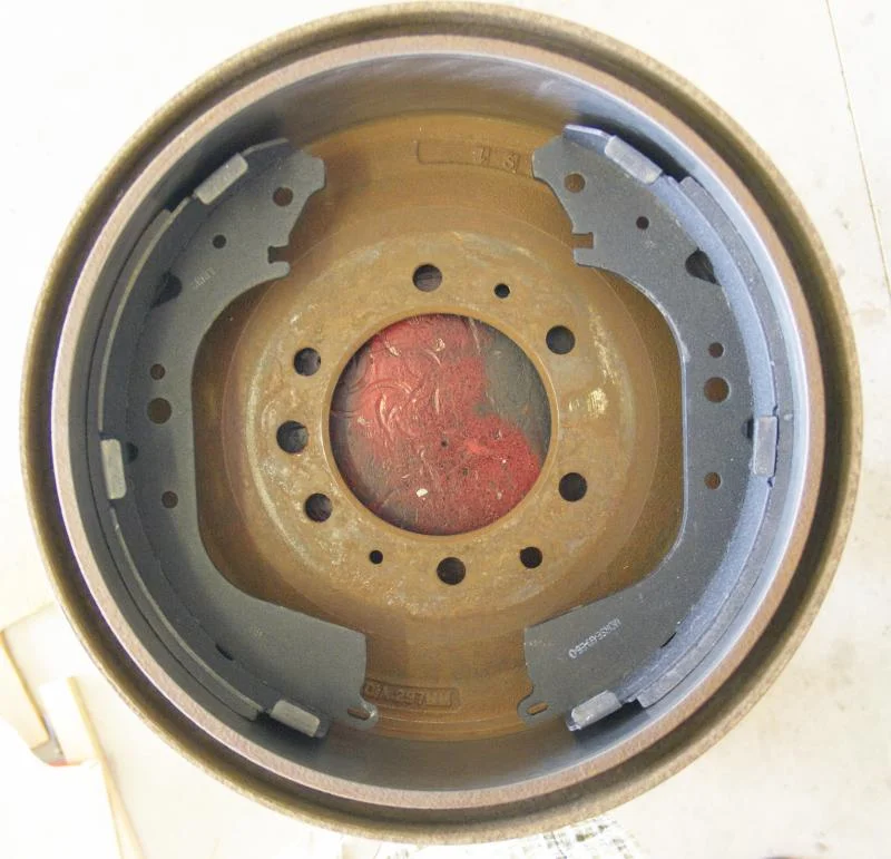

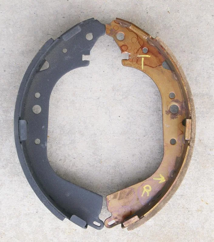

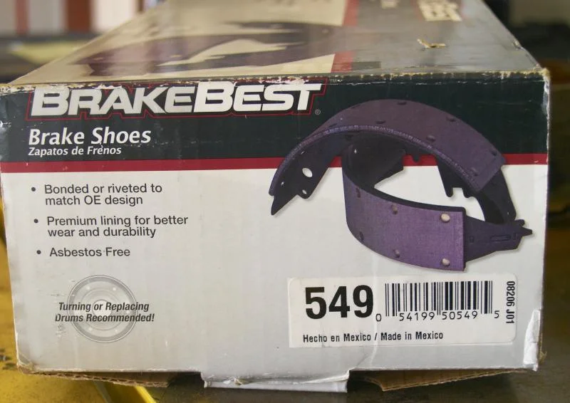

Well guys looks as I kind of found some that seem to be okay but for a couple of issues. Found a set at O'Reilly auto parts thanks to a PM sent to me. Now they are not top quality @ $18 and some change but will work until I find a better set down the road. Made in Mexico, with a PN of 549. When looking at them they look almost the same but when compared to the old Toyota set the pad in shorter at one end and the pad is not as wide on the frame as the Toyota but the metal frame of the shoe is pretty much on. This is not a big deal but shows that its is at the lower end of the septum. I went with these due to none in town and had the drums off already. Anyway looks as they are available but I going to check Bendix and few other top names later. Hope this is a help to others that are in the same boat as I. Thanks :popcorn:

whitey45, yes it is worth it to know that the latter FJ60 used pretty much the same brake shoe in the rear as the 45s. I am going to check with the Toy dealer and get an Idea of if they are available and cost. Also got a PM saying Bendix had the quality after market shoes sets and said that the number 549 was a common aftermarket number for Land Cruiser sets.

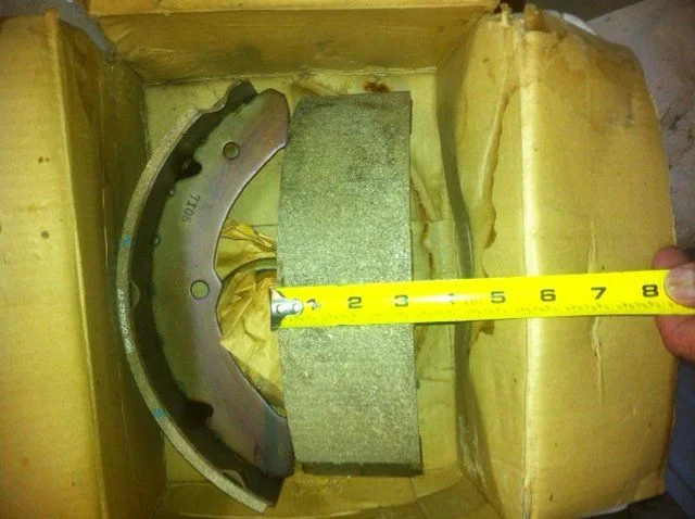

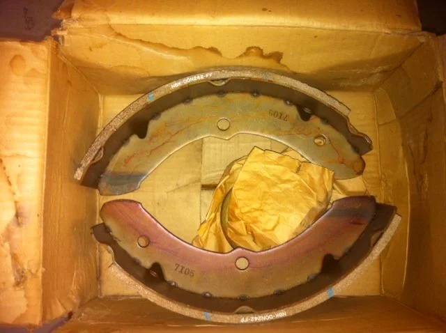

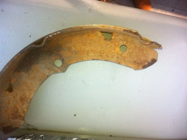

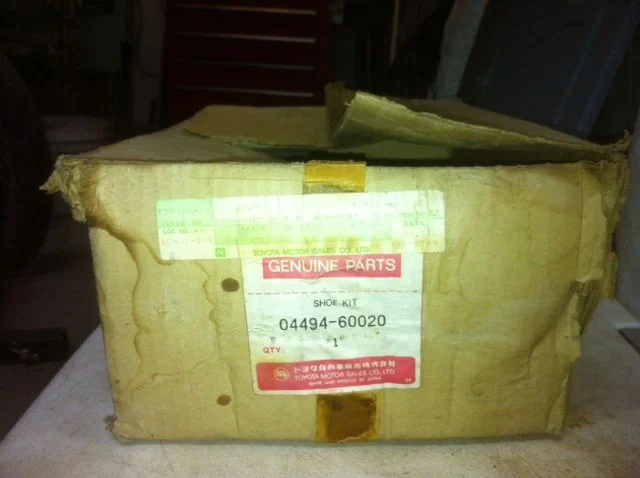

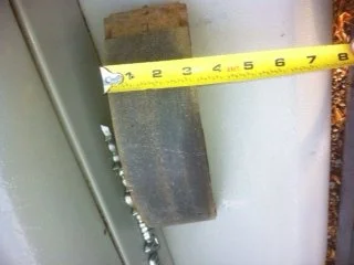

When I bought my truck 13 years ago, it came with a new OEM set of shoes.
I have since put discs on the front and have very seldom had my rear brakes adjusted properly.
Last summer while changing the wheel bearings I replace the rear shoes.
These are the shoes I used. Well actually, this the pair that is left over.

They are the front 3" wide drum shoes that I had also and I to put disc on the front due to the high cost and the difficultly of finding the front shoes. I think that number now ends with a 21 instead of 20.:cheers:
K are they for sale?
