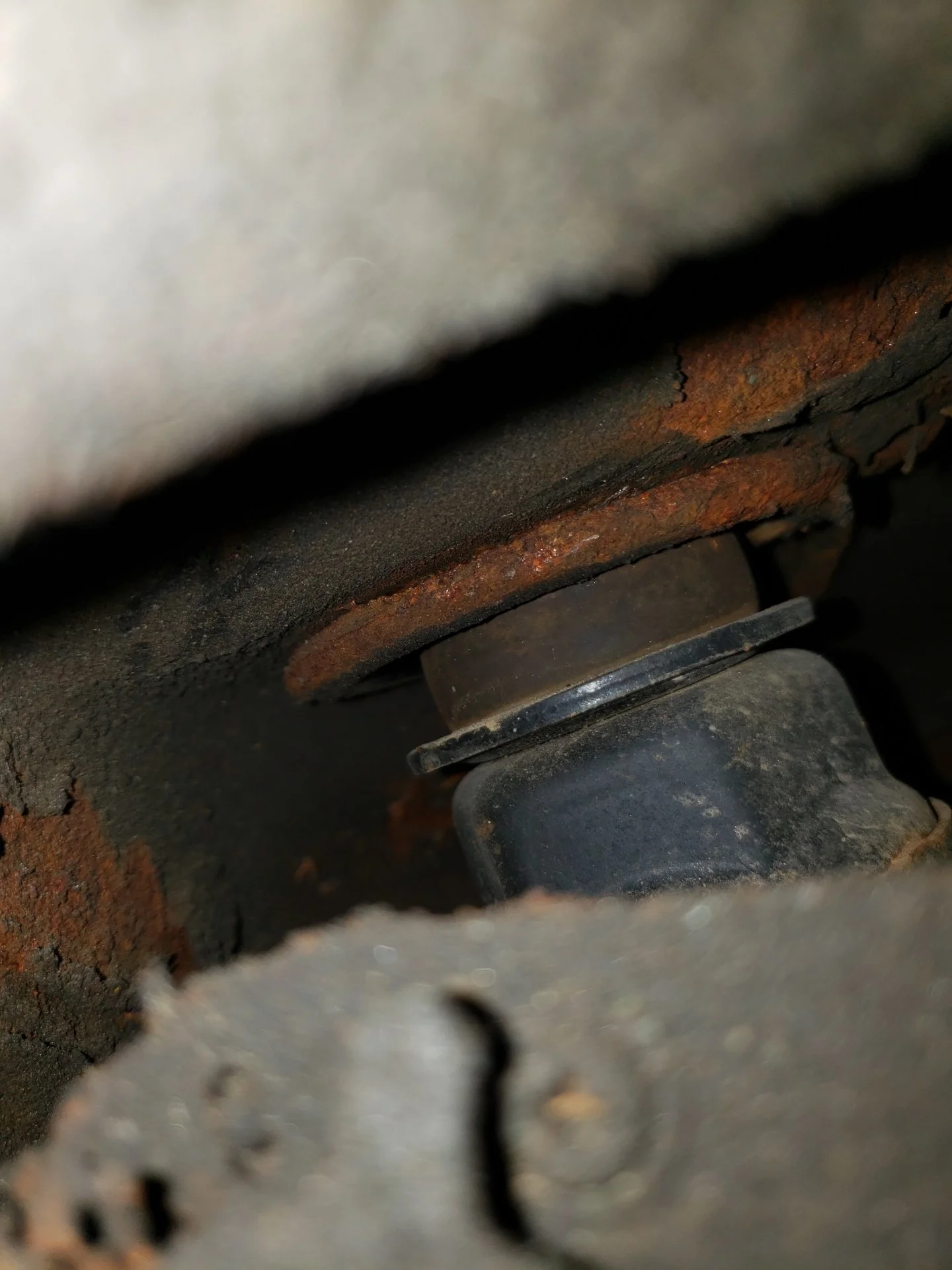

Here is a new pic. Unfortunately, this was as close as I was able to get to.
Try to get a similar pic from above the crossmember that the top of the shock goes through. There is a narrow space up there.
The shock looking cleaner than the surroundings is encouraging, but the clean/smooth section sticking out the end of the shaft or lack of it is the way to tell for sure.

I'll get a pic this weekend.
