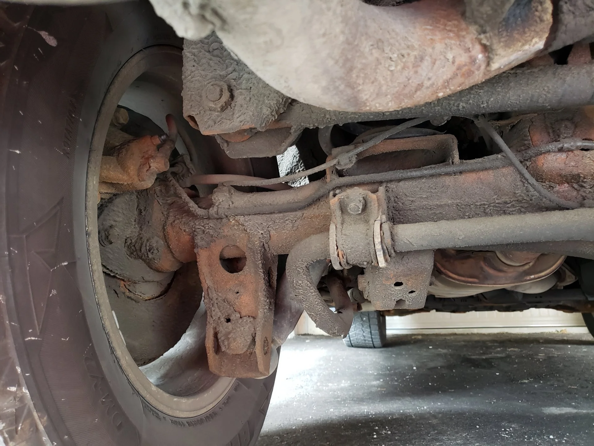

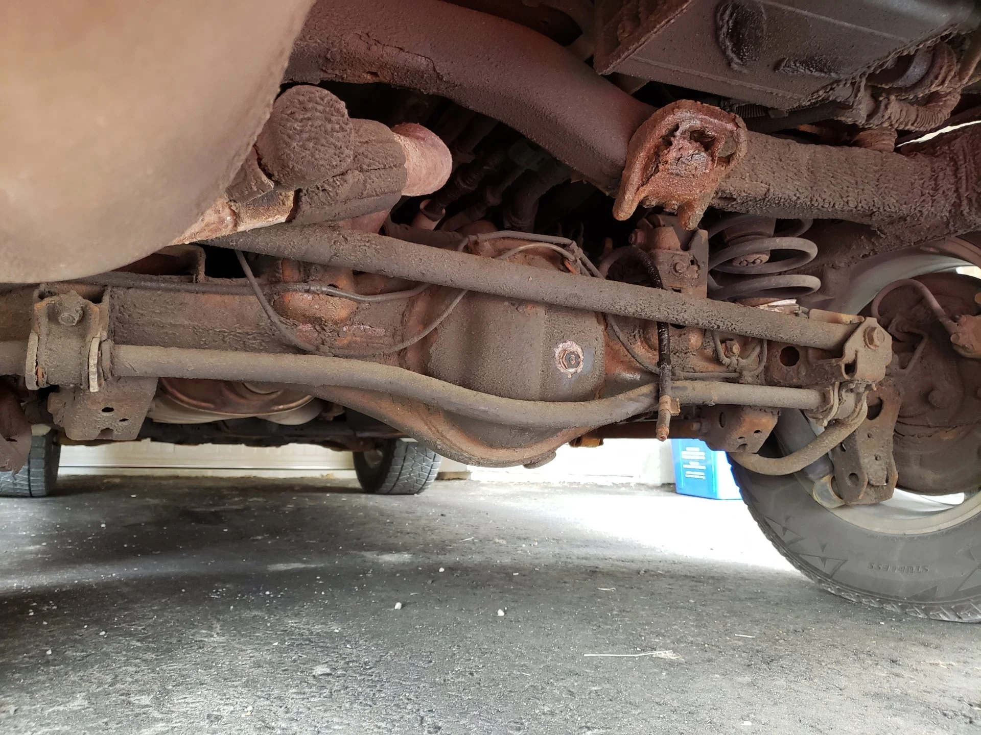

Yes, get pictures from the back of the axle as well.
Hope these images help, and also, huge fan of your builds. Definitely very inspiring!!

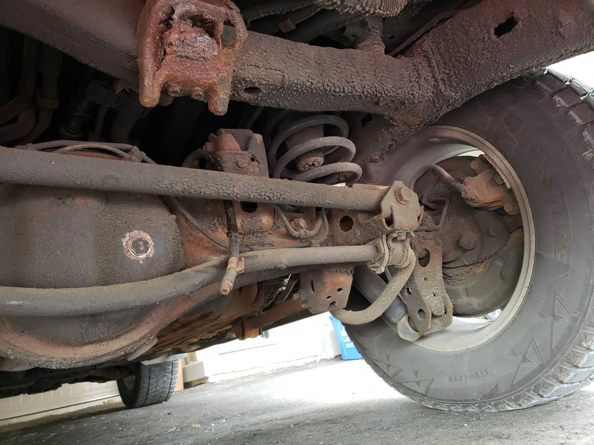

It looks like your diff breather is flopping around... probably worth finding a place to mount the end closer to the undercarriage while you're poking around down there. Obviously, not related to your problem.

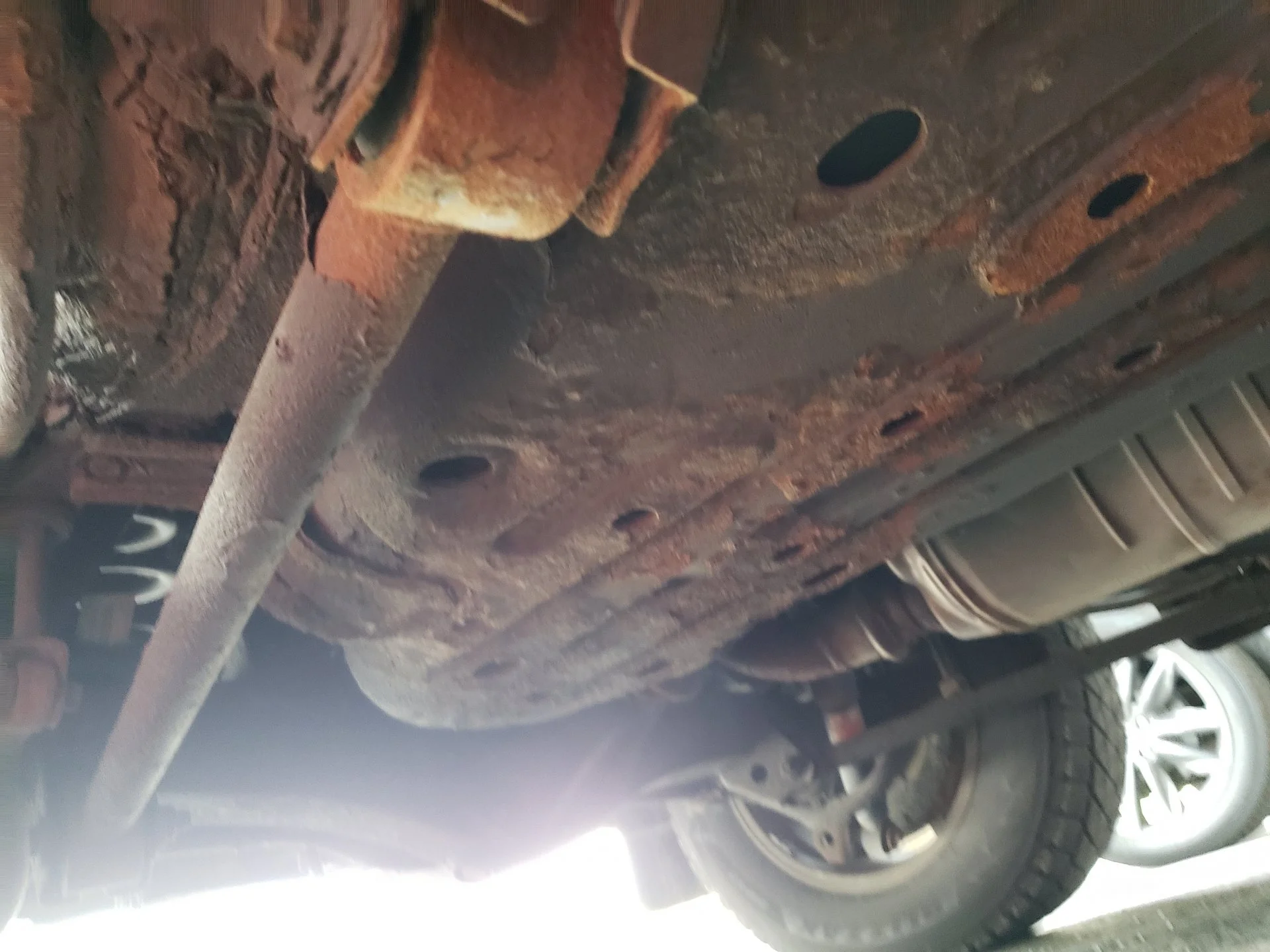

I don't have much experience dealing with that amount of rust. My inclination would be to start poking around and scraping to see how much corrosion you're dealing with. There are a lot of components that need further inspection...
Definitely check all bushings and tightness of bolts in the control arms\panhard bar and swaybar.

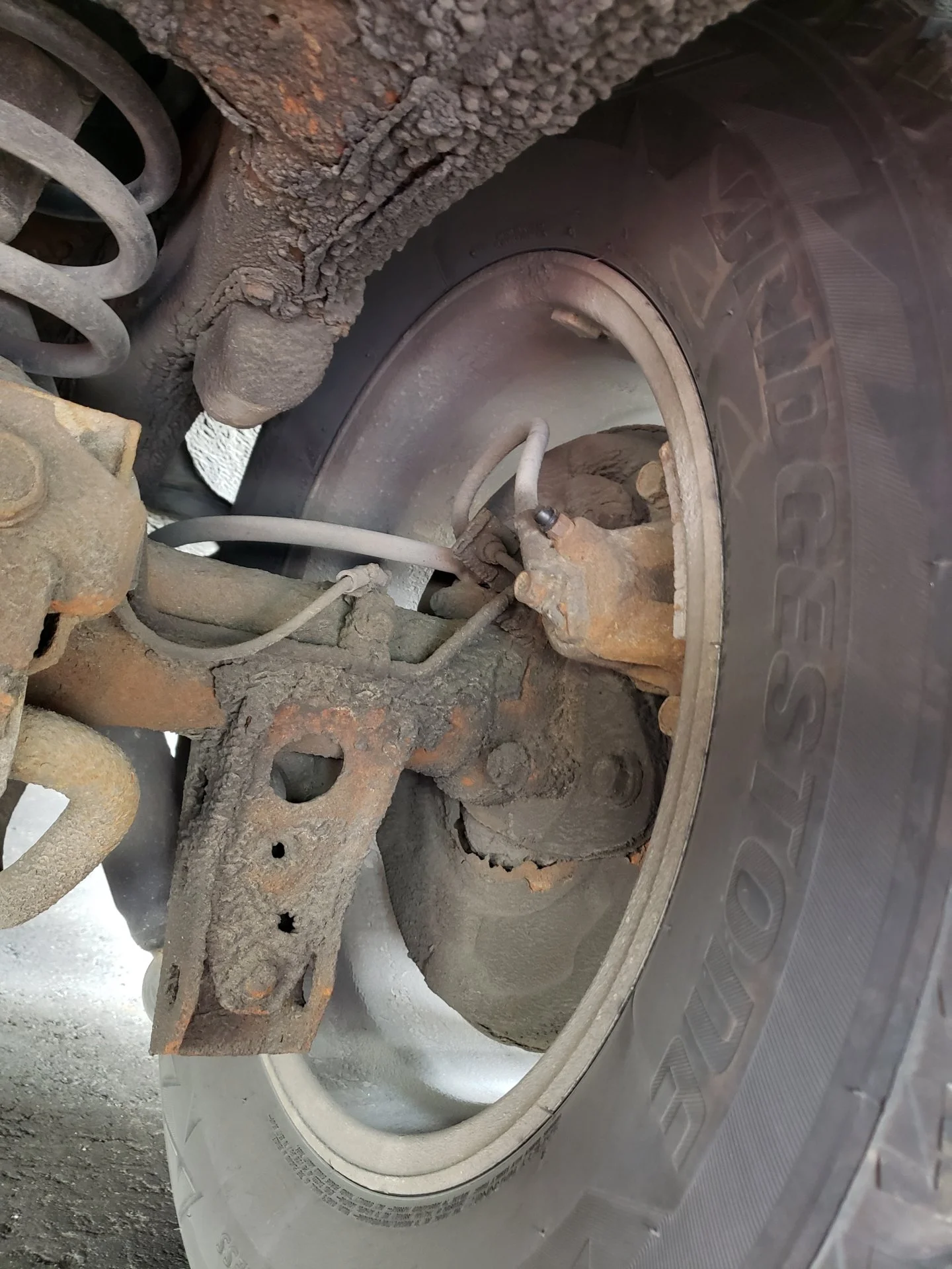

I see your diff breather is broken and not mounted, the brake backing plates are rusted through too.
What happened under there?
I see a ton of rust, but wow. Can you tell us about the massive build-up of material crust? Is that rust? Almost looks like it drove through wet cement for several years. What happened there?
I thought maybe it had been "undercoated" sometime in the past and it has failed over time.

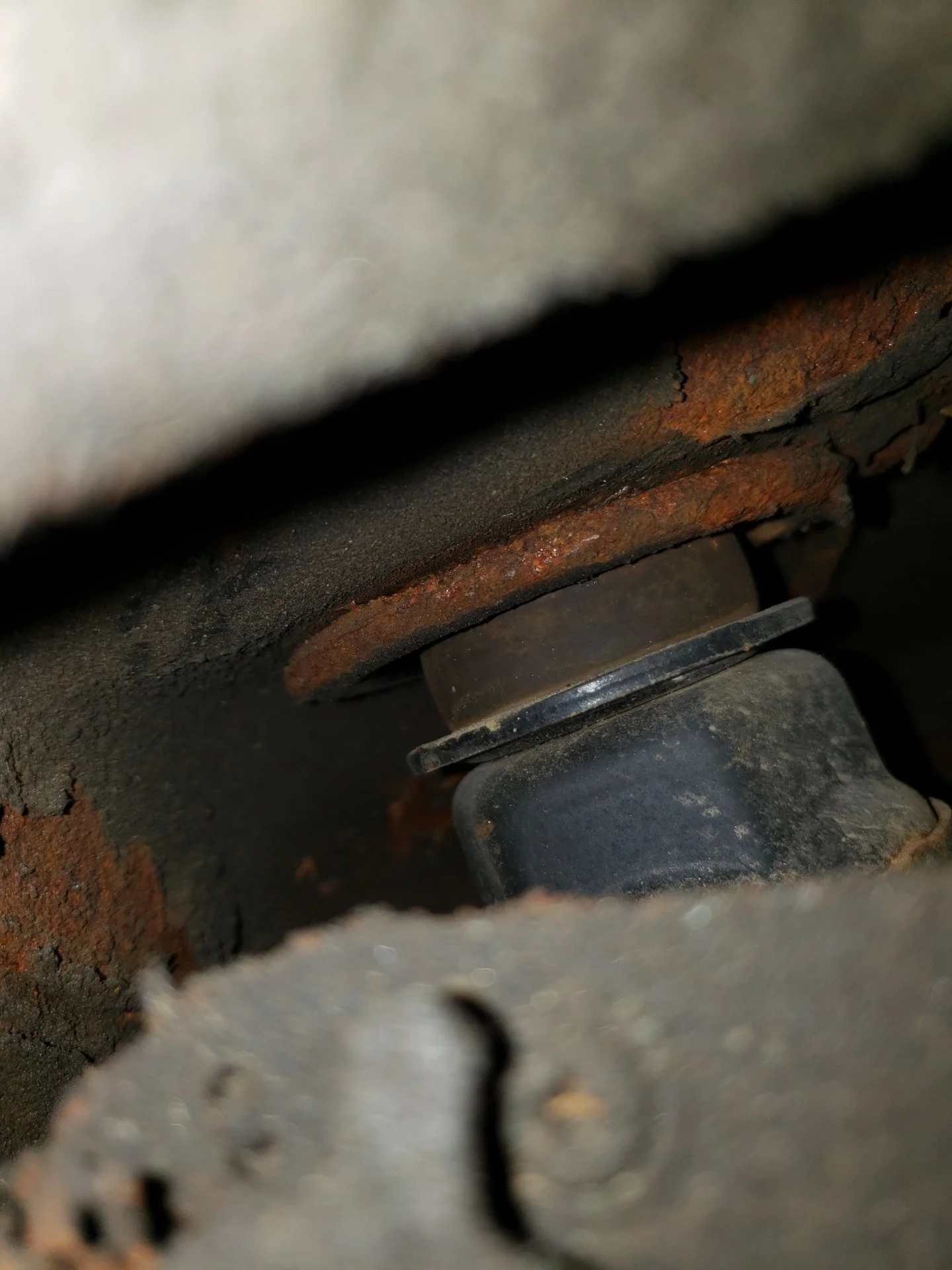

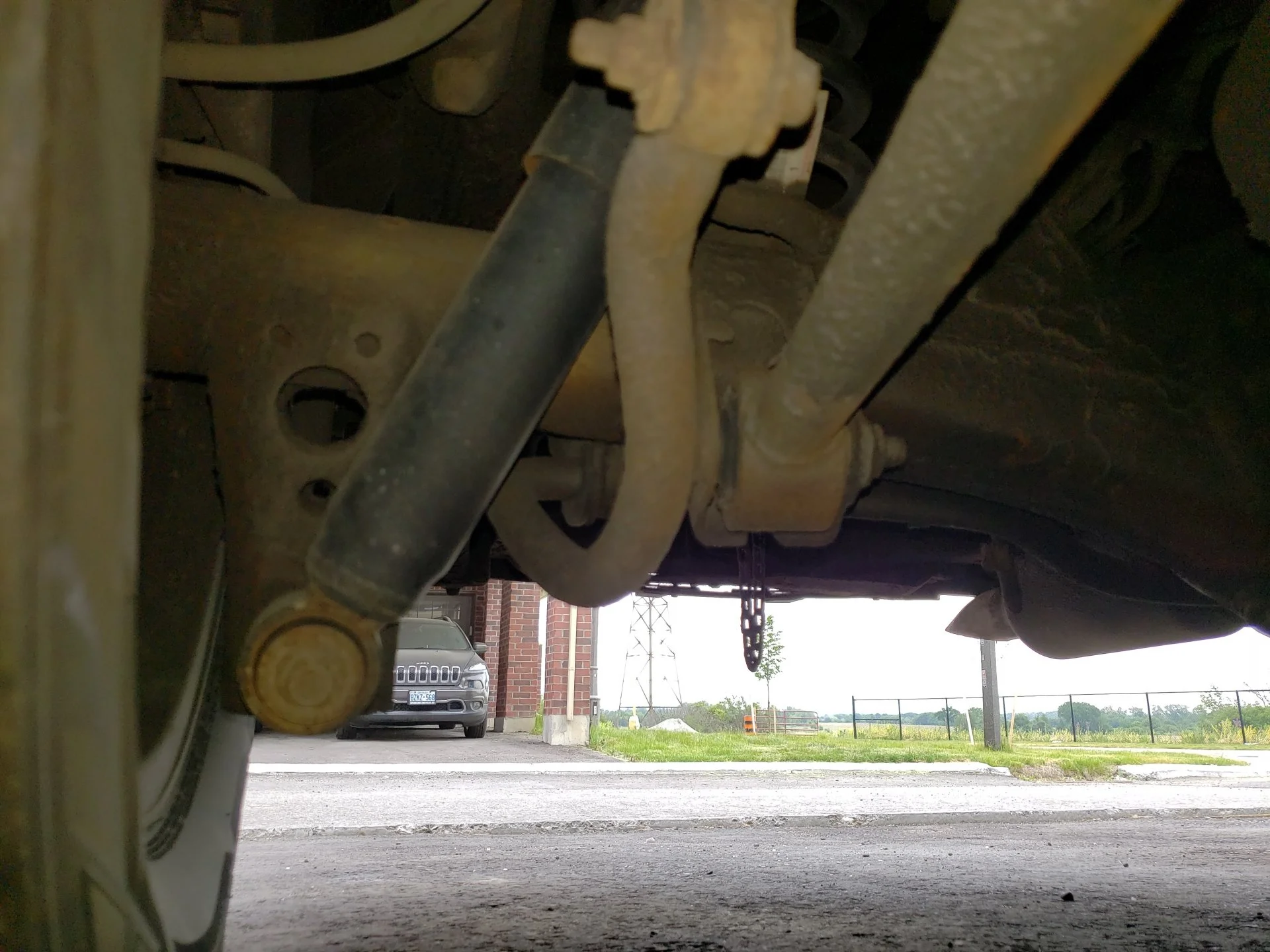

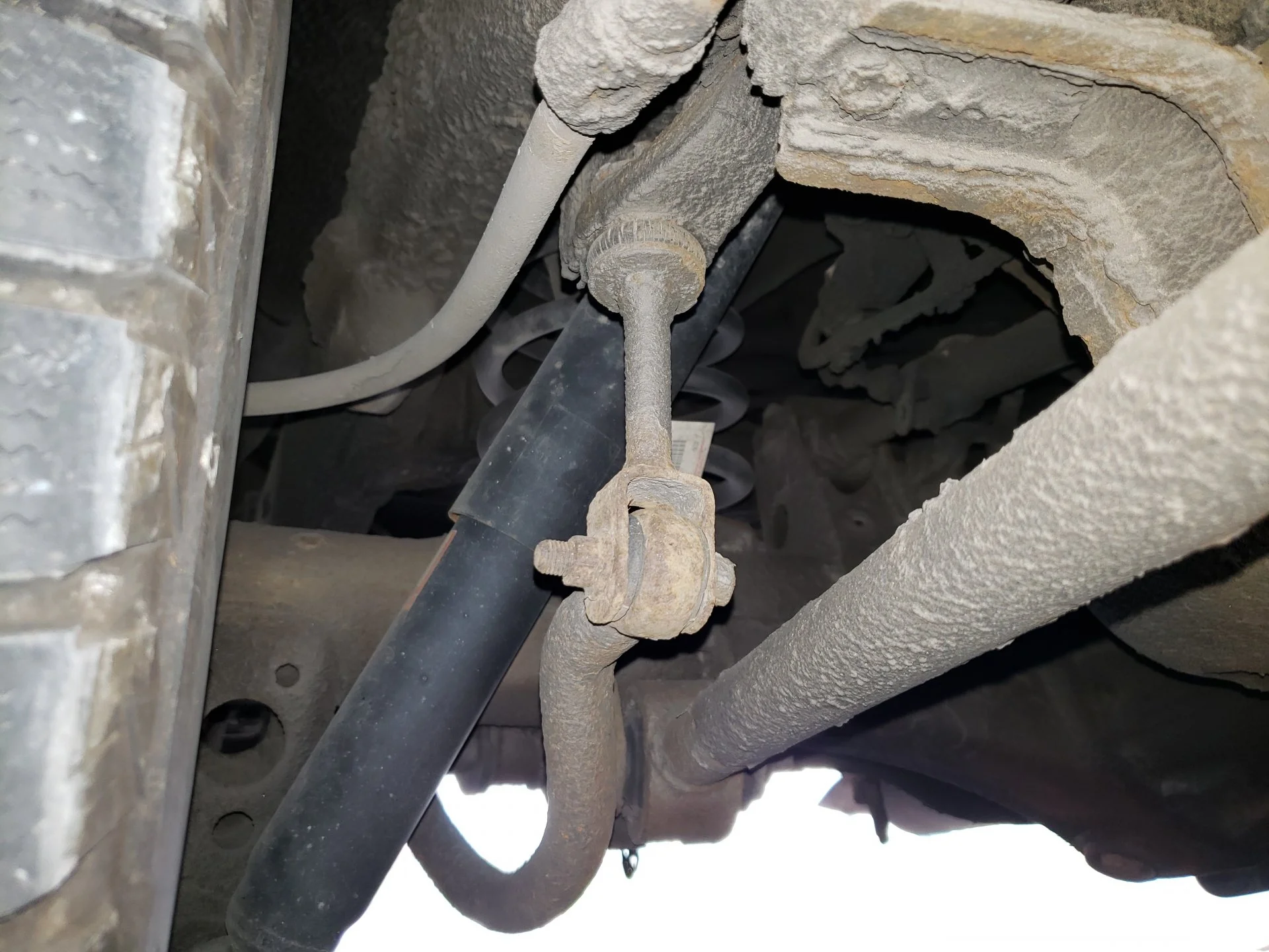

I could be wrong but this picture suggests that this may be the original AHC shock based on some minor details and level of corrosion. Is it possible they didn't replace the shock with gutting of the AHC suspension? Which could lead to your symptoms of rear sway due to inadequate (no) damping.
Can you take a picture of the top of the shock? There would be a hydraulic tube/fitting at the top that would clearly identify this as an AHC shock. It may be tough to get a picture of it.
That is nasty. The brake backing plate has a rather large hole in it. I would be curious to see how serious that rust is . Panhard bar and shocks need to be looked at first. Are the tires properly inflated? Sway bar end links attached at both ends ? Look at all 4 of the rear axle arms and make sure they have serviceable bushings. Make sure they are not sitting in broken mounts based on that amount of rust.
Thanks for the feedback. I'll make note of the breather. Yea it is a lot of rust, and I'm trying to figure out the best approach to clear all of the crud to see what's underneath.
Years and years of rust proofing, 13 years to be exact, and there's also rust. Hard to say how much is hiding underneath.
Here is a new pic. Unfortunately, this was as close as I was able to get to.
