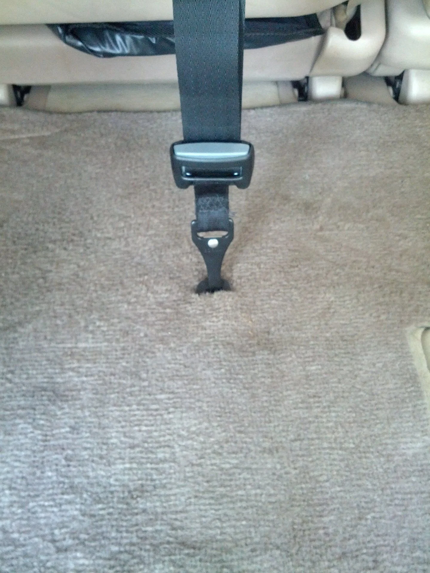

My 1998 does NOT have the tether anchors and I'm currently using the cargo clip:

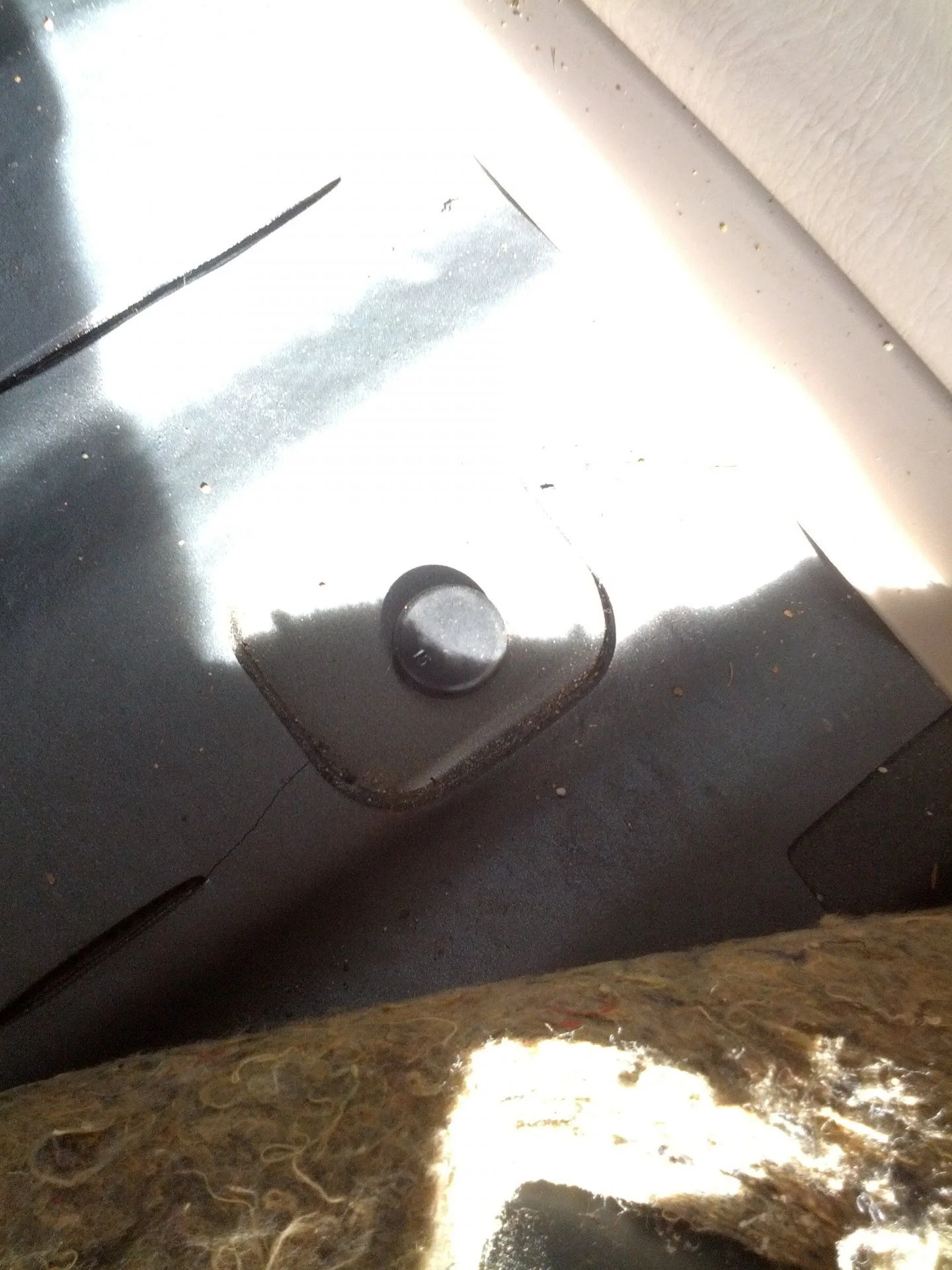

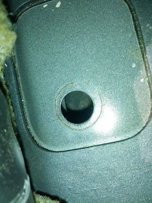

Under the carpet is a plugged hole:
Just in case you haven't pulled the cargo carpet back, this is how its secured:

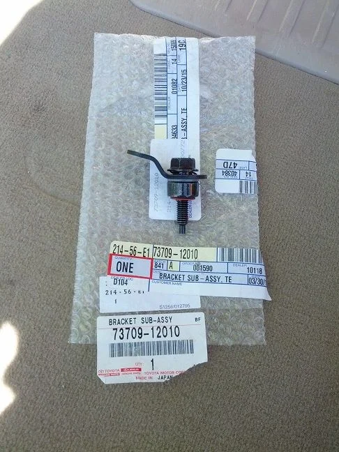

I picked up the tether anchor today:

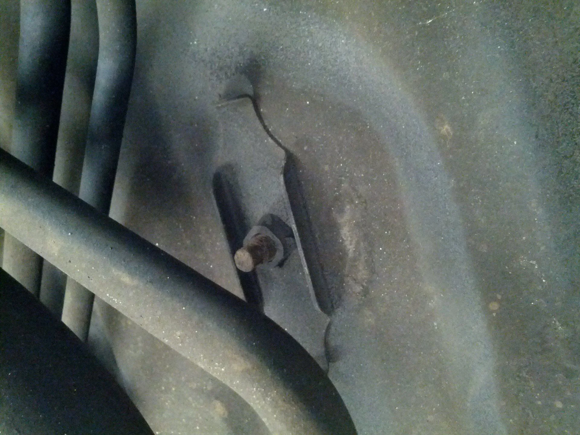

Then pulled the plug (shoulda pulled plug earlier in the week....) to find just a hole, no welded nut on the other side:

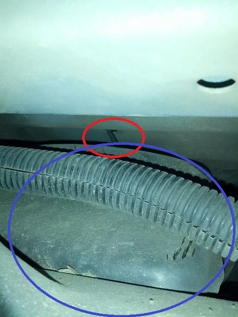

Then it took me a moment and the help of a four year old with a flashlight to find the other side of the hole. The outer holes are above the coil spring housing. I have a screw driver circled in red and the coil spring housing circled in blue:
Not sure what the proper course of action is at this point and could use some advice.
Do I get a quality nut, washer, plate for the under side and try to mount the tether anchor above the coil spring or go with the center (we have three kids, two in boosters, one in a car seat)?
Or keep using the cargo hold down for the tether?
Or use the third row seat anchor?
TIA.

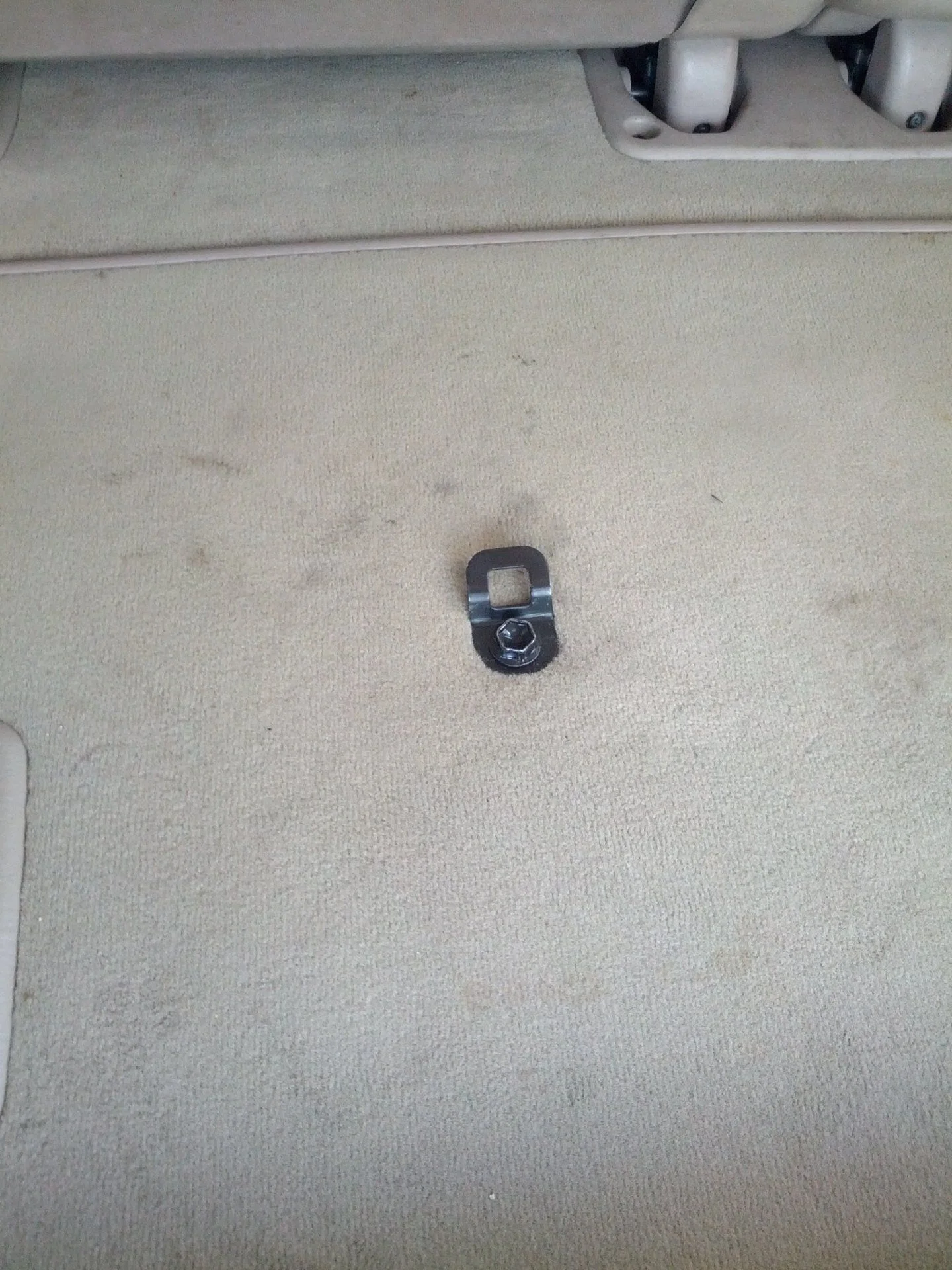

The 2004 came installed:
I didn't find any parts for the welded nut so I did this instead:
Up top installed:

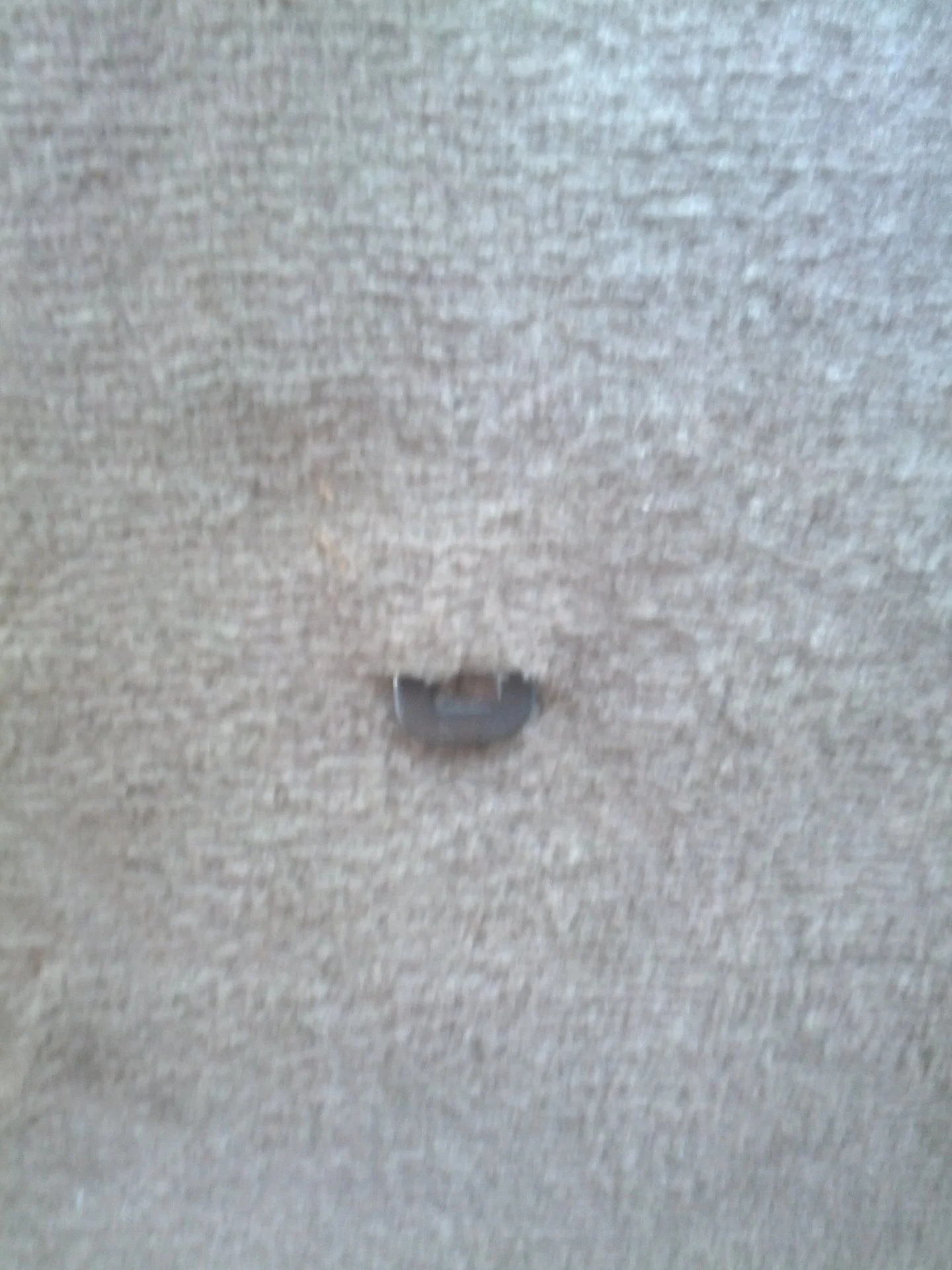

Cut a slit in the cargo cover (it already has big holes in it for the third row seats):
Then installed the mat pushed closer to the front of the truck and slid it back:
Attached the tether (I moved the seat to the center, I was lazy and didn't want to mess with getting the tether anchor installed on the outside):
I know this isn't factory, but has to be somewhat better than no tether anchor at all, no?

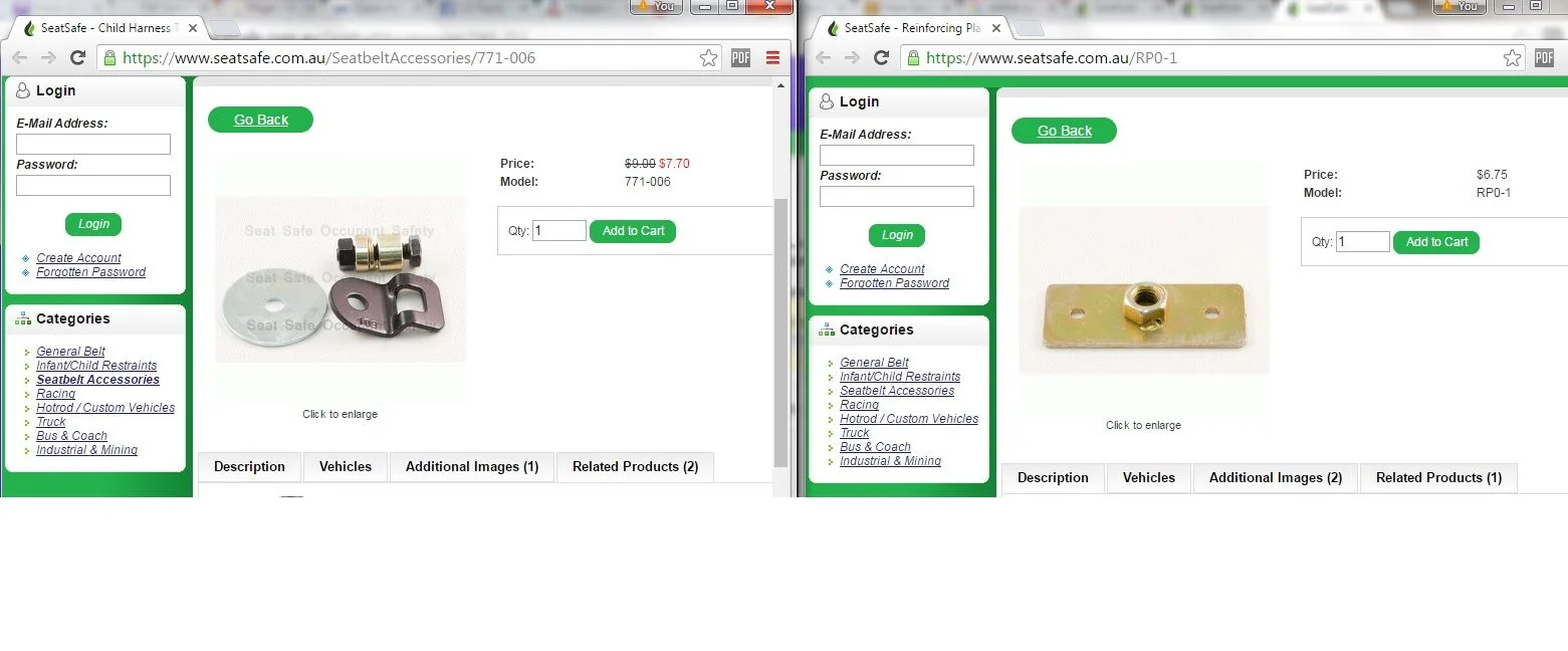

I just used a piece of steel I had in the shed about the same length/width(but thicker) of the plate on the 2004. If I were to do it again, I'd try to source something like these:
SeatSafe - Child Harness Tether Anchor Assembly Kit
and
SeatSafe - Reinforcing Plate for Child Restraint

@camino70 thanks for this post and putting me on the right path! Finding the pre-drilled holes was a big step.
I ended up getting the kits from the Australian site (seat safe). However, their tether bolts were too narrow and did not fit the pre-drilled holes in my 99. Looked great online though so I thought it was worth a shot.
I ended up ordering the factory tether bolts, OEM nuts with an integrated crush washer to prevent them from spinning, and using the 3mm thick washer as a pull through backstop from the bottom.
SeatSafe wrote this to me:
Under the Australian Standards the 771-007 assembly is sufficient to secure a child seat on its own and the large washer acting as the pull through plate. When securing the backing plate under the car people use the CRP1 plate as this can be pop riveted under the panel and then the anchorage kit can be secured easily. If you use just the anchorage kit 771-007 on its own the plate/washer and nut are loose and this presents a problem for easy installation so people normally get both CRP1 and 771-007.
I have a 99 LC and I have three kids so three seats. Installing the center tether was very easy. The other two was actually pretty hard because the access to these areas was extremely limited, especially the passenger side because of a thick AC line that runs right around the coil tower cap. I literally had to use one hand to hold the nut in a wrench, long tweezers in the other hand holding the washer, a friend holding the anchor from the top And slid on the washer and the nut to put it all together.
But, all said and done I got them in, and I can sleep better at night knowing they are setup correctly instead of hooking them onto the cargo hooks which are not rated for the same amount of force in case of a collision (plus there is no center cargo hook). Definitely beats driving kids around with tethers at all, or having to sell the truck and buy a new one.
