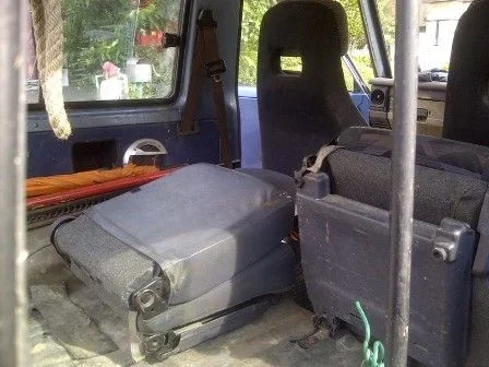

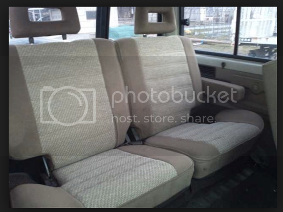

I actually purchased a set of second had seats from Pajero-Mitsu. With this option, I could split (either left or right) the seats when ever I want it, just fold half and flip it vertical, while I still get to keep my original bench seats. Hope fully attached pic gives you a visual...

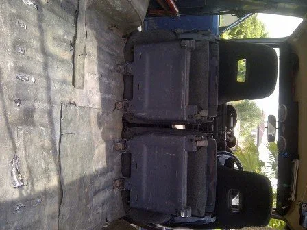

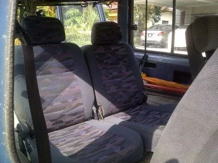

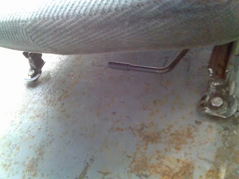

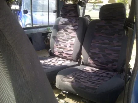

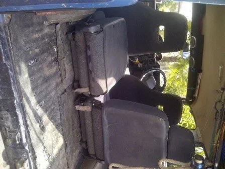

Here it goes,
Viewed from driver side, rear seats open up
Viewed from rear, rear seats open up
Viewed from passenger side, rear seats open up
Per installer, the seats were still original upholstery.
Rear left seat folded, Rear right open up
Rear left seat folded, rear right seat folded & flip vertical.

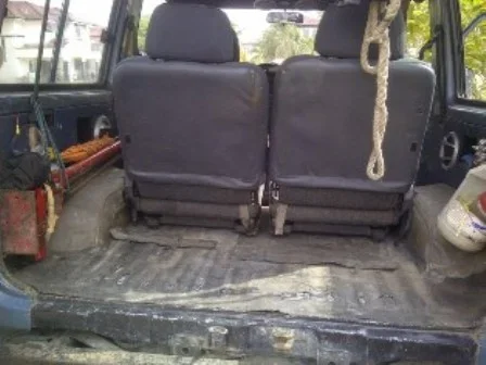

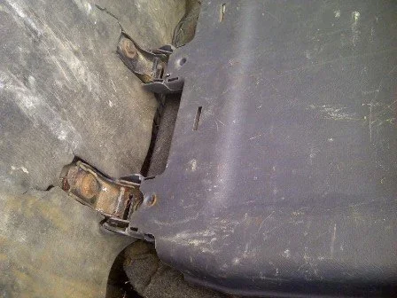

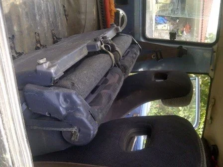

continuation,
Viewed from rear, both rear seats folded and flip vertical
Viewed from side window, both rear seat folded and flip vertical

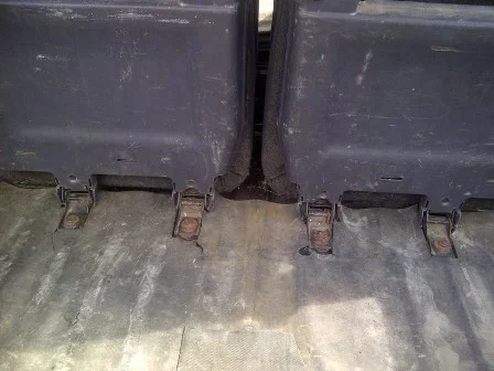

Both seats bolted down, two size 14mm on for each seat.
Closer view of size 14mm bolts.
they are actually REAR seats from Pajero..... NOT front.... each seat with 2 nut & bolt, acts like a hinge.... Will take some pics this evening and post...
regards,
helimanBD.
Jimmy2,
If you look closely at,
"Viewed from rear, both rear seats folded and flip vertical",
there are 2 "RINGs" on each side mounted to the floor board close to edge of wheel hump. You can either run a steel rod thru the bottom rear seats and hooked it to the RINGs or just latched them down.

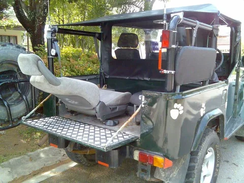

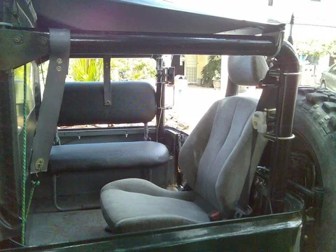

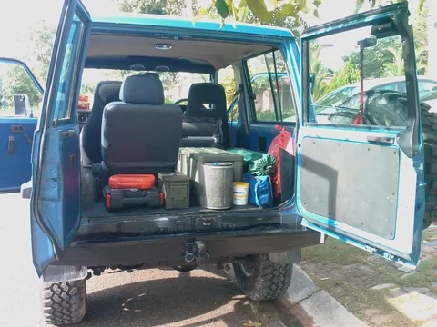

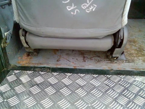

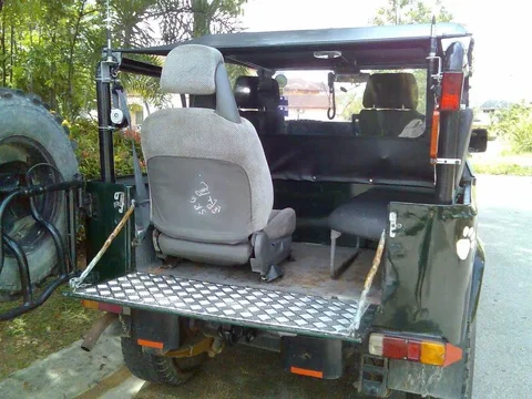

Perhaps these pics will give you another option, assuming you do NOT require to flip the single seat vertically like previous on 1989 LJ70. Like yourself, we have only 1 daughter and could make use of the extra space when mount a single seat at the rear of the small rig. Below was done on my previous 1981 BJ40. I re-used an old SR4 Honda front bucket seat for it.
Have fun sourcing.
regards,
helimanBD.
