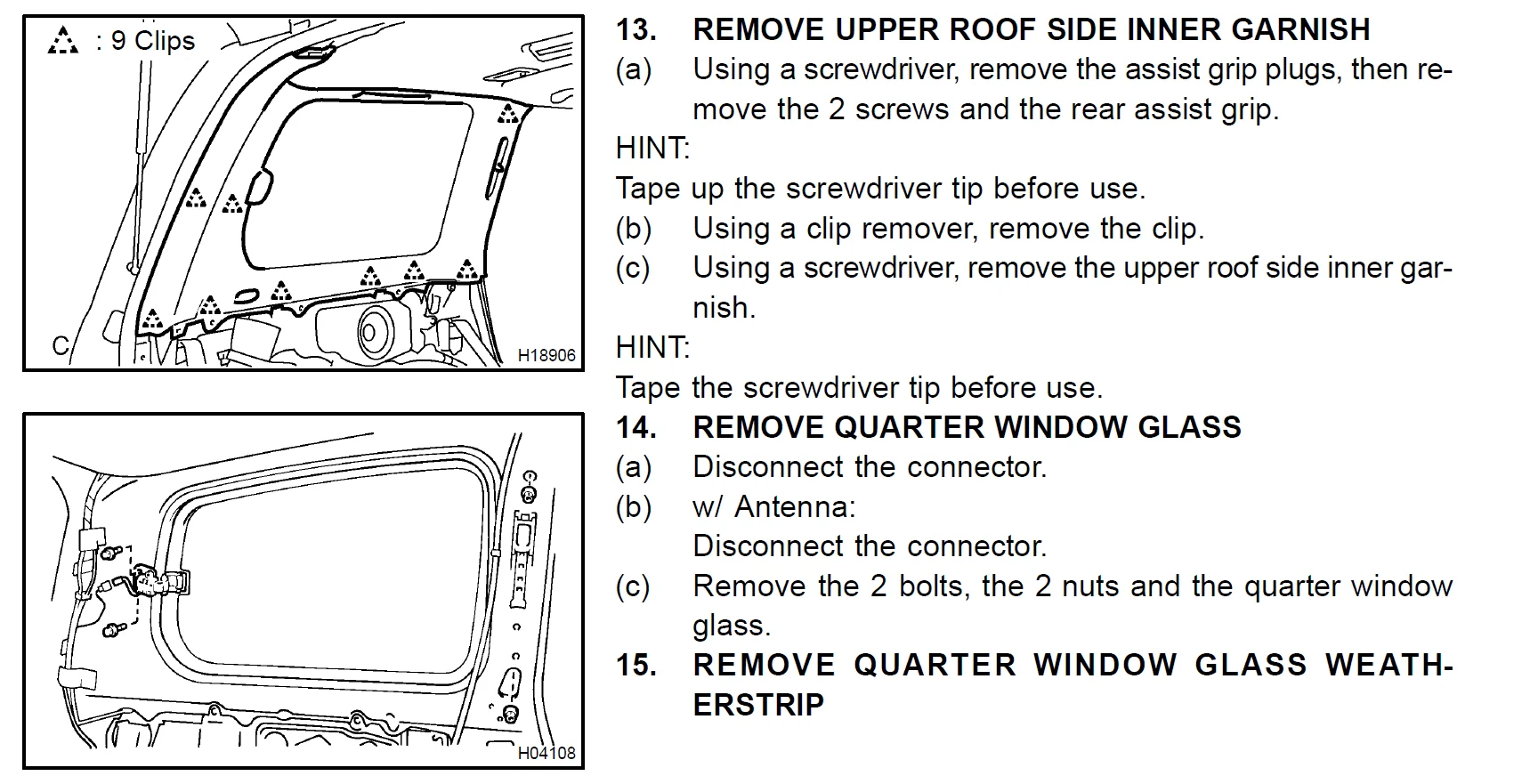

How do you remove the rear quarter window (the one that's motor operated)
Found a replacement and need to go pull it in a couple hours.
