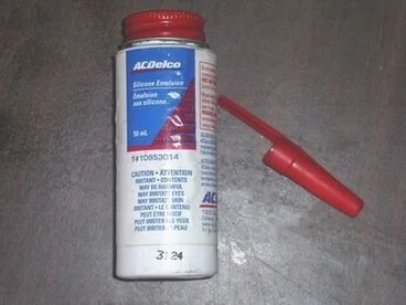

Here is the paste. It has an applicator as part of the cap. I used Q-tips as well, to work it onto the track, putting it on fairly thick and letting it soak in for a bit.
hth's
