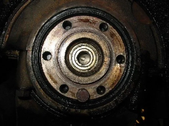

And since a picture is worth... This is what a leaky one looks like.
