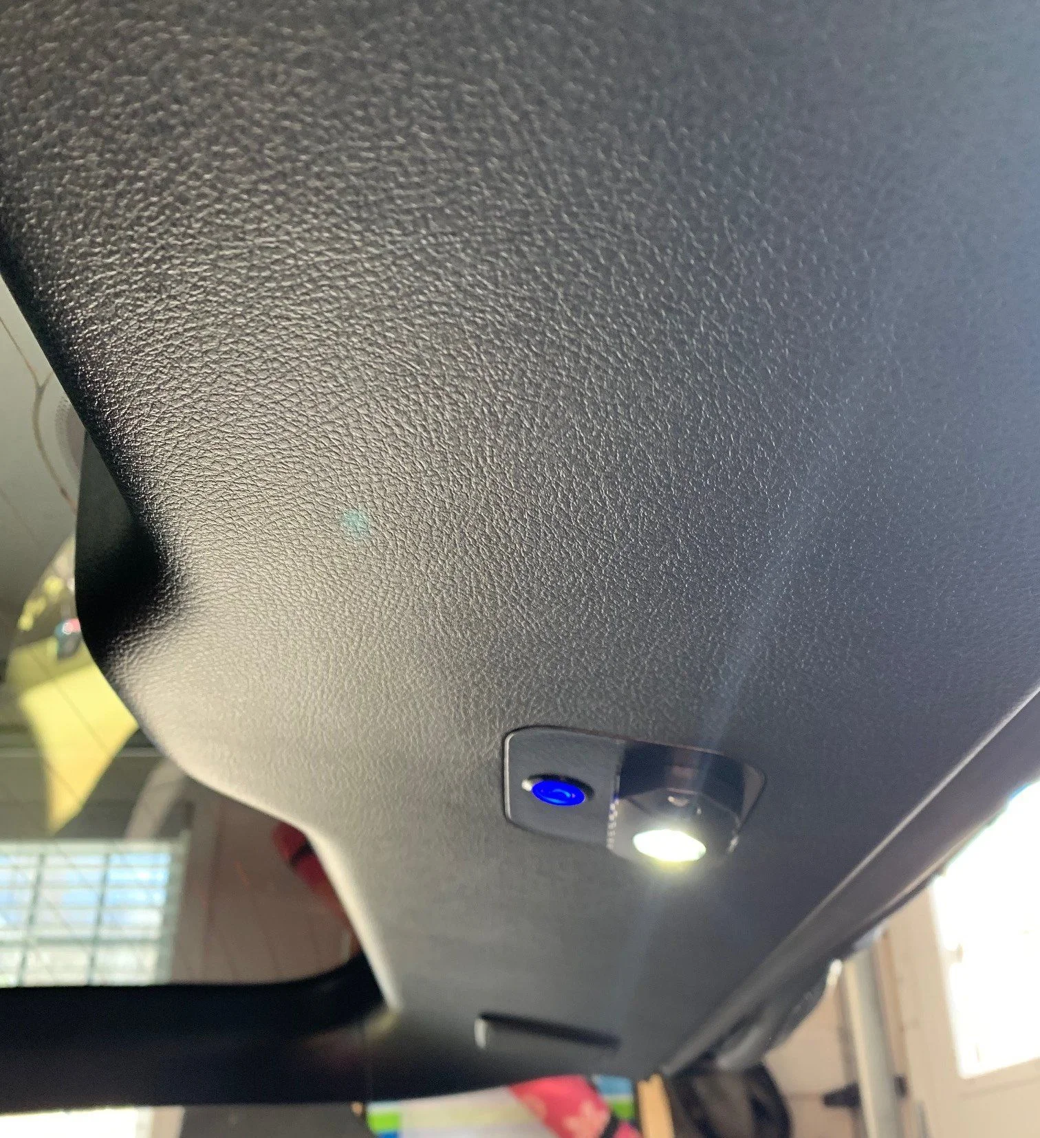

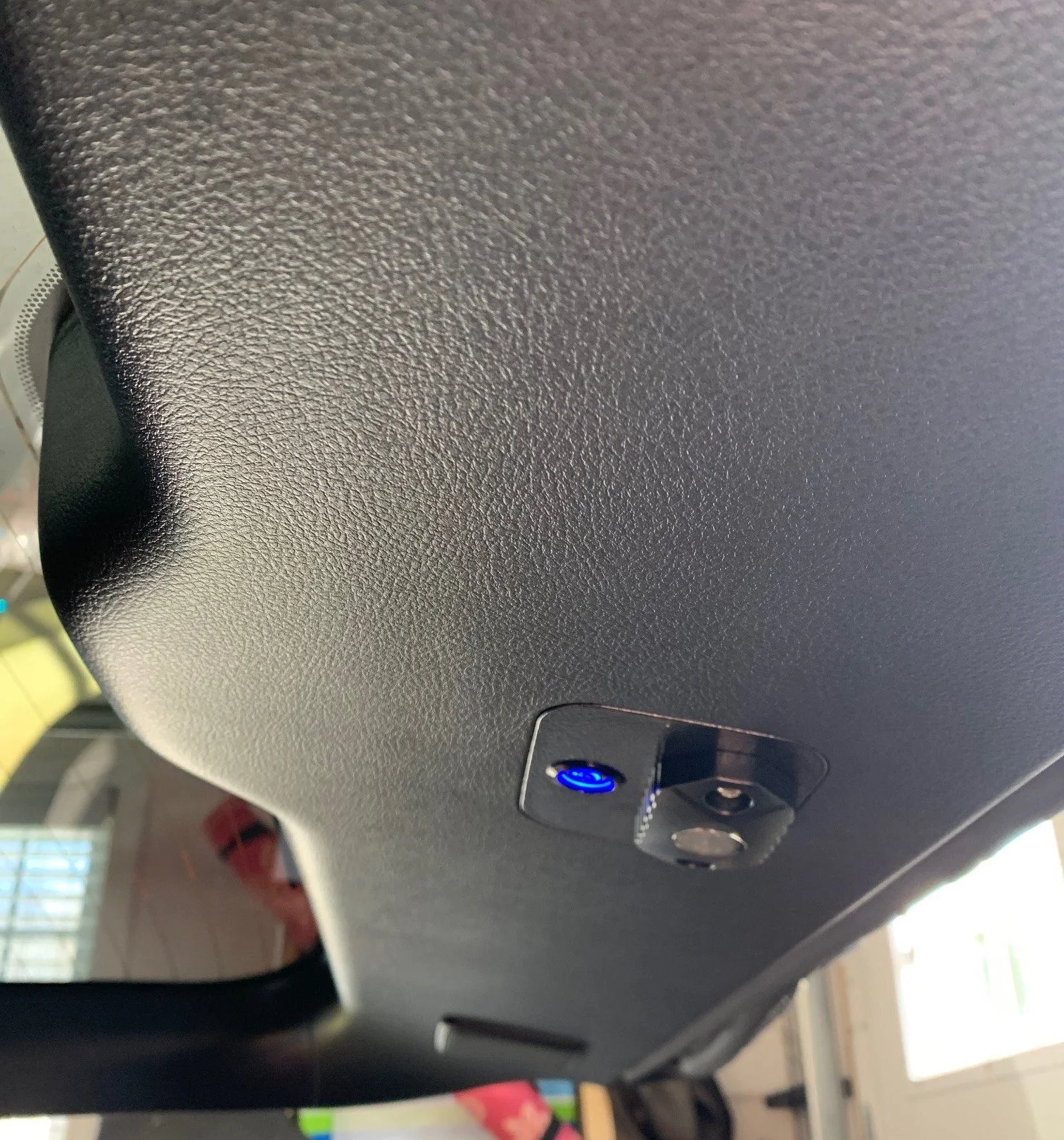

I got the light installed and it's VERY nice. Great job on the design @Brendan! I did paint it black and tried to match the black cargo color as much as possible, as well as the speakers on each side that are slightly more satin in color. I am not too picky, but I think it came out great. The light was super easy to install, here are a few notes from the install:

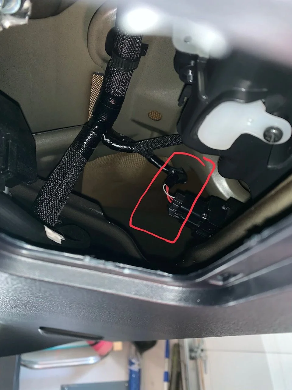

1) The opening is small, so luckily my hands are not too big and I could just barely fit them in there. If you have bigger hands, I think you may need to take off the trim. Take a look at the connection with a flashlight to get an idea of how it looks before you go in. The tab is closer to the where the wires are located than I thought, and when you press it in, it comes out fairly easily. If you are struggling with it and can't press anything in, go closer toward the wires. Here is a photo:
2) Once you unplug it from the power lift gate switch, you just plug that plug into the one on the light wiring harness, and then plug the light into the power lift gate switch. Its very easy! I then pushed the wires inside and ziptied the excess to keep it neat and tidy (I am a bit OCD ). It works awesome - turns on when you activate the lift gate and turns off when it closes. Here are some photos of the final product:
Let me know if you have any questions!!!
