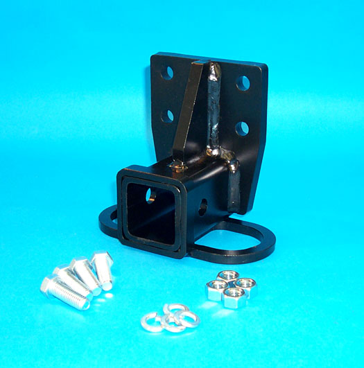

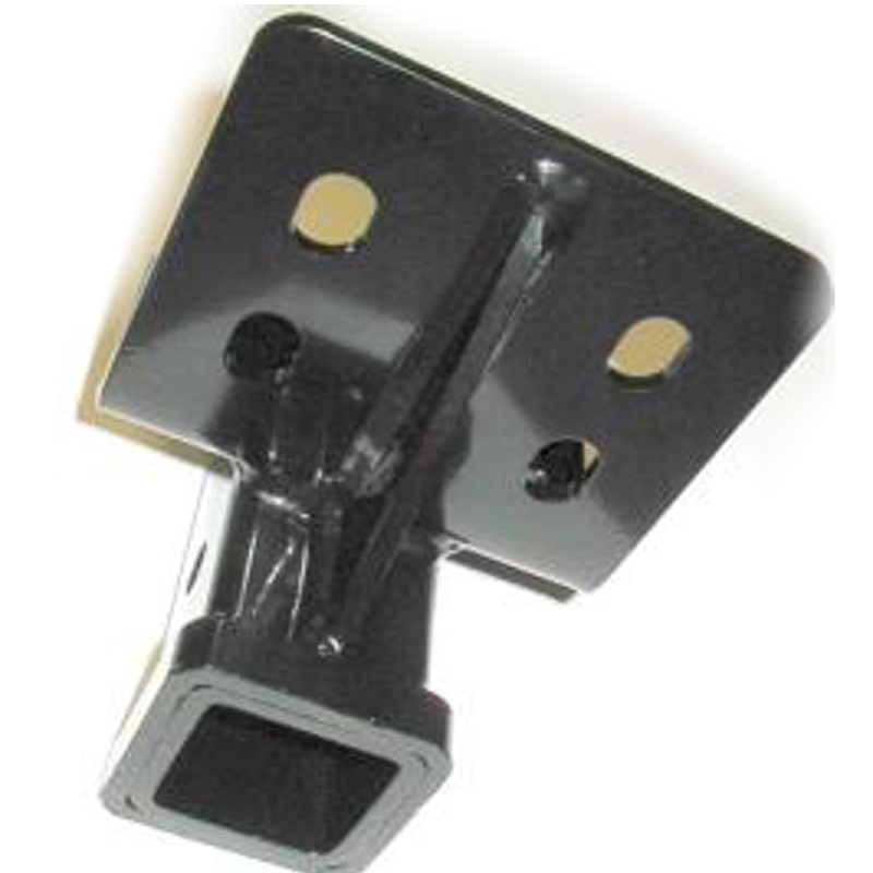

I know that this has been discussed lots before. Everyone seems to have a different take on it.
I can't find the 4 bolt receiver on Cruiser Outfitters. I did find a couple of others, though.
Receiver Trailer Tow Hitch Toyota Land Cruiser FJ40 hard top powder coated FJ80 – JT Outfitters - https://www.jtoutfitters.com/product/receiver-trailer-tow-hitch-toyota-land-cruiser-fj40-hard-top-powder-coated-fj80/ (I don't know if this one comes with bolts?)
Has anyone bent their crossmember using one of these? My FJ80's crossmember seems like it was dinged by something. Not quite sure how well things would line up on it, nor the strength, or if it'd be minimal.
Would using one with a motorcycle carrier be unwise? Quite a bit of weight. A lot of people seem to think that if the trailer doesn't need brakes, it should be fine.

I cringe when I hear about people towing on the 4 small bolts that hold that hitch on !
But Let's use @Malleus example. a properly loaded trailer would have about 10% of it weight on the hitch. In this case 2 tons = 4000 LBS so 400 LBS on the hitch with no extension /cantilever.
Now lets say you want to carry a motorcycle, you now have the weight of the rack and the Motorcycle. I use a Versa Haul It has a 500 LBS carrying capacity and weighs 90 LBS and it has a 30" extension.
So you can see where I'm going with this, The Slee one is not rated for towing and the second has a 200 LBS tongue weight rating. Even with a small motorcycle you will easily exceed the safe working load of one of those hitches.
FWIW, the bolts holding mine on are 14-mm, and there are four of them. The shear and tensile strength of that connection exceeds the rated load of the hitch by a factor of ten. Back when I got paid to design structural steel connections, that was considered good.

I have 4x 12mmx 1.25 10.9 JIS flange bolts holding mine on bolted through both the frame attachment points and a Delta bumper. Tensile strength on a 10.9 is 150,000 PSI. Single shear (each) is 33.7kN (7,576lb). Shear on the assembly is 30,304lb. I wouldn't be worried about the 4 bolts at all ... what they're bolted to is quite another matter. Failure point would likely be the frame attachment under shock load, not the hitch itself or the fasteners.
All this said, I don't use mine to tow with. It's solely a convenient center mounted recovery point. If I was going to tow I'd configure some kind of triangulated draw bar back to the frame on both sides similar to a couple of the pictures above to resolve the longitudinal forces better.
Yep. Those bolts have a small vertical offset from centerline which will attract more force, and with the load being cantilevered off a bouncy vehicle the stress amplitude is sure to be high. It will certainly work/look like it works when first installed, but would need visual inspections for fatigue cracks every so often without some reinforcement/fatigue detailing.
