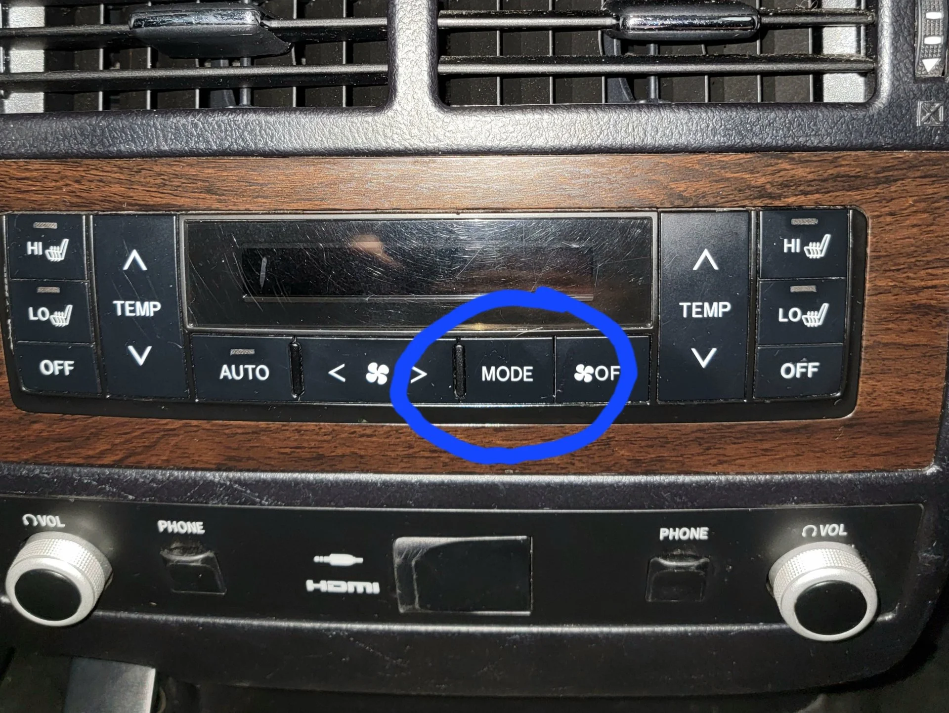

I dont know what other controls are in a 2011 LX but I know on my 18 LC there are separate rear controls on the back of the center console. When the kids mess with them it plays havoc. Specifically the rear mode selector button has no way for the front controls to override it or change it. I can change the rear temp and fan speed from the front but when the rear control changes the air vent mode (floor, high, both) Selection it can only be fixed from the rear control. I can't count the times my kids feet have kicked that switch and ended up selecting the floor position for airflow then complained to me they weren't getting any air on them from the rear vents.
Thanks ive messed with those buttons quite a bit, can’t seem to get air to come out at the feet or the roof…just the center console.

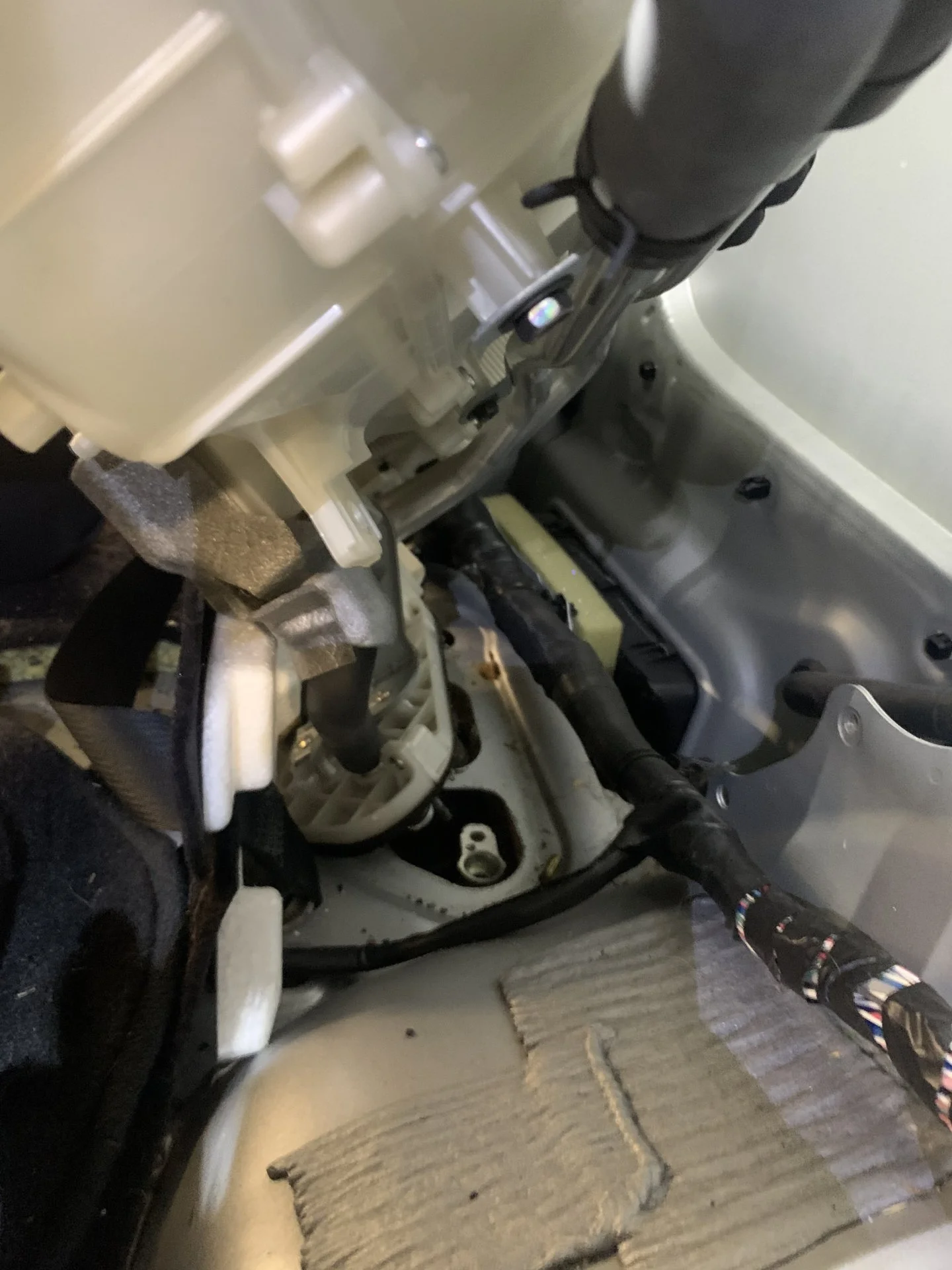

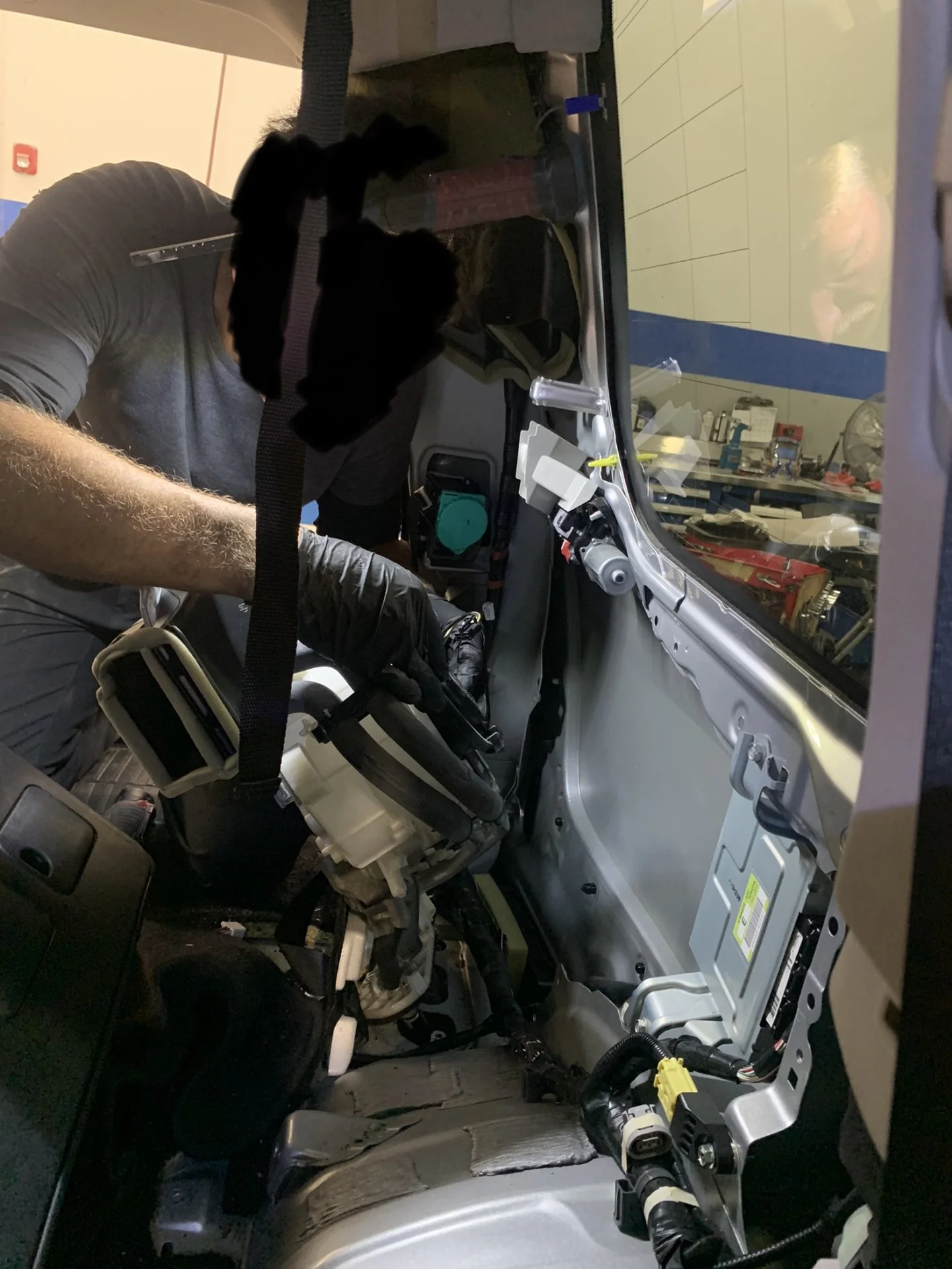

Turns out it was my rear blower motor.
Getting to the blower motor required removing the 3rd row seat on the driver side to access the ceiling vent blower motor which is behind the panel behind that seat.
When turning the rear fan on on the switch on the dash, it would click ever so quietly but not actually spin…then when you spin the blower motor with your finger slightly it would spoil up and blow nicely.
I need to order a rear blower motor and swap it out…might require another evacuation of the ac system since it appears Toyota designed the blower motor to only be replaced if you remove the entire assembly.

-The rear blower motor has the same part number whether Toyota or Lexus…you save like $10-$15 by buying Toyota.
-to get at it, you have to remove the 3rd row on the driver side and various paneling/plastic
-you’ll need to evacuate the refrigerant from the ac system and disconnect it at the bottom of the rear ac assembly
-you do not need to disconnect your coolant lines (that run the heat back there)
-you can pivot the ac assembly enough to get the blower motor/fan out without
