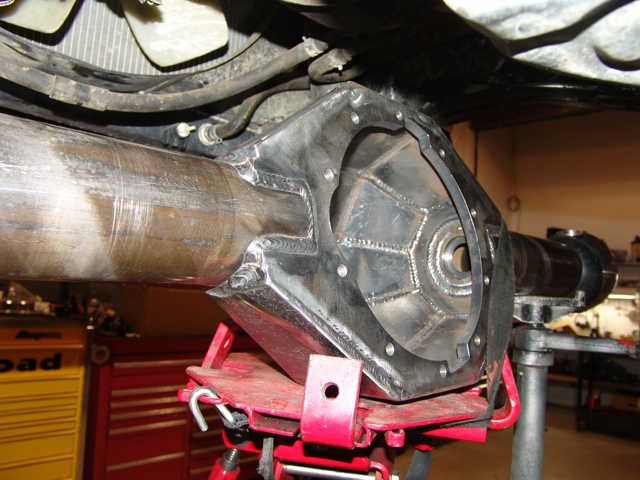

Teaser pic. Some might be able to recognize what this is going under. :D
I'm no tech guru, but if that truck is what I think it is, that's pretty damn cool.
Yup.
Not likely.
