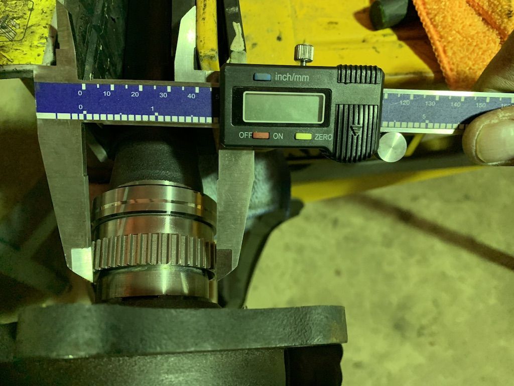

Yes, sensors are located on the diff side of the backing plate. Upper rear side of axle tube. Easy to get to. Sensor ring, on the other hand, is inside the hub. I believe it's on the inboard side of the axle bearing but not sure. Wouldn't want to have to change that.
On the plus side, you can inspect it through the sensor hole. I had a dirty sensor code for the driver side rear and was able to clean off some debris with a cue-tip through the hole and th as cured the issue.
It is not too bad. You will definitely need a puller, or you can cut the ABS ring and lock ring off if you have new ones.
240k on mine and it looks brand new. Chances are, it is the sensor that has gunk all over it.

The rear sensors do not mount like the front ones. They are mounted ON THE AXLE TUBE and project into the tube, not into the backing plate. My truck is a rust bucket and it came out easily. If I recall correctly it even had an o-ring seal so it should not be rusted in place.
