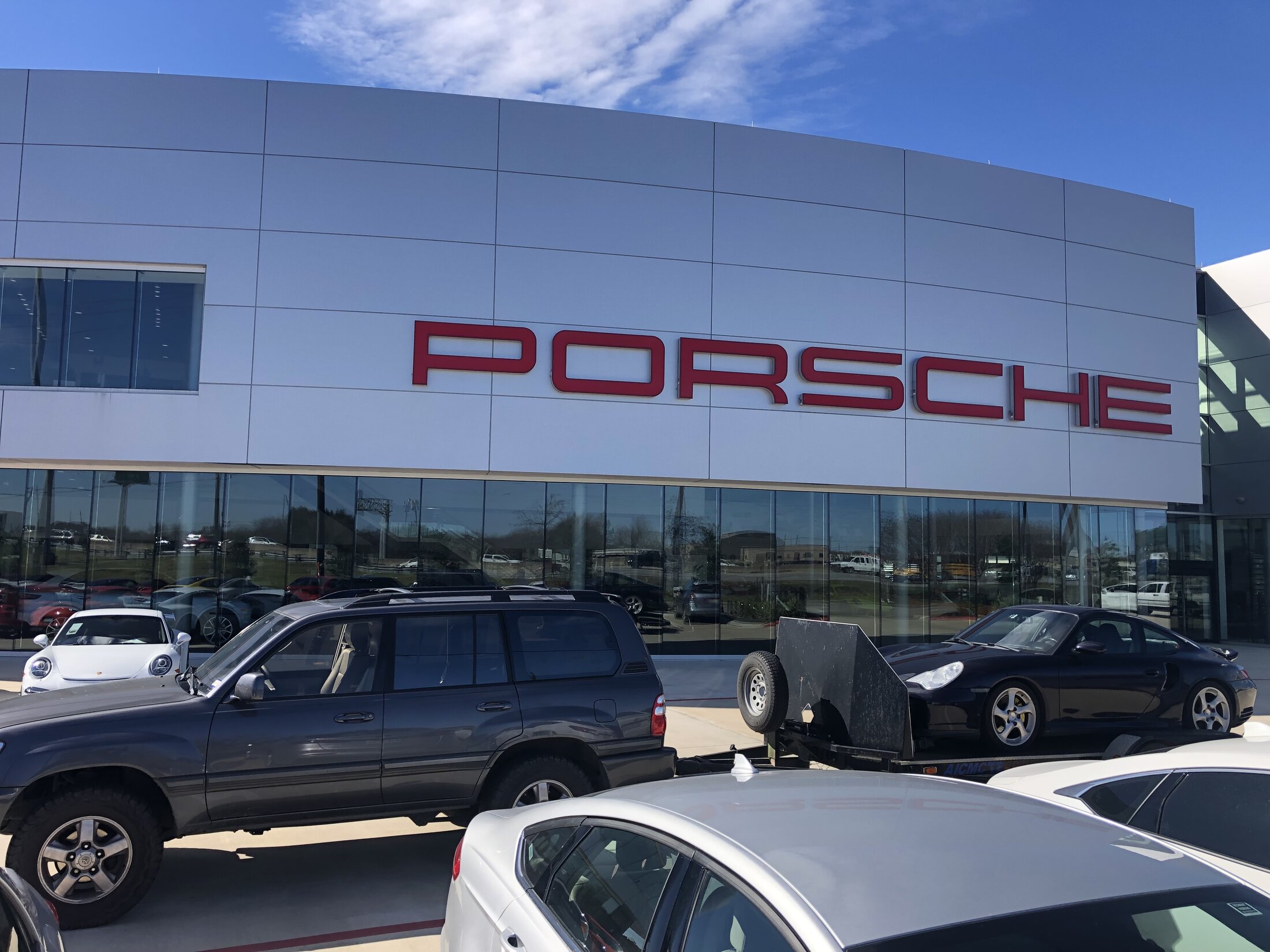

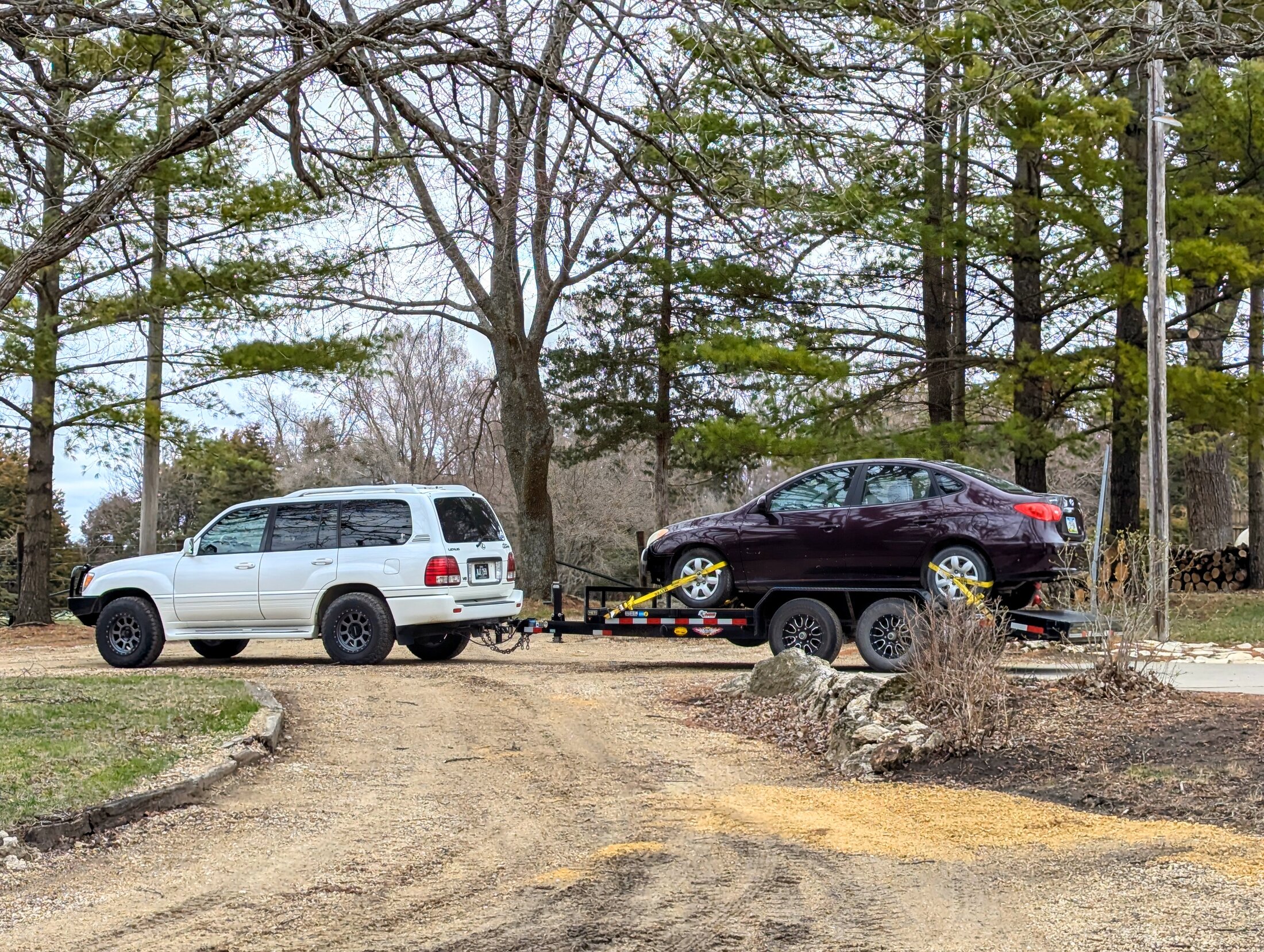

I tow about 6000lbs with mine along with a few hundred pounds of gear in the back. PJ 18' open car hauler steel 5" channel frame, and my 87 Toyota SAS'd pickup. I use airlift bags in the rear springs to help the AHC pressures stay close to spec. It tows great but can get slow through big hills.

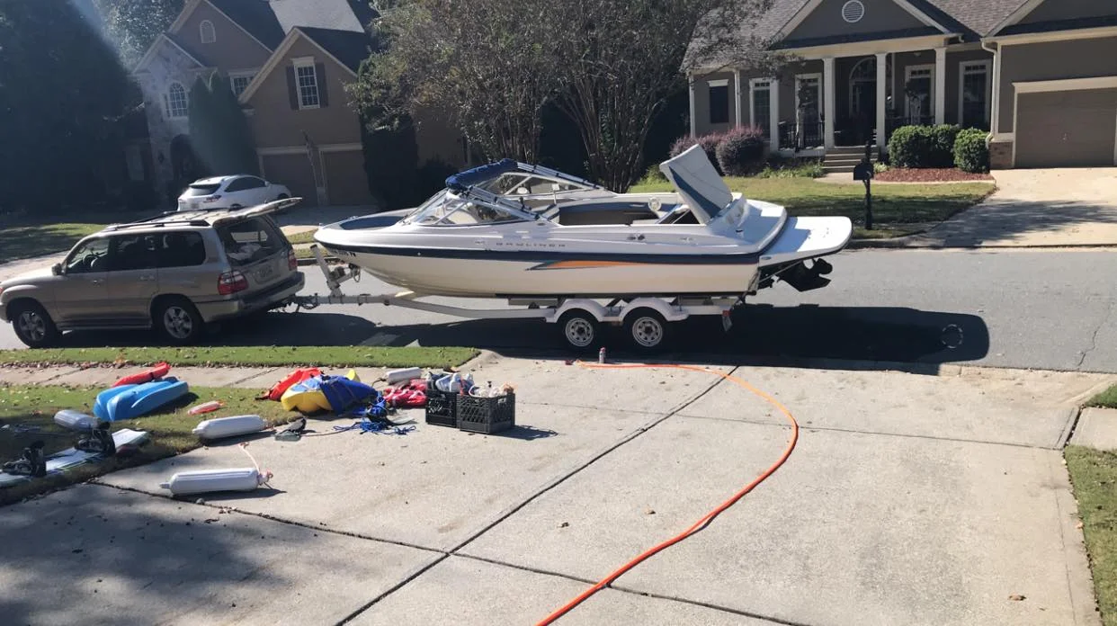

I pull my 5000# boat / trailer all the time just not very far. Given your location and lack of hills, I wouldn't sweat it at all. The 100 is a decent tow vehicle, but far from ideal for repeated long hauls. Anticipate stops sooner and don't plan on passing anyone. And expect 8-10 mpg.

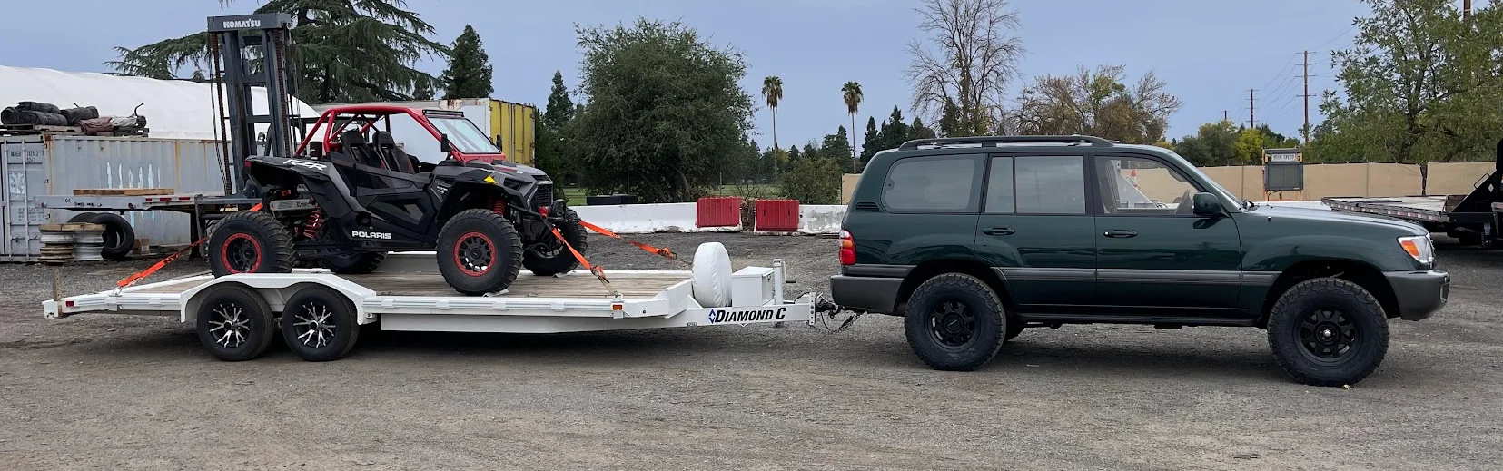

I’ve only done two “long hauls” with my 100. 320 miles with 5500 lbs, didn’t notice much back there. 50 miles with 6700 lbs, I can feel the weight but mainly braking. Both routes are flat (from Nola). My experience may differ from yours as I’m supercharged, lifted with progressive rear springs, and have E load tires.

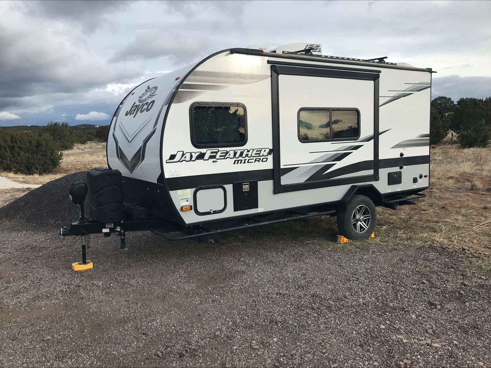

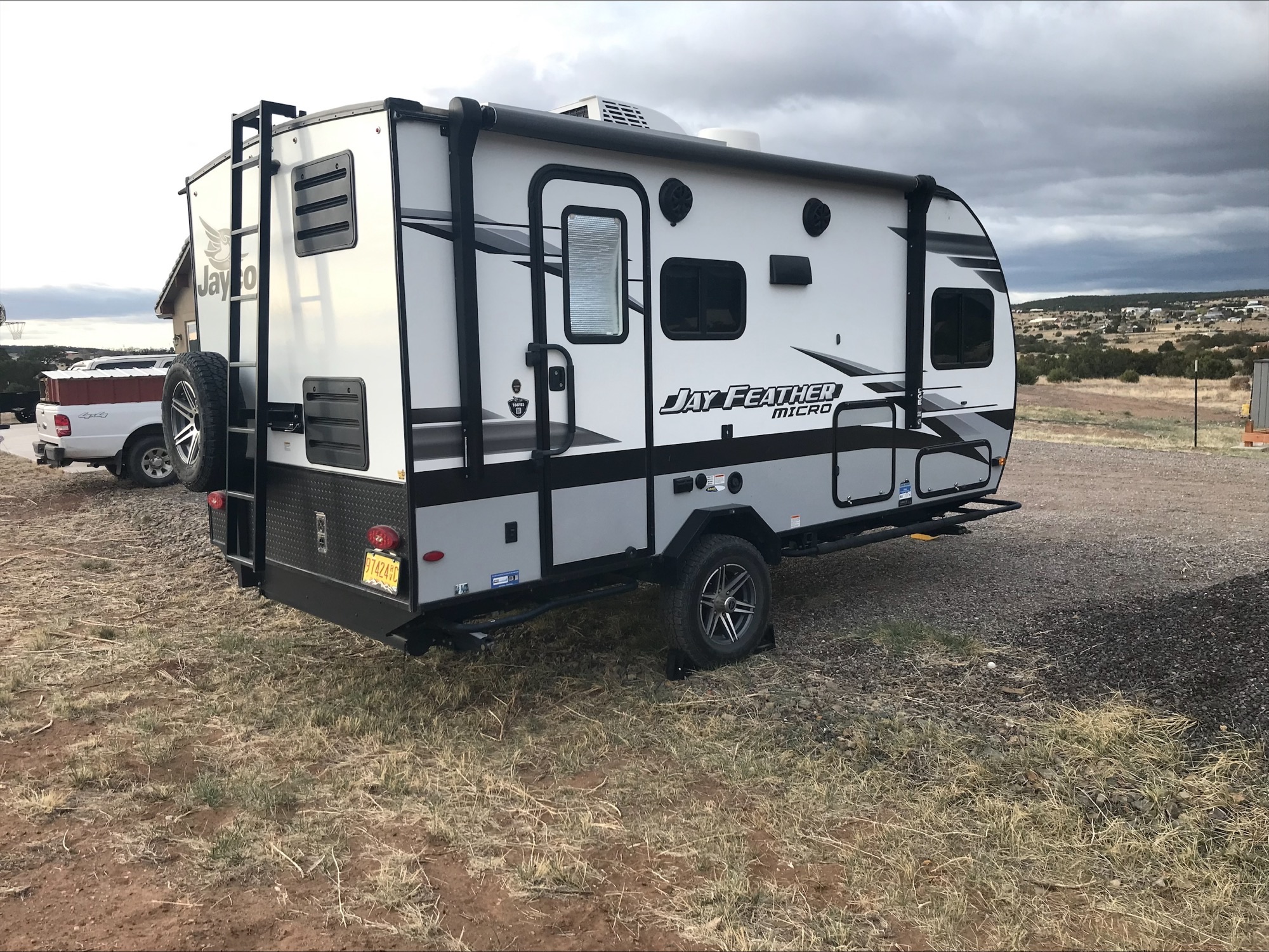

Last weekend I bought a Jayco Jay Feather Micro 166FBS. All those words might make you think it's lightweight but it weighs about 4,000 lbs empty/dry. I did a test tow around the area with some small hills and it seemed ok but not like it's no problem. The trailer came with a weight distributing hitch and I've set it up per the directions. But the truck certainly struggles to maintain speed on bigger hills. I'm really worried about this summer when I go up to Silverton and I have to go over Coal Bank and Molas Pass north of Durango. My truck just chugged along at 25 mph in 2nd gear with the lighter popup on those passes previously. I'm pretty nervous about what I will experience with this newer, heavier trailer that is also a bigger profile for catching wind resistance. I really like my 100-series and I don't want to replace it but I also would struggle to justify keeping it if I had to get something bigger to tow the bigger trailer.
