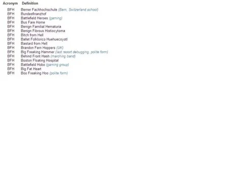

Nah. Wayne's not civilised either. ;) Nor's Drew/Amaurer for that matter (who I've seen recommend using a BFH for some repairs).
BTW ....I first came across the BFH acronym on MUD and it took me a while to work out what it stood for. It isn't really used much in New Zealand.
Hey. For anyone else compromised by their sheltered location, see if you can work it out from this list:
