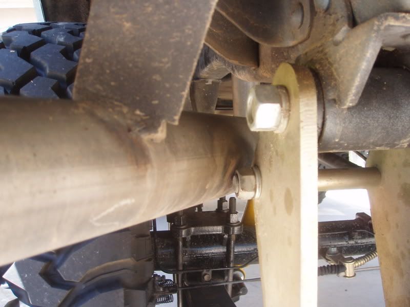

Find my rattle!
I found it!
Stupid MAF exhaust kit. the 4 plus shackles are F'en huge so it rubs on the bolt during idle, well at least thats when I hear it the most.
(look at the furthest bolt)
Well, you might just want to give me that MAF exhaust then.
