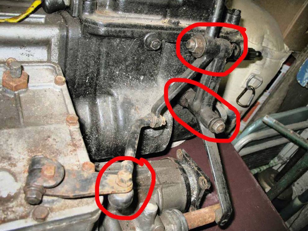

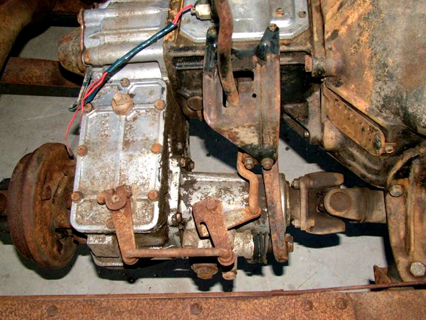

Haven’t done it but I’m pretty sure you could remove and replace it from underneath with the hump on. It’ll be easier with hump off. I don’t think you could see it enough to see how it all works but you could do that with pics. By the time my paint dried I had to refer to pics to get it back together and installed properly. It’s a little puzzle but not bad. When I searched for pics, I found some variations. Might be for 3 & 4 speed but I don’t know. They all do the same thing. There’s a shaft sticking out the top needs to rotate back and forth (hi & lo), and there’s a shaft that sticks out the front that needs to move in and out (2wd & 4wd). I just referred to the linkage variation pics that resembled mine.
I grabbed these pics here to help me. They might help you. Maybe someone else here can identify the variations. They do show the “gate” that Jim (Downey) was referring to.
