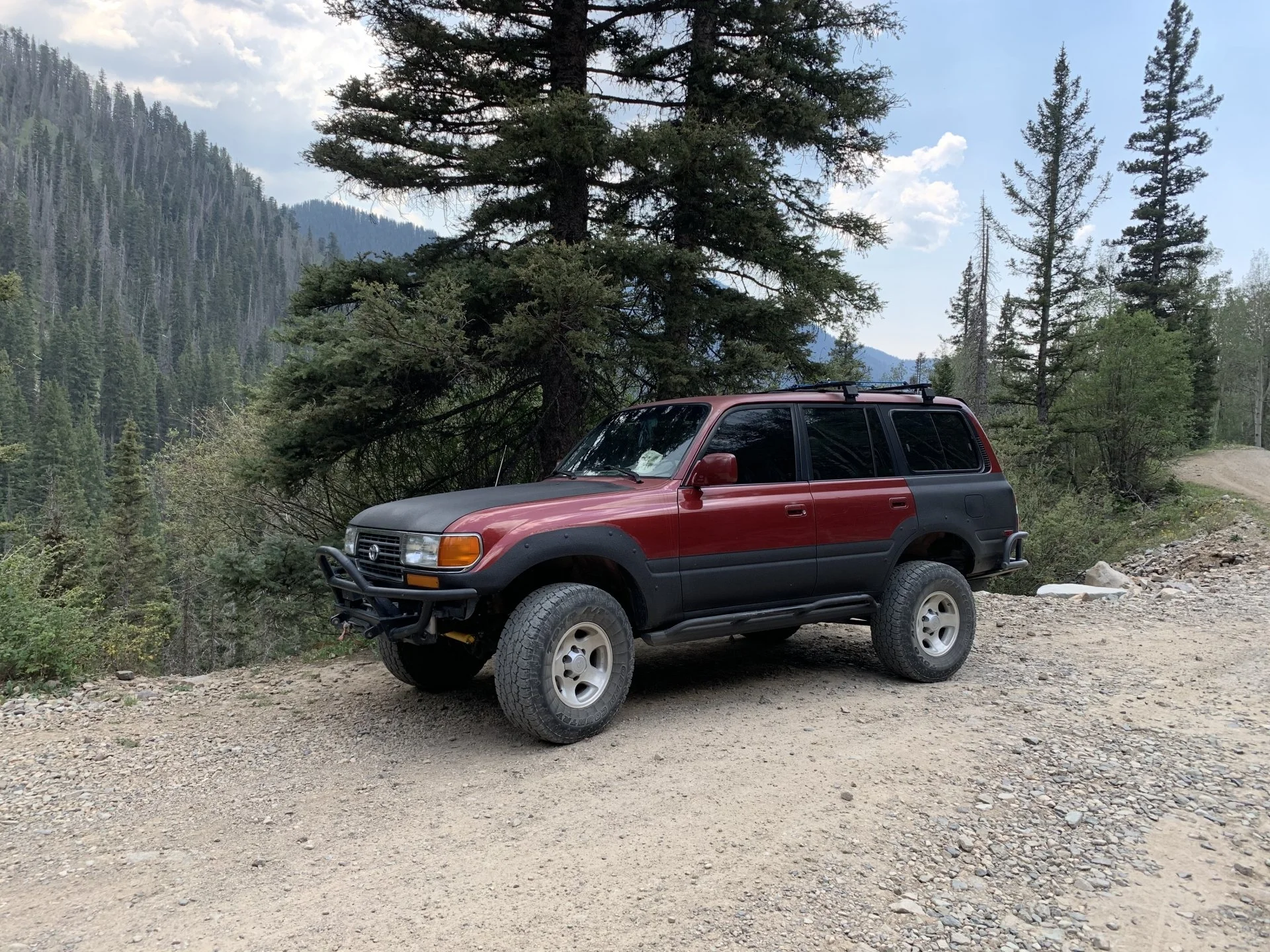

Hey now! I love my raptor liner. With the amount of brush and piñon and juniper trees I go by it’s saved me a ton of scratches. Just wash and go. I still need to fix my power antenna from a juniper that took it out🤪. It just depends on what your use will be and what you want. I did mine with zero experience. Whatever you do, make sure you prep well and that takes the most time. The painting is quick. Make it what you want, you’ll like it even better. Good luck!!!!
