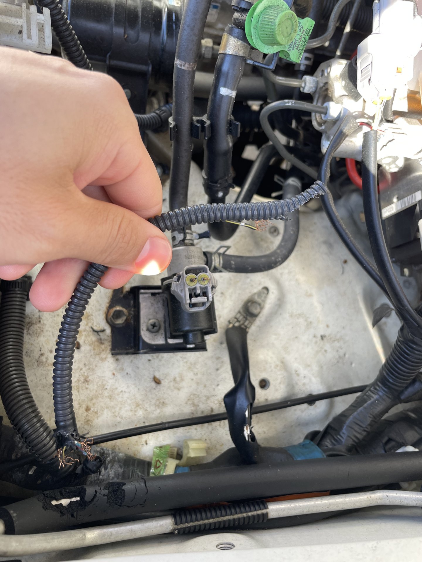

Recently pulled the LC100 out of storage and found some rats had eaten through some cables. Can anyone help me identify what this goes to and what the impact is driving it until it is replaced? It appears to be related to the AC/heating system

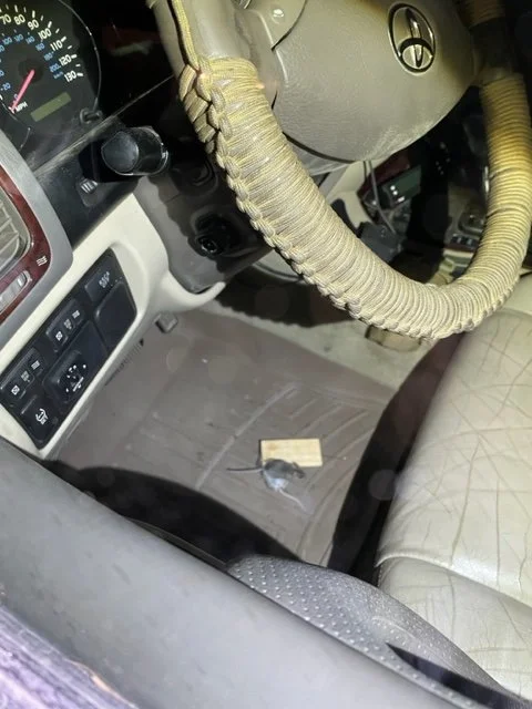

As a side note, set some traps. Lot's of cozy places to call home in the 100. Final tally was 6 when I had my son's 06 shipped home from Colorado. That's two. He was still eating peanut butter while his buddy was detained below. :lol:

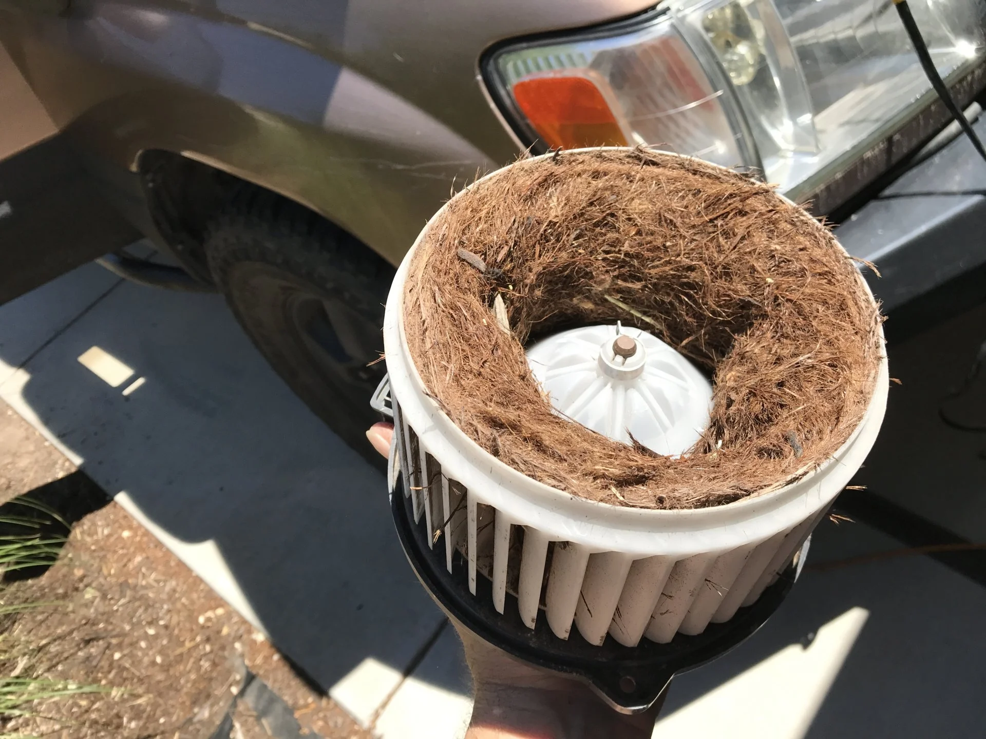

I had a family of Packrats set up a nasty nest in the V of my 2UZ-FE; 5-years ago. And, of course, they dined on the wiring harness apart of the knock sensor. After I got all that remedied and apart of a test drive, upon turning on the HVAC fan and getting zero air throughput...I had that sinking feeling of immediately knowing the Packrats hadn't stopped at the V.
A bit of a PITA that left me on the want to kill...every fawking Packrat within miles. I nearly succeeded, except their numbers are almost limitless.

Were the wires actually severed or just the wrap? Can’t tell from your photo.
Anything not work?
If the wires are larger than ~ 24 to 26 gage, the rodent will go after the soy oil/taste in the insulation...why they went in scrounging to start. Small gage might cause unintended bite-throughs.
Just how much wires did the mice chew? Is that a purge solenoid connector? You can save the terminals and solder a new section of wire and splice it.

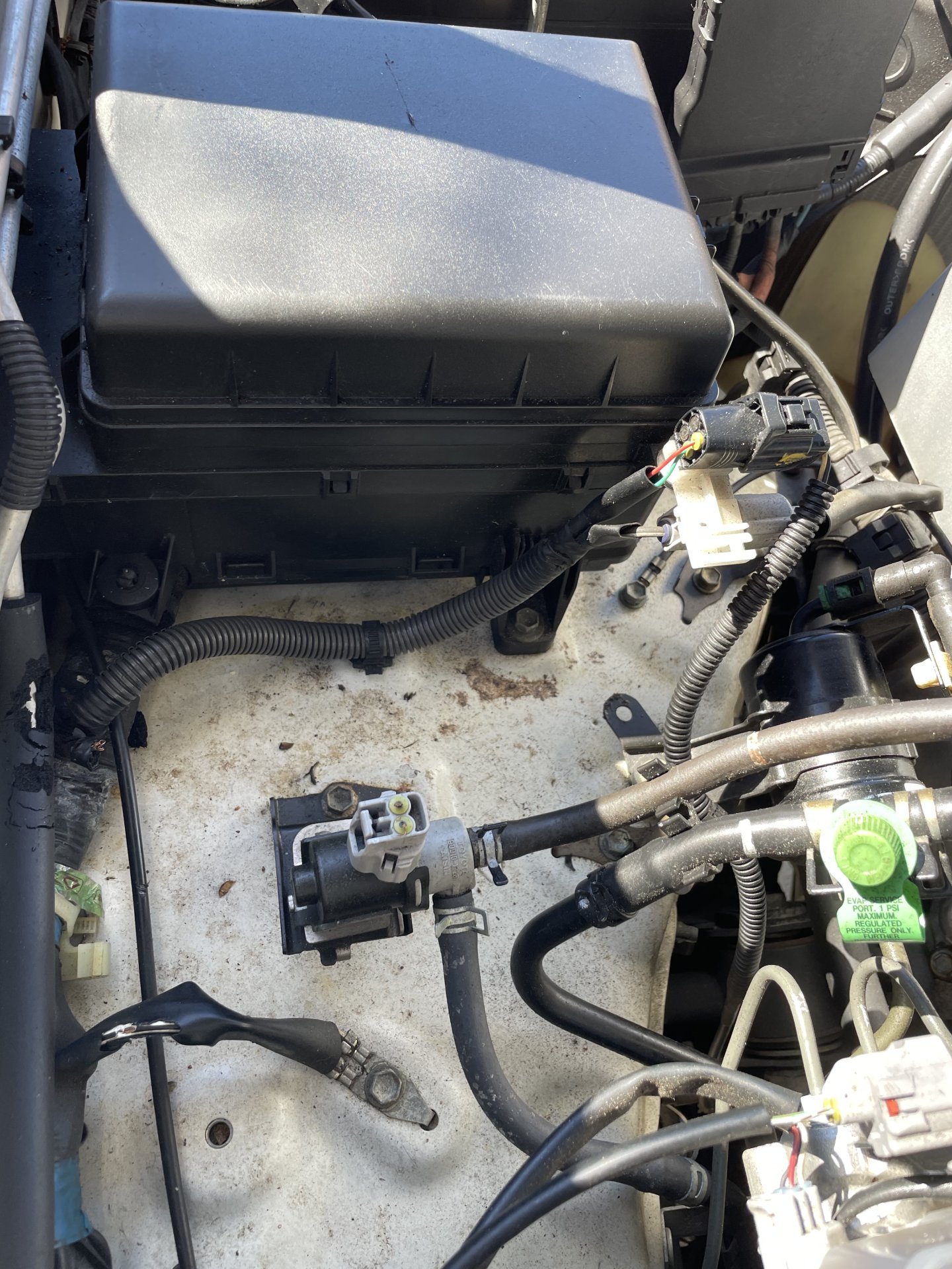

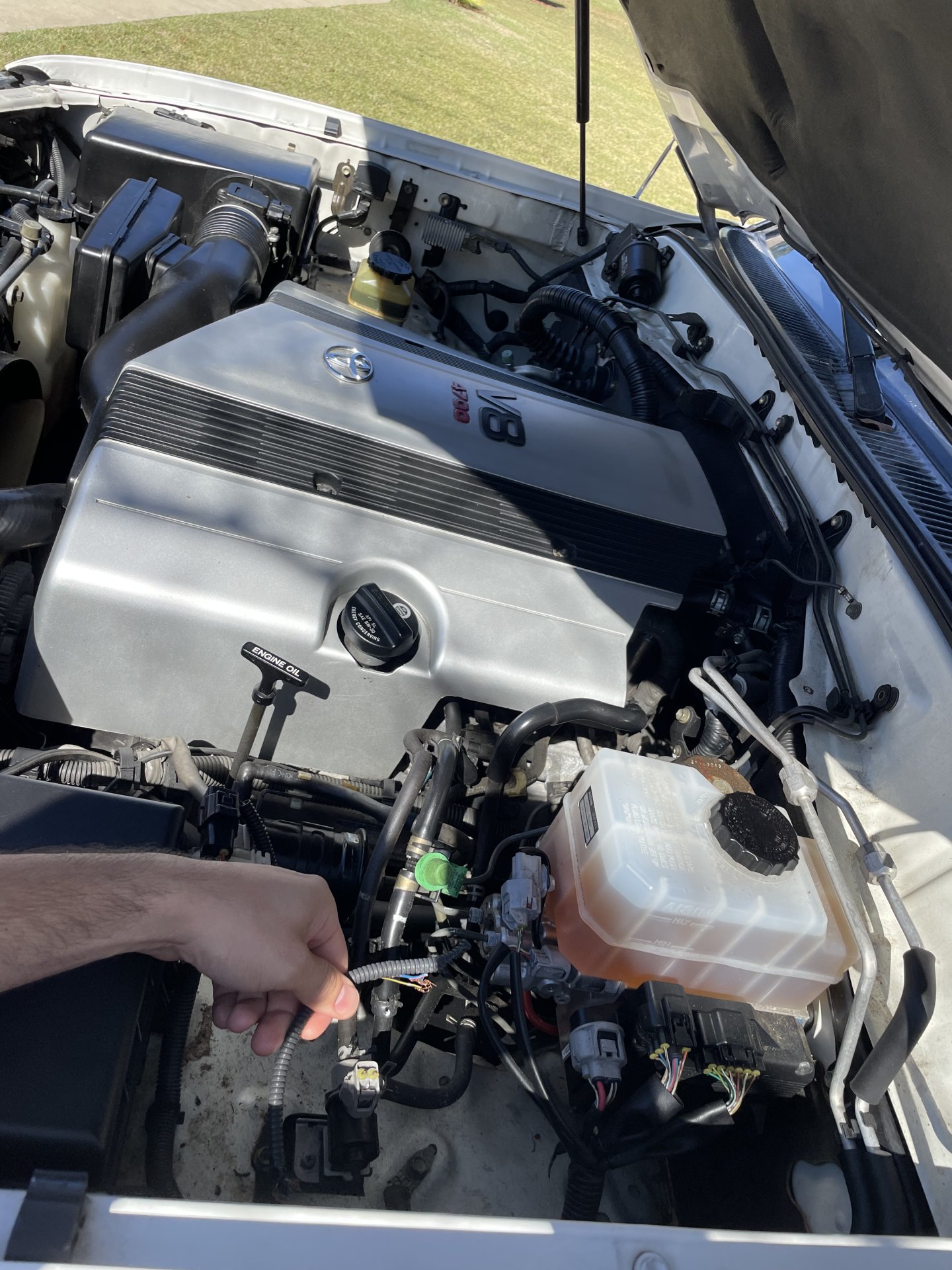

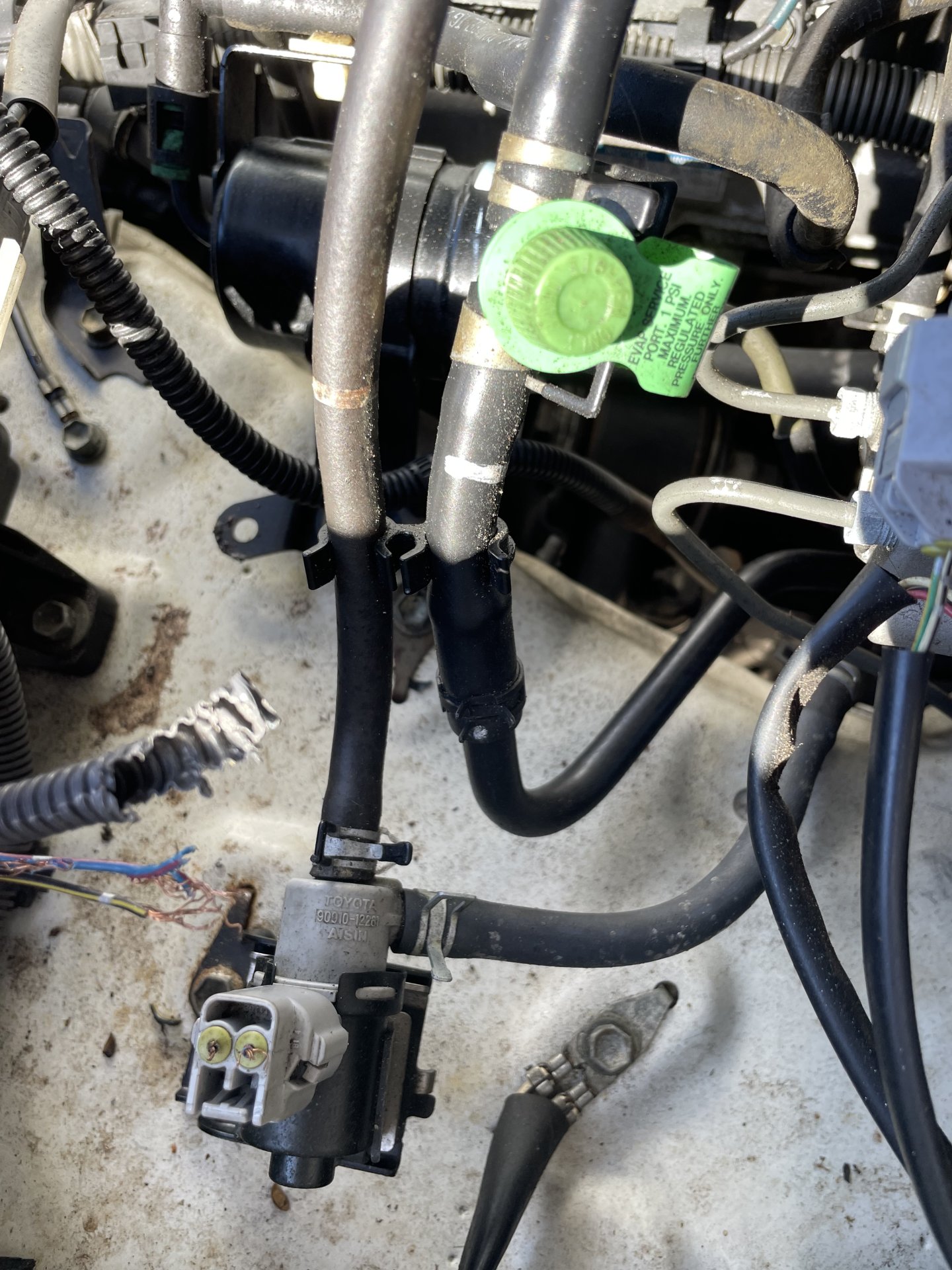

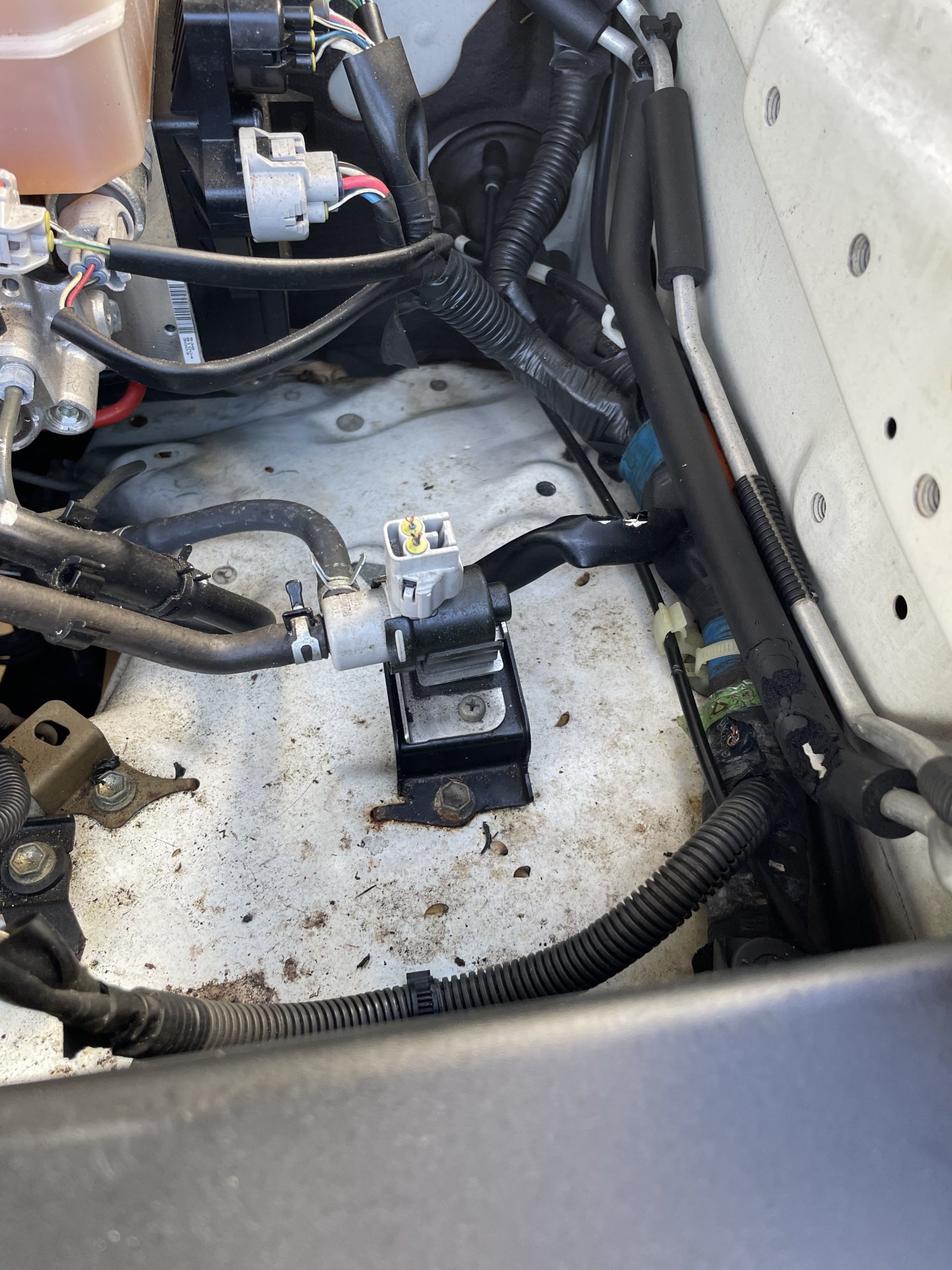

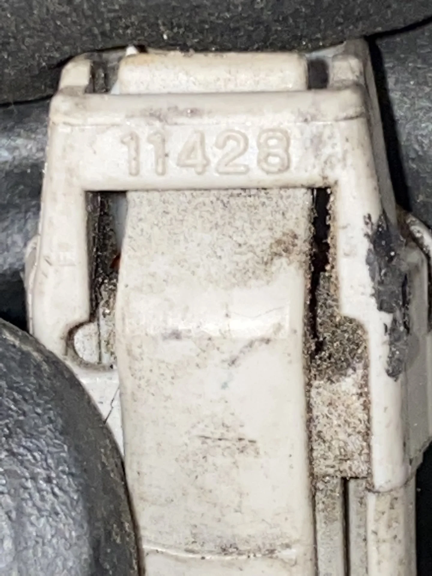

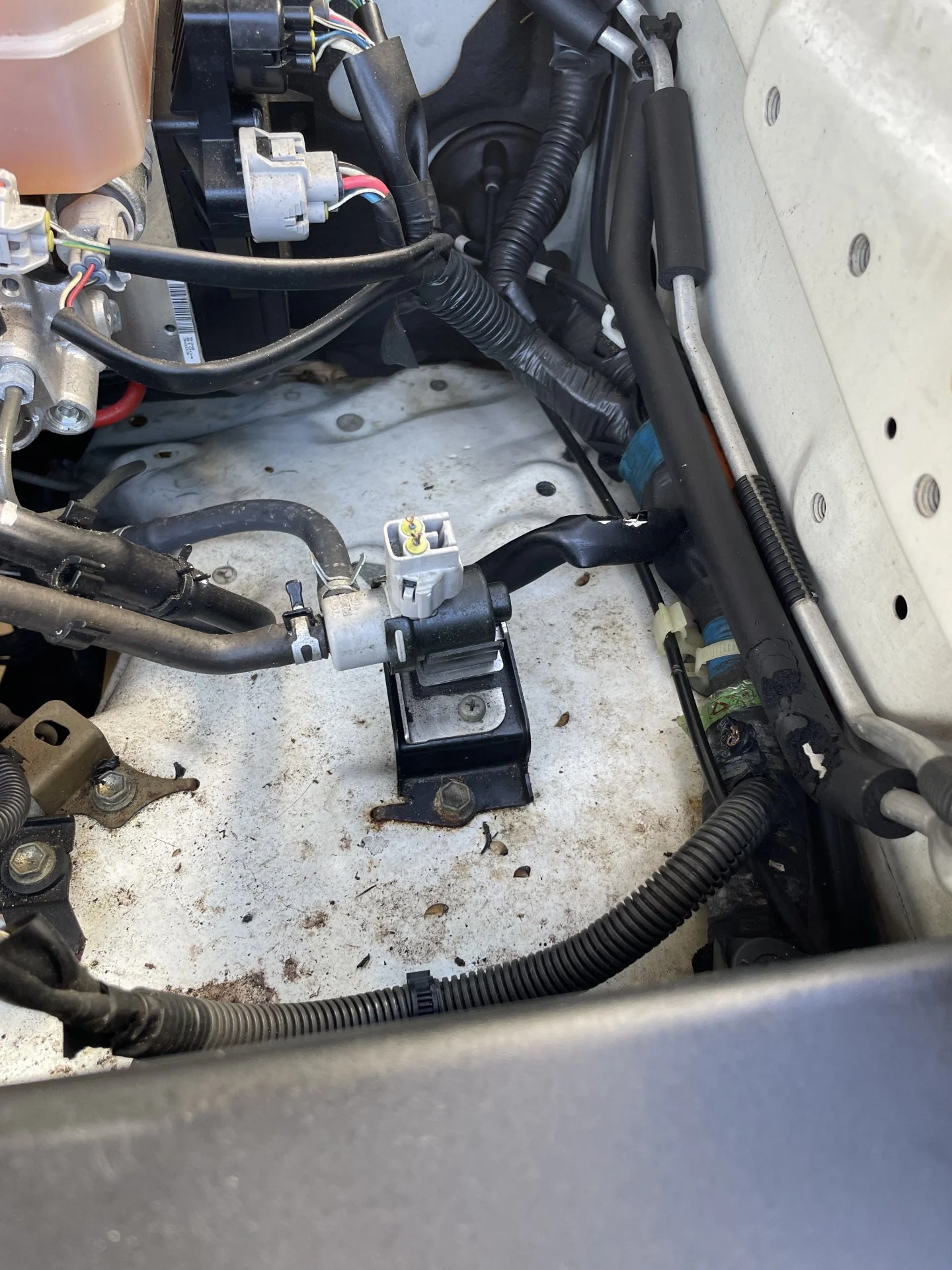

Here are some better pictures and including the remaining segment of wire that’s been completely separated along with a closeup of label of seemingly related component. No obvious signs of anything wrong while driving. Heating and AC still work. I appreciate the feedback so far! Hoping someone can ID the type of wire and what it belongs to!
You can just Google the part number that's on it.
Ya… that should have been my first move. Looks like the wire powers a vacuum switch valve. More googling to figure out what that means and what it impacts
I found this post related to the VSV, but need help in figuring out the wiring component. Any leads? (Pun slightly intended)

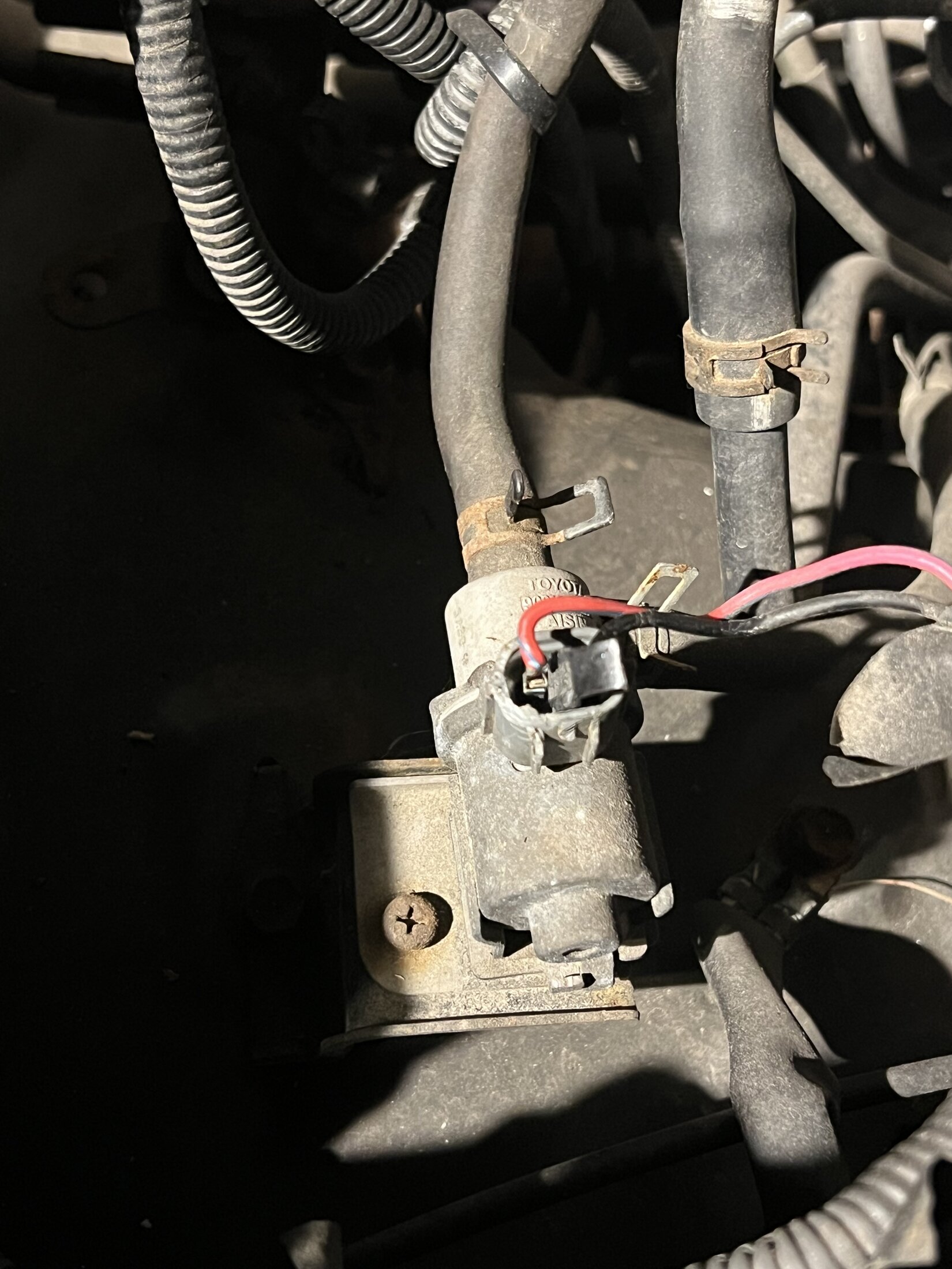

Anyone have the part number for the pigtail that goes on the vapor canister valve? I wrapped some black electrical tape and think I found why it keeps throwing codes.
