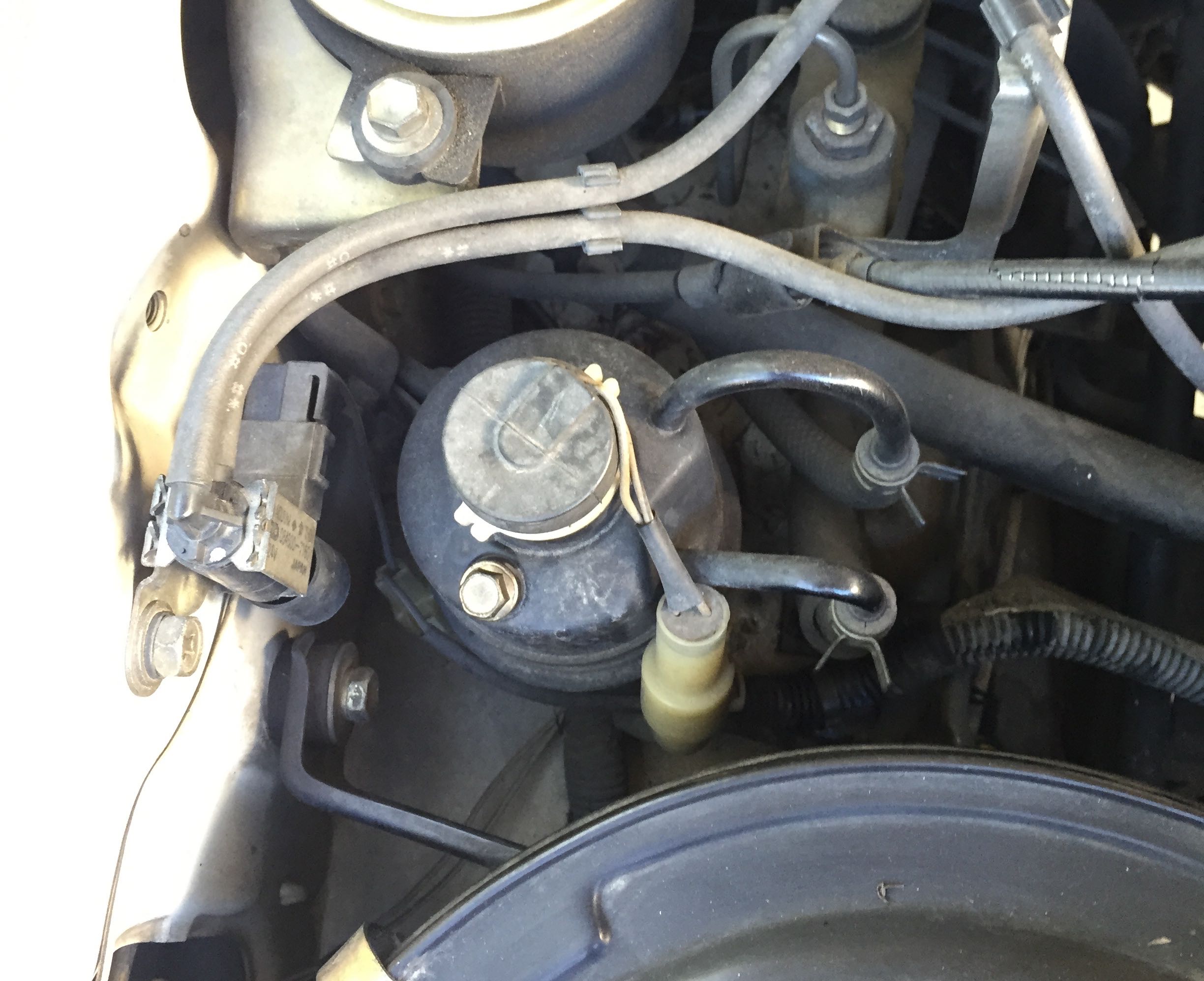

Which primer do you have? The type that sits on the injection pump or the other type that is aprt of the filter head?
If its the one on the pump , I think you can use the Bosch type from a mercedes, cheap and better. Look on ebay.
Yes I've plugged and played between my 1977 Merc Diesel and various cruisers. I had more vehicles than I had working primers at one point last year but for just a few dollars on ebay I got a couple of new ones that work great. Also, its pretty simple to take your lift pump apart, clean the valves and filter in gasoline, put new rubber o rings and a new copper washer in, and have it working like new, sometimes. If you do clean in gasoline (corrosive) make sure not to expose parts for too long, and to get them in some diesel soon after. Remember also that your injectors and injection pump are sensitive, precision parts, avoid any testing/temporary fixes that mean fuel gets to them without being filtered. Fuel should go thru a primary filter before (or built into) the lift pump, then a secondary filter before the injection pump.

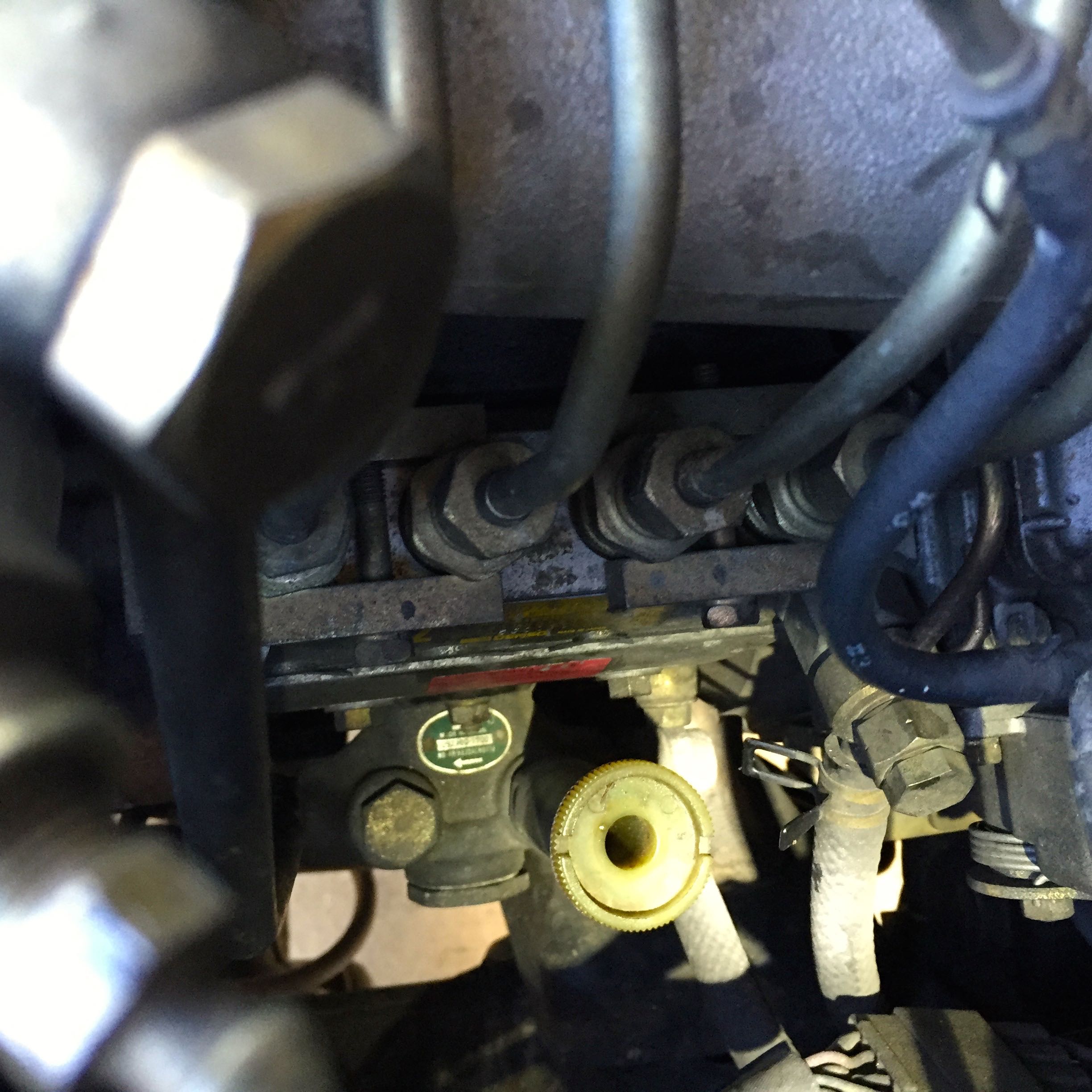

Here's the one I have that is suspected of not working:
Anyone have a link to an alternative such as those mentioned by @roscoFJ73 and @Canarias ? Found a thousand options with a simple search, but anything that is known to work on the 13B-T would be very much appreciated.
AFAIK ,all the older merc ones are the same, the ones on ebay for the models made in the 60s ,70s and 80s all have the same bosch part number 2447010038 .
I mentioned the bosch unit because it is by far the easiest to source ,its the cheapest and to my knowledge there is nothing else except after market toyota types which have let some owners on this forum down.
Thanks. Just ordered one. For $20, I'll consider it cheap insurance.
