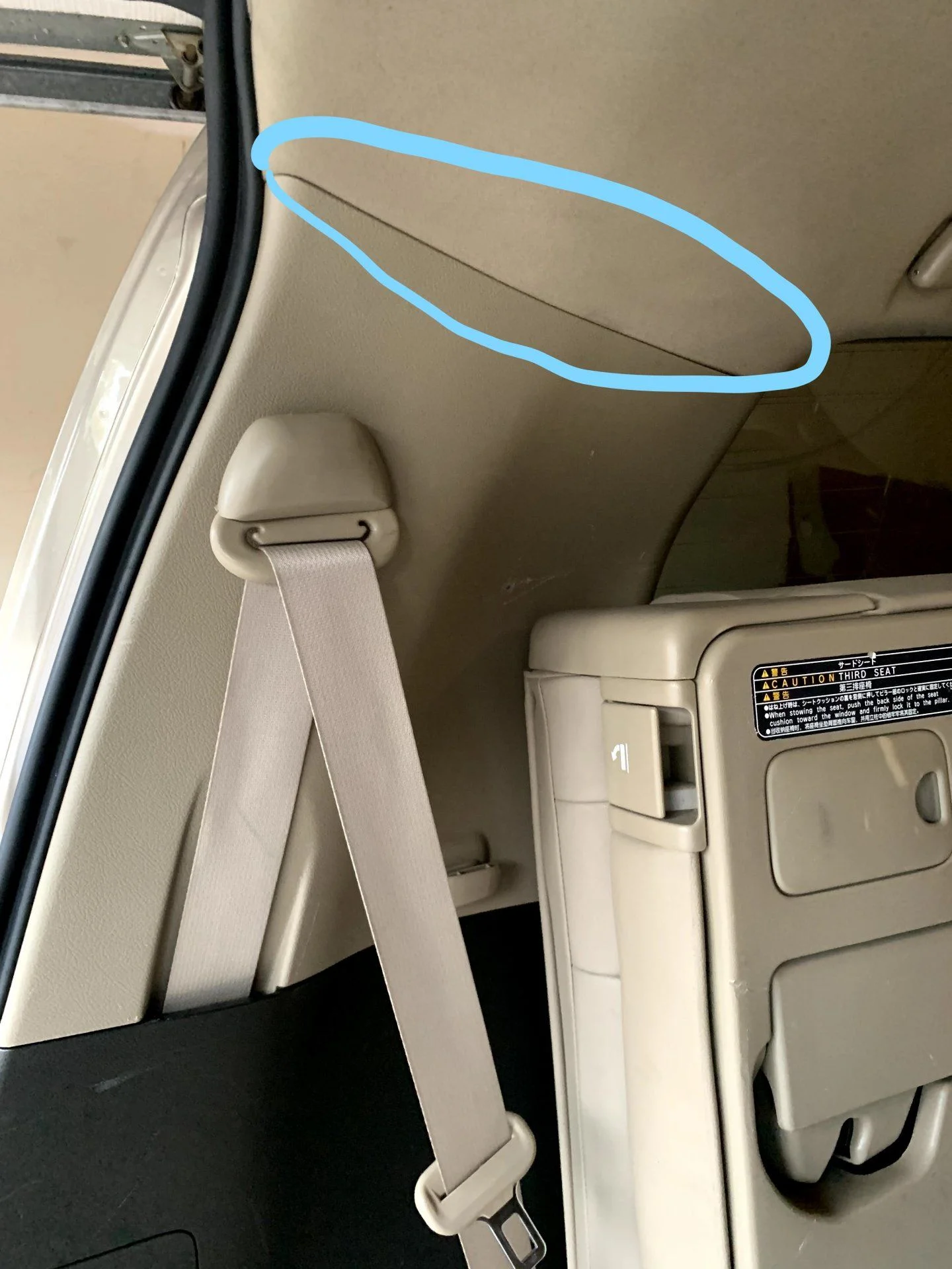

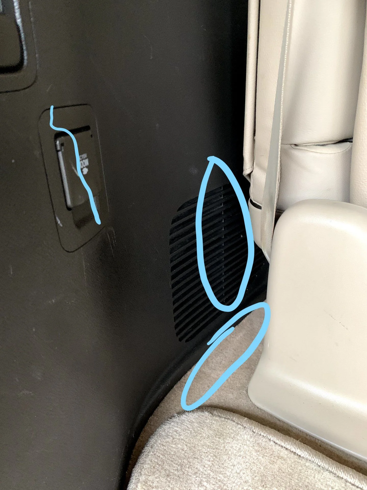

I'm trying to find where exactly this water is intruding.
it happens in heavy rain and through the car wash. i've circled where i see the water come through and i'm thinking it might be from the screw hole on the cargo rack? or the used weather stripping?

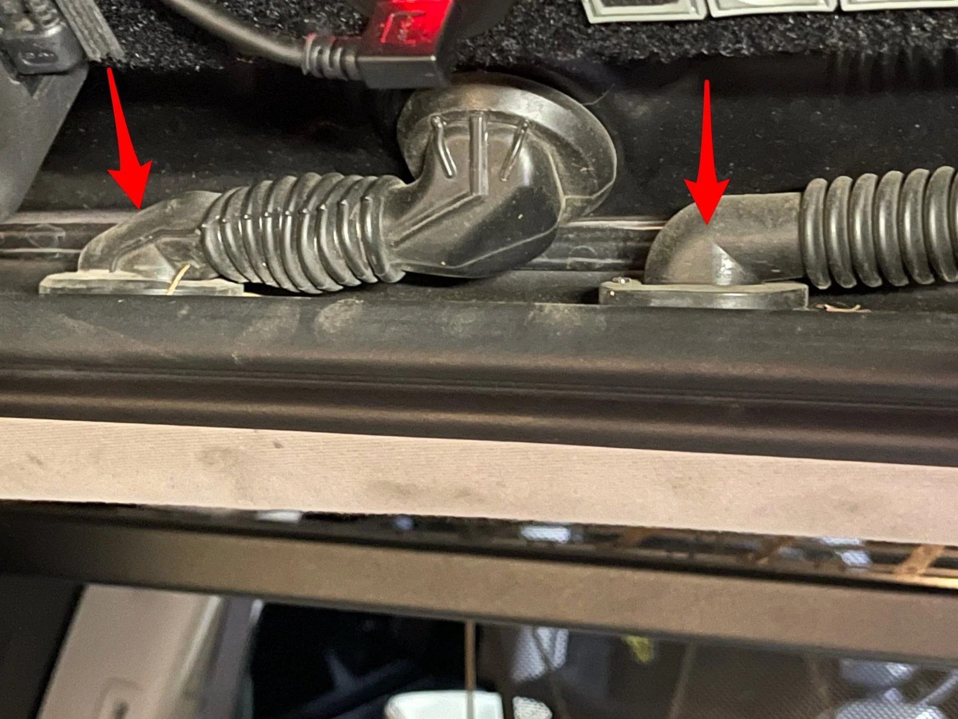

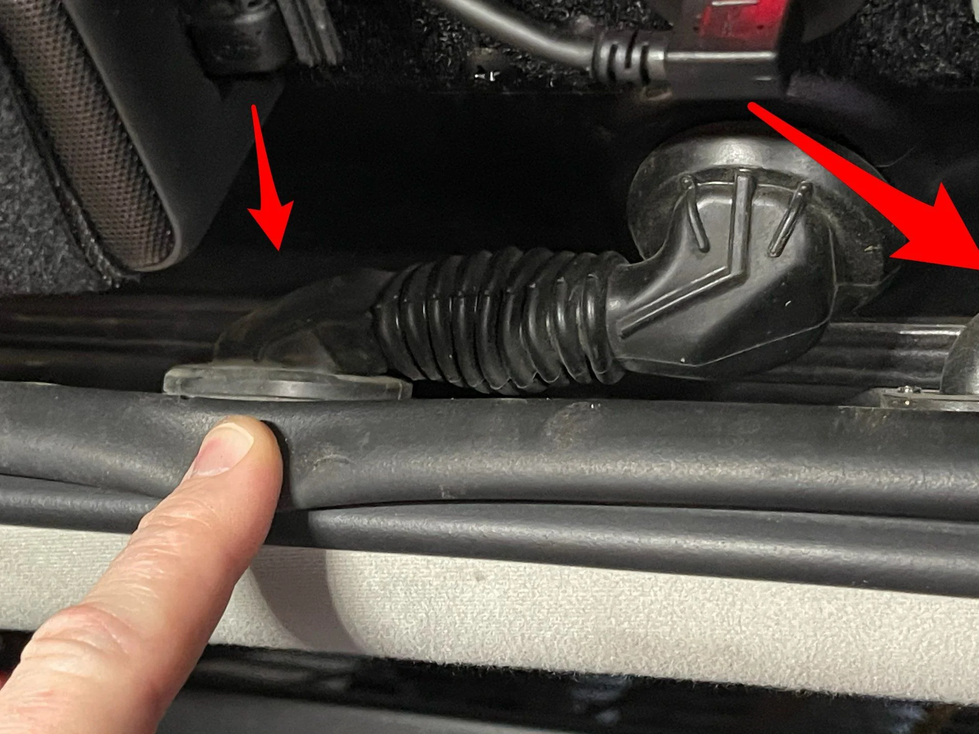

I would check the two tubes that enter the ceiling that are used to get wires and wiper fluid into the rear hatch.
Notice below that the rubber connection is NOT protected by the hatch seal...so if it becomes dislodged...water will POUR directly into the headliner via the runoff that goes into the gap where the hatch lifts at the roof.
I would wager a fair amount that you’ll find the one toward driver side in rear is dislodged.
Open hatch fully and look at its top just above where the hatch seal is:
Water in here will run and exit down that rear driver pillar and elsewhere.
^^ This. Having run wires through those boots, it is obvious that Toyota knows it is a risk area and the boot has a robust and tight seal - kind of a PITA, but it needs to be that way. If that has become dislodged and out of the retention groove, that will likely be your issue.

Ok. Just checked this and it felt loose for sure. Pushed it back down and gonna go through the car wash. Will
View attachment 2554706View attachment 2554707
That is exactly what happened in my 100 series, and what I was referencing in my earlier reply.
Reseating it did not fix the problem for me, but a bit of clear silicone adhesive / caulk fixed it. No problems since that, and that was 3 or so years ago.

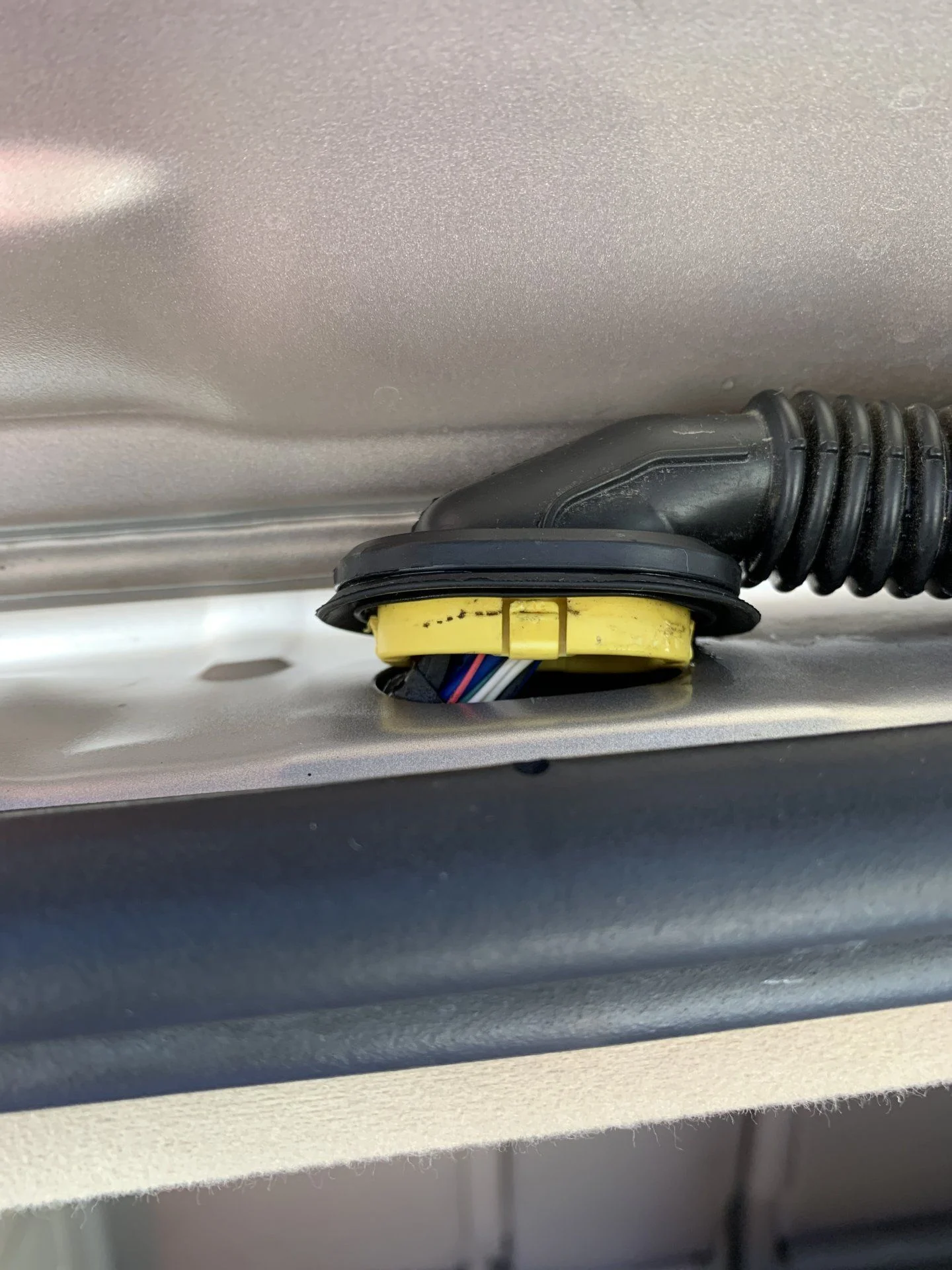

Thanks everyone. I am 95% this is the problem. Have been testing with a hose. What’s the replacement like for the entire boot? The yellow piece is part of the entire thing right ? That’s not replaceable individually / wouldn’t even really work ?
