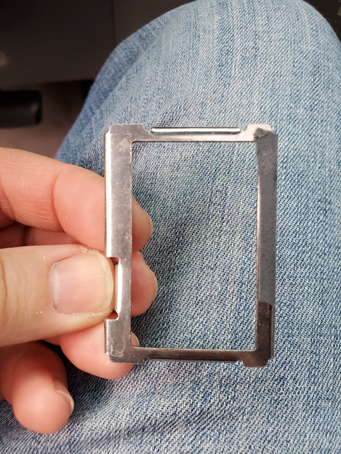

Hello all,
The rain sensor wipers on my 2005 LX470 has fallen off and I need to reattach it. This is a replacement windshield the previous owner had installed and the installer apparently just taped the sensor to the windshield... So, my question is if the metal bracket get glued to the windshield like the mirror mount, or is it held with some sort of tape? Thanks in advance.

I have the new gel pad, but there is a metal bracket that appears to mount to the windshield that the black box clips/locks into. My question was if that metal bracket should be attached with thin tape, or with mirror adhesive like the rear view mirror is attached.

What it the purpose of the metal attachment piece then?
It'd seem to me that the metal piece would attach to the windshield and the gel pad would attach to the sensor. Then you'd put the sensor/black housing on the metal bracket and lock it in to mechanically secure it to the windshield. Unfortunately I do not have the FSM to get any real details.

Thanks @uHu, it looks like I was right about that bracket. It shows it attached to the glass... Now I just need to figure out HOW it is attached. The thin tape that was on mine clearly doesn't hold well. The area that it attaches to on the window has the black ceramic mask, so I'm not sure if normal rearview mirror glue would stick to that or not.
Also, it's not showing on the exploded parts diagram so I'm thinking that the bracket comes attached to the windshield from the factory. Mine is aftermarket glass, so it wasn't on their already.

Well shoot. That explains a few things. My windshield is completely missing the bracket.
