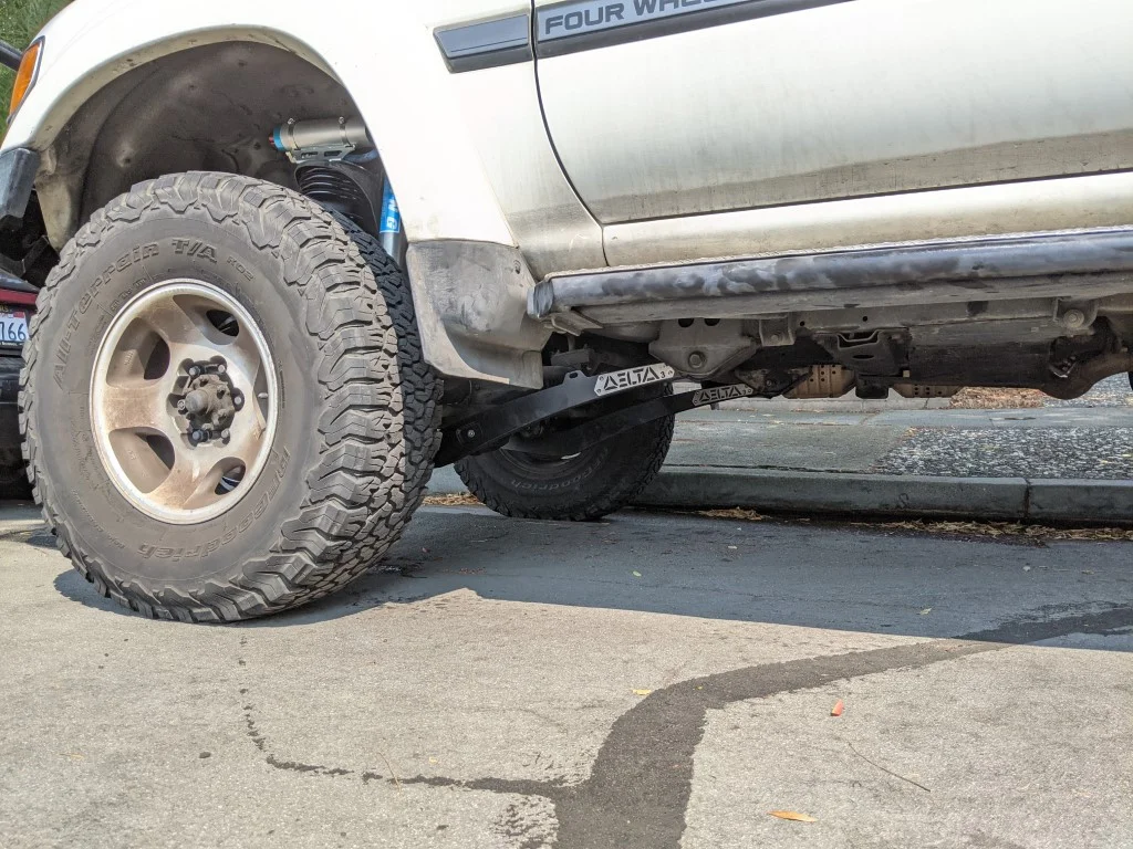

And because we all like pictures. After installation:
