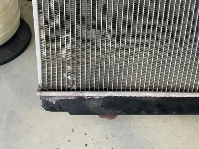

I couldn’t pin point the leak but it wasn’t any of the connections so it had radiator. I replaced it today with OEM radiator. After I got the old one out it appears to be leaking at the bottom, front passenger corner.

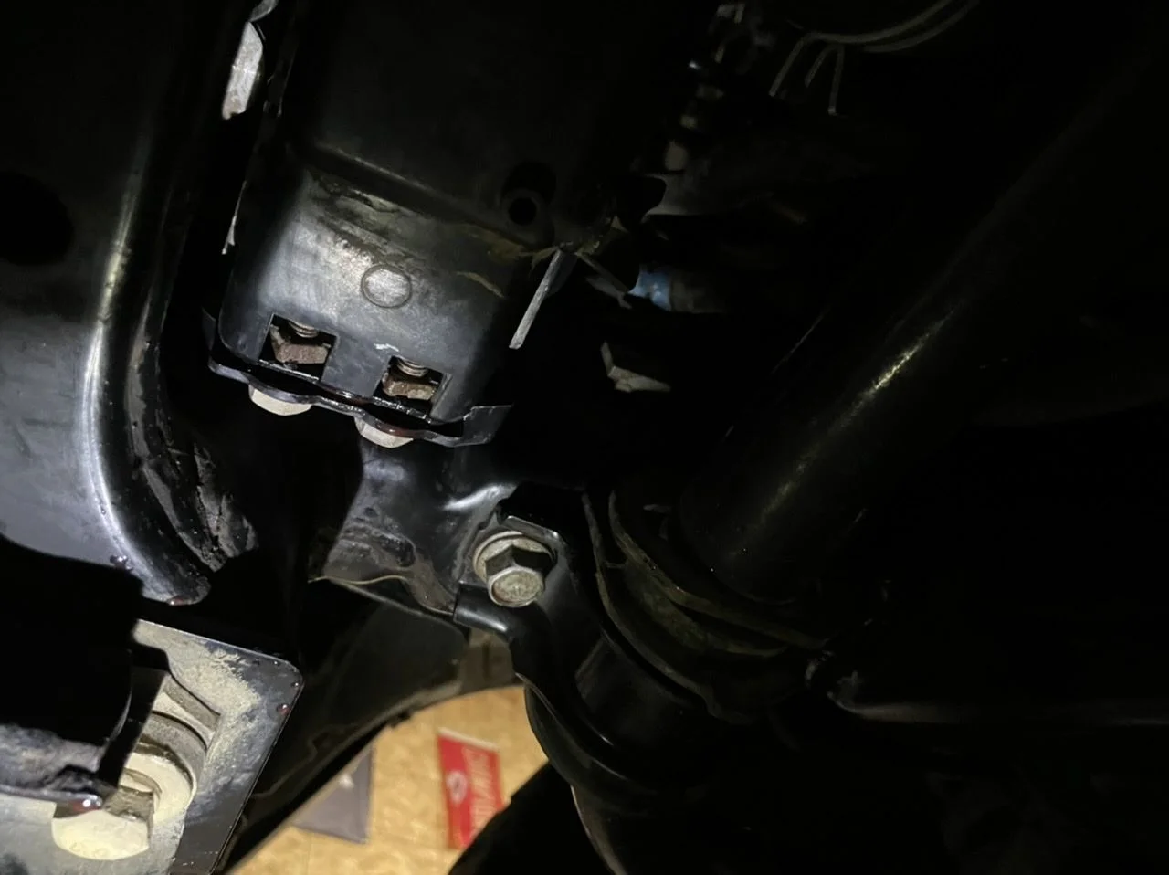

1. Removing the bottom mounting bolts are a bit of a pain because they go through holes in the frame and its east to drop the bolts in the frame. I used poster putty in the 12mm socket to hold the bolts in the socket. I tried magnetic inserts bit they didn't really work. My aftermarket bumper made this even harder thought this time I had it removed as I am installing a winch so it was easier.

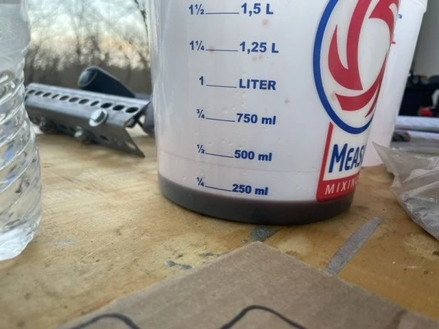

4. When you pull the two AT hoses off of the barbs on the cooler, have bucket ready to collect the ATF so you know how much fluid you hve lost. I zip tied the driver's side hose up into the engninnr
5. Rent a pressure tester if you don't have one to find any leaks,
6. connect a tube to the drain plug outlet and direct it to a clean bucket so you can reused the fluid..

One more thing related to #4. When you add back the fluid to the AT, the truck needs to be running when you remove the fill plug or you will drain more fluid out the fill whole. I learned that one the hard way. I'm not sure but you probably also should pin the AT T-stat open to as the fluid lost is on the cooler side of the circuit. I only lost about 200 ml of fluid so I probably can "overfill" by that amount as the engine is warming up. You probably don't really need to go through the whole AT fluid level check procedure if you have fairly accurately measured the fluid you lost and can also measure what you add back. I am debating this with myself now. I bet some folks are better at not loosing as much fluid as I did and then just don't worry about it at all. The total fluid capacity is 12.9 L. I'm OCD enough that I will probably do the whole level check thing again. Remember to get new crush washers for the plugs if you remove them.
