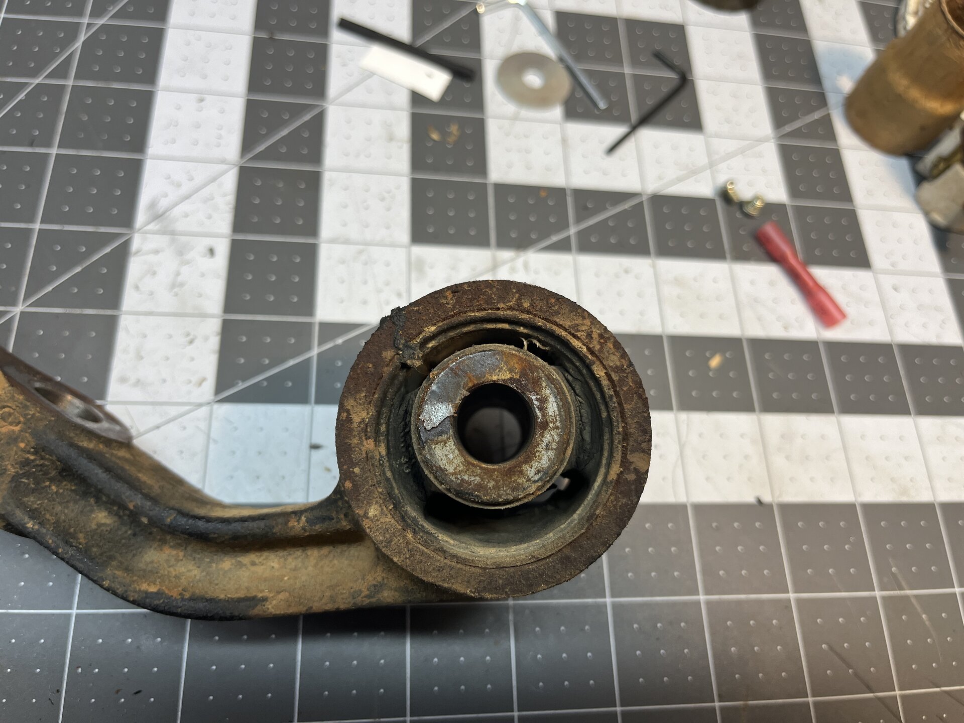

Not saying this is the issue but this diff mount was from my truck with +/- 180k

I ordered all of mine through Partsouq as I didn't want to deal with pressing in and out. The only one you have to mess with pulling is the one in the diff housing itself and it comes out easy enough. I'd swap the two assemblies first as they take ten minutes and go for a drive before deciding to pull the in-housing bushing. I have done that one several times on different 100's and they generally look fine. In most cases the warn out bushing is the support arm, which allows the diff to "wrap" a bit.
The play in the diff doesn't look excessive in your video but you don't show all three bushing locations. My experience reflects what was stated above: The front DS arm bushing wears much faster than the other two locations. I bought an entire arm assembly and swapped the whole thing out. If you do that, you can replace just the bushing in the arm you take off at your leisure and keep it as a backup. Takes 10-15 minutes after you have the skids off.
