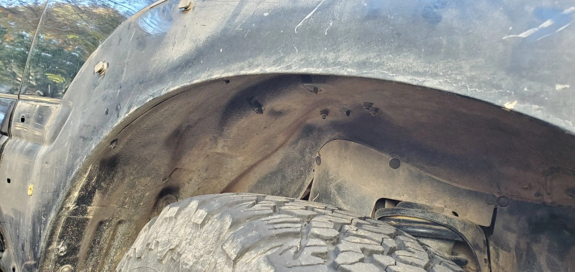

Anybody ever removed the wheel arch cover on an 80? Trying to reinstall my molding and not sure about the best way to get those clips out.

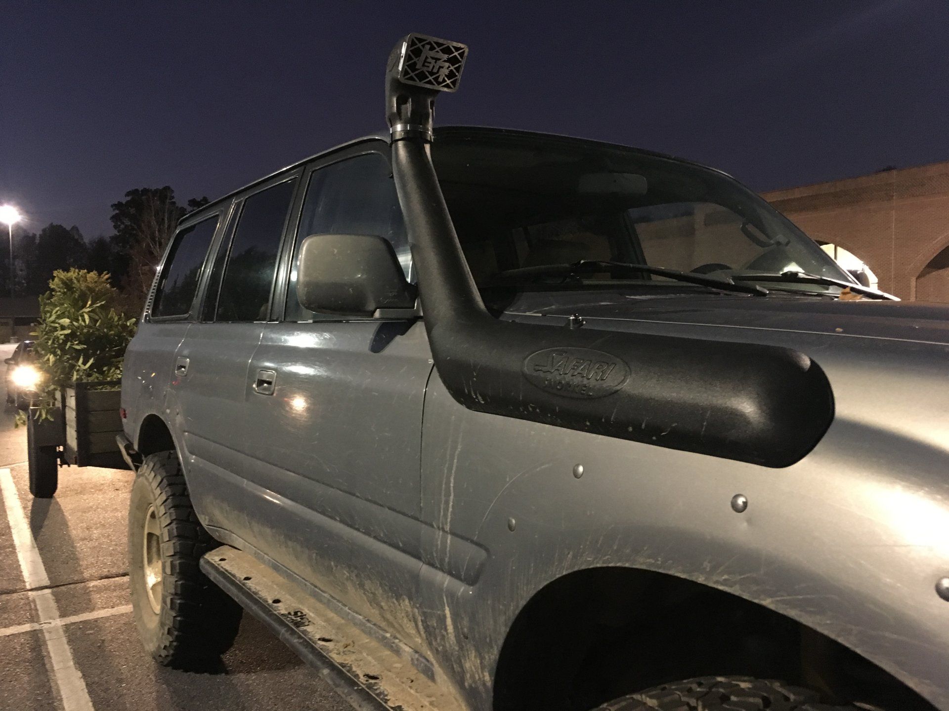

GM push in fasteners from Lowe's/Depot hardware isle aotomotive bin. Ford gray paint was a pretty close match to the moonglow. A couple of the oval holes required a lit rtv to keep them from rattling around.
Heres a link with part numbers from an old rotw thread.

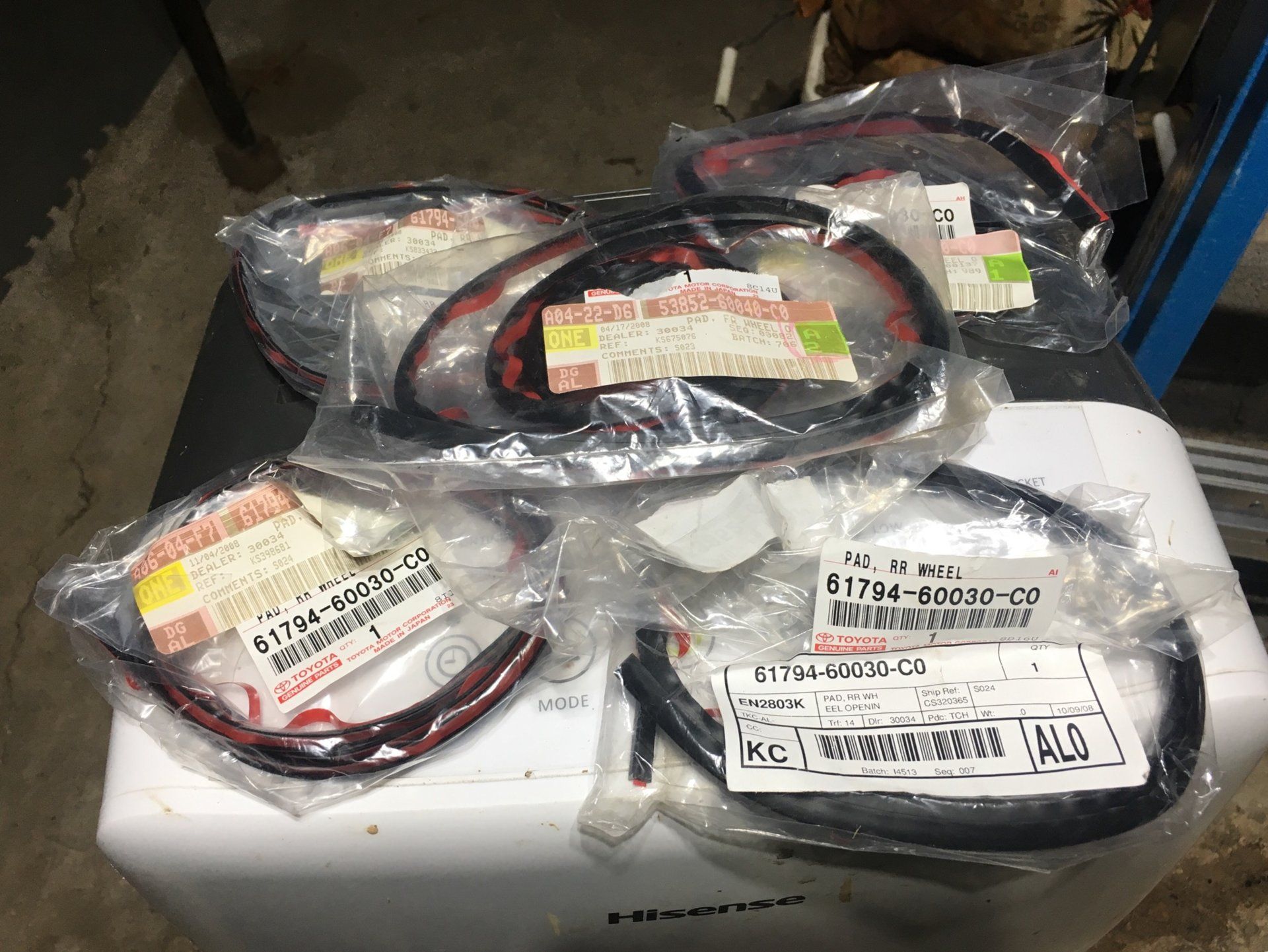

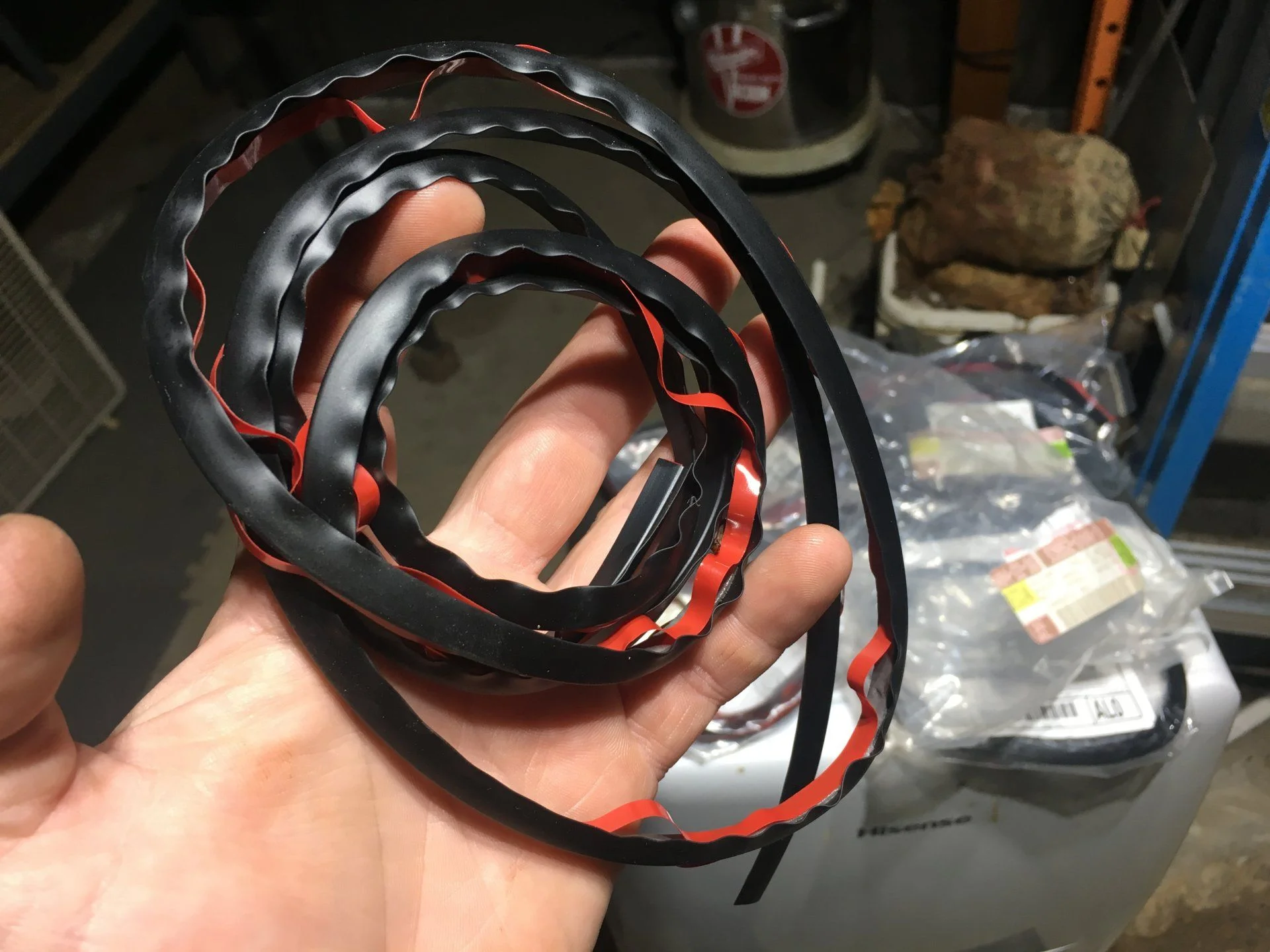

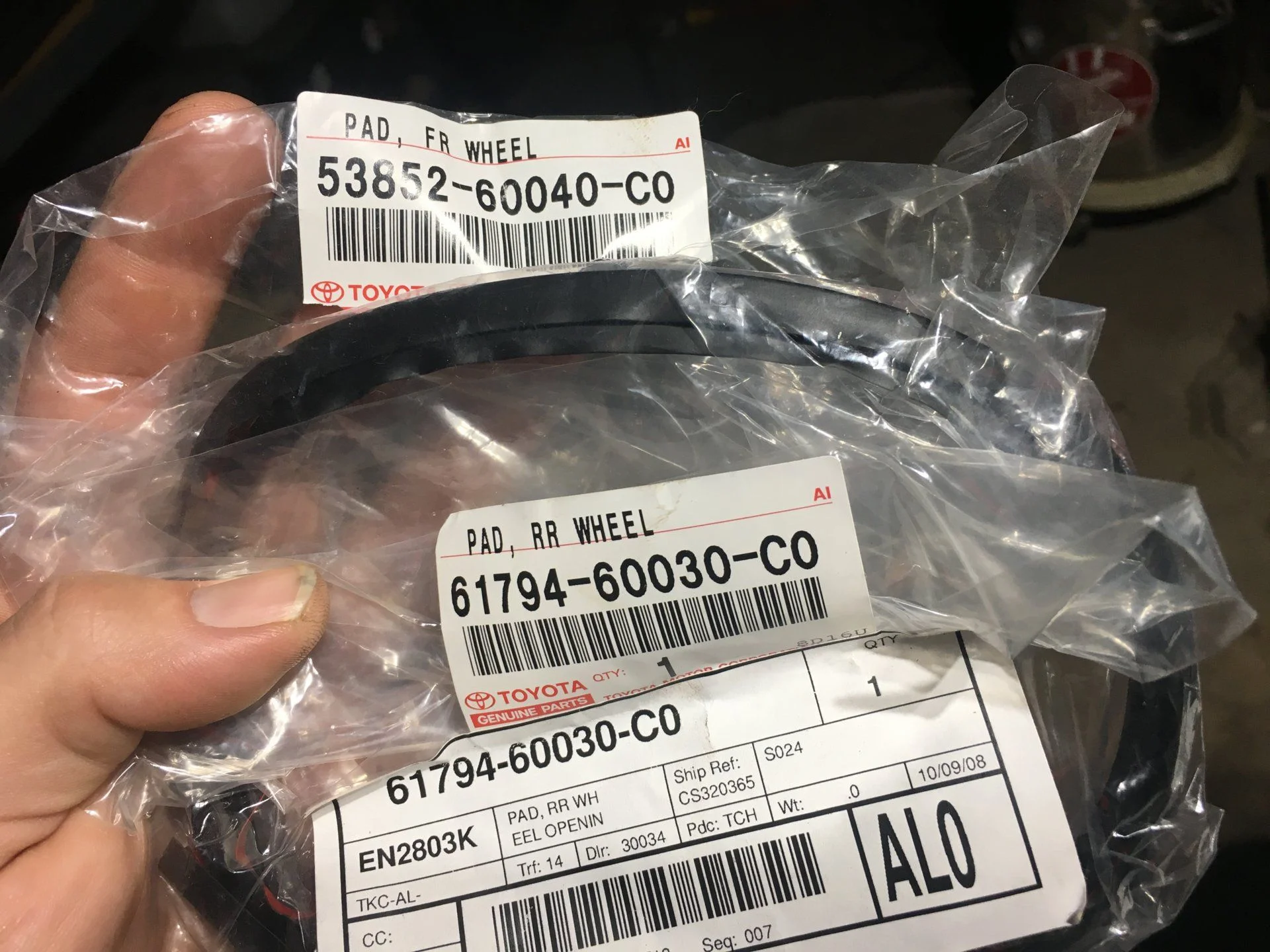

Wow. Look at what youve done now drawing the man out of hiding :D
Here are the gaskets. Ive got some research to do. I just cut open the bag but seems i only have 5 instead of six sections. Guessing i cant return these to Dan now lol. Hmmm
